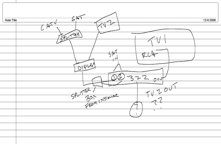

ok I couldn't wait till tomorrow so I tried it out and ended up fubaring everything. Here is a pic of how I have everything now, I have a tablet so hope you can read my writing... and 2 minute scribble. feel free to tell me how bad i screwed up and what needs added where.
heh... good try. let me work on something for you.

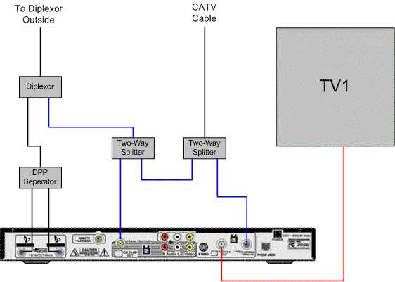

This diagram requires a seperate CATV line coming in to the room of the 322 but this would work.

yes, as long as you have 2 drops in your room with the 322, one for satellite, one for cable.
if you don't have 2 drops I highly recommend that you get a seperate outlet for the cable line. otherwise you will suffer a massive amount of signal loss due to the splitters and diplexors. each splitter and diplexor causes some signal loss. if you have a good cable signal coming in to the house you probably will not notice any problems.

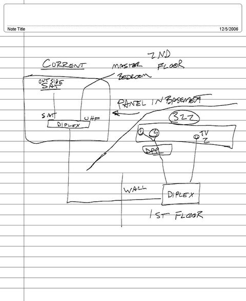

Here is a little better picture of how the installer did it, I finally got it figured back out...

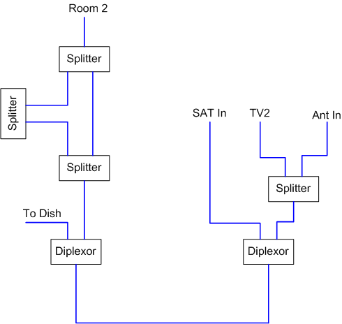

That looks correct for the current setup. If you want just one room to have locals you could hook up a splitter between the 2nd bedroom and the diplexor in the basement and hook the catv and the TV2 output on the diplexor to that switch then hook it up to the cable already going to the 2nd room. For both to have cable I'm not sure how that would be implemented. It would take some testing. possible having 2 splitters at the basement diplexor. one splitter to send the catv signal to the living room and one to send the catv signal and tv2 signal to the 2nd room. and hook up a cable between the two splitters to keep the tv2 signal going. However, I'm not sure if this would work. I will have to sketch this out on my white board here at work.
Here is what I came up. This is extremely suseptable to intermod so I don't know if this would work 100%. Try it out if you have the splitters. You might be able to get some free splitters from the cable co.
i'll have to try that... one TV (TV2/bedroom) is the only one I'm really concerned about getting the catv on. last night i was playing around and managed to get catv up there, but lost the sat, tried playing with the modulator switching between air and cable, probably just did it wrong. I'll try your diagram!!
