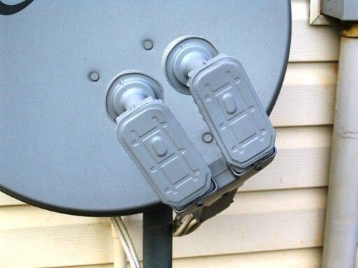

To use a legacy lnb on any of the plastic Dish Network "D" tube lnb mounts, you need to sand or grind away the 1/4 x3/8 inch lug at the bottom, so that it is flush with the floor.
Here is a photo of my Dish500 with two used DirecTV lnb's. The mounting is very stable.
Wow, that will do trick.
No reason for me to waste the DiSH 500 and the skew device just to receive one bird.
