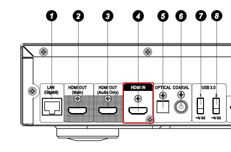

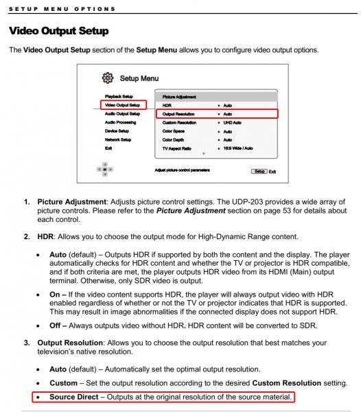

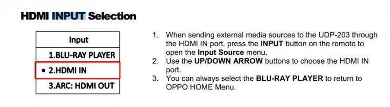

I recently installed a Sony VPL-VW 385 ES home theater projector & I decided to give Dish Network's 4K receiver, the Hopper 3, a try. As our theater is located some distance away from where the H3 is located I wasn't sure how our 50' long older HDMI cable would work. We rarely watch Dish Net in the theater so this hasn't been a big concern until now. Our HDMI splitter is 4K compatible so I thought I'd gave it a try. The setup is to use the Oppo's 203 UHD Blu-ray player's HDMI Input, then switch input source accordingly.

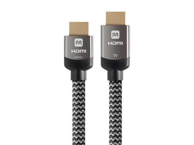

This week I ordered the 50' version of Monoprice Active HDMI to replace the older HDMI & waited for the next 4K game broadcast. This time there was no problem with the Sony 385 accepting Dish HD, passing it with the same YCbCr 4,4,4, 1920x1080@30Hz. With 4K, however, it took awhile as it did with HD & the older HDMI but eventually worked. The Sony 385's menu read the signal as YCbCr 4,4,4, 3840x2160@30Hz, RGB. The picture viewed as 102" diagonal was fantastic. Our 55" 4K Samsung reads that same signal as 3840x2160@60Hz. And, this time I recorded the 4K game on the H3's DVR. When playback of the recording the 385 reads YCbCr 4,4,4, 3840x2160@30Hz, BT.709. Why BT.709 for the recording & RGB for the live broadcast I haven't a clue.

Yes, but I understood that to be normal. Putting 4K into the projector over longer than normal cables is what I believe to be the main reason it takes about 90 seconds to fully lock picture & sound. Total length of HDMI from H3 (upstairs) to the input of the UHD Blu-ray player (basement) is 50'. Then from the UHD player to the projector is another 25'. That's a long ways so I expected 4K to be far different than HD which only takes a few seconds to lock in. Probably fiber optic cable would be better but at 5x the co$t!
I'm not complaining at all. I just wanted to point out my experience in case someone else was about to try something like this.
When I first tried the projector with the original HDMI cable (25') feeding 4K from the UHD BR player (Oppo 203) it took quite awhile before it worked & then it wasn't HDR BT.2020 as it should but BT.709. Bringing the player within 6' & using the player's HDMI supplied cable worked flawlessly. Sony said I needed "Active" type HDMI cables. Once the Active HDMI was installed all was fine.
