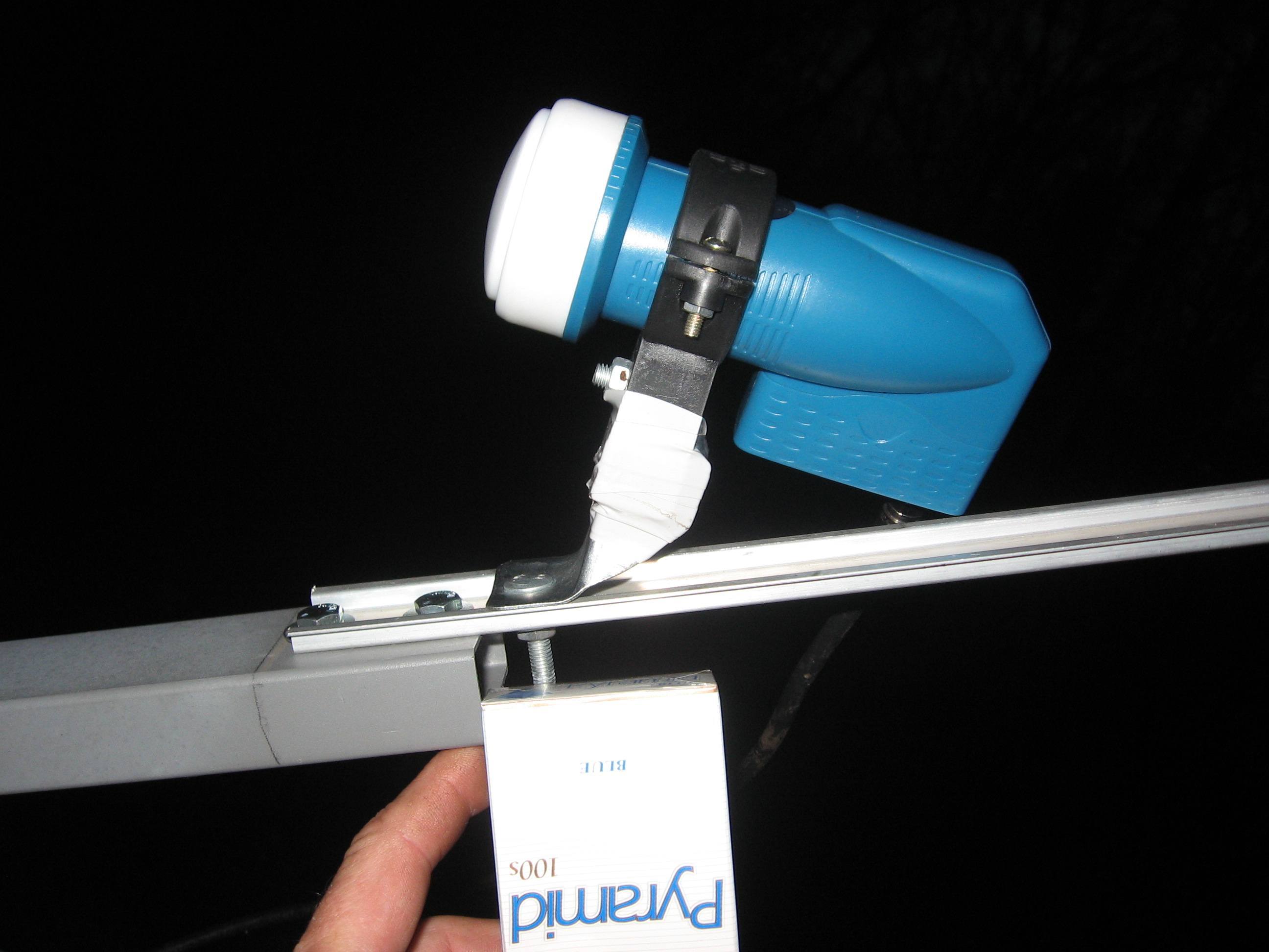

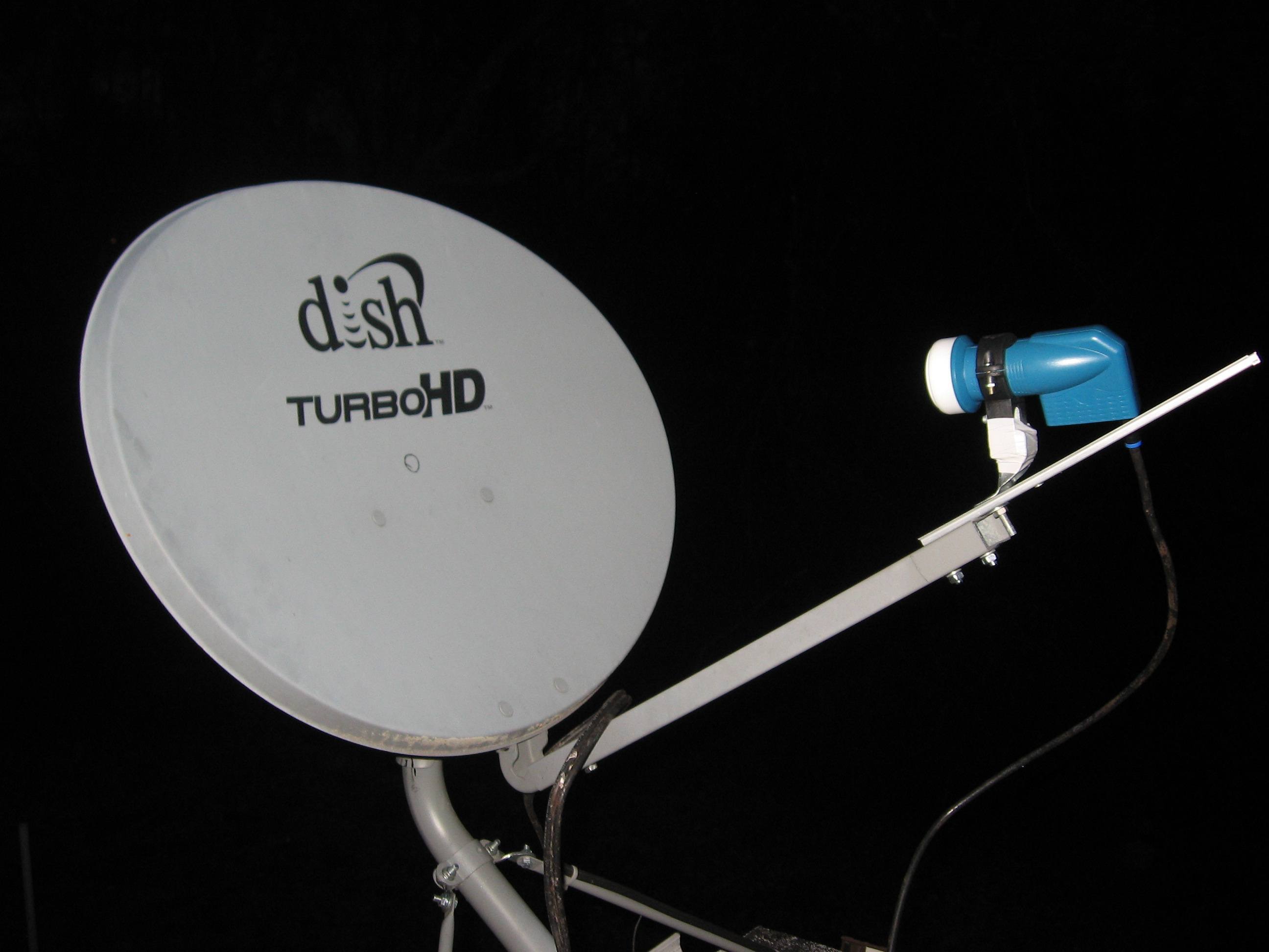

Yes it is posssible, but remember the bigger the dish the stronger the signal.
The smaller dishes are designed to receive KU signals.
I used a new $12 LNBF and I had to extend the LNBF arm to get max signal.
This dish is stationary and is pointed at 97W, only 1 satellite. This dish would be to small to put on a motor.
View attachment 80609View attachment 80610
