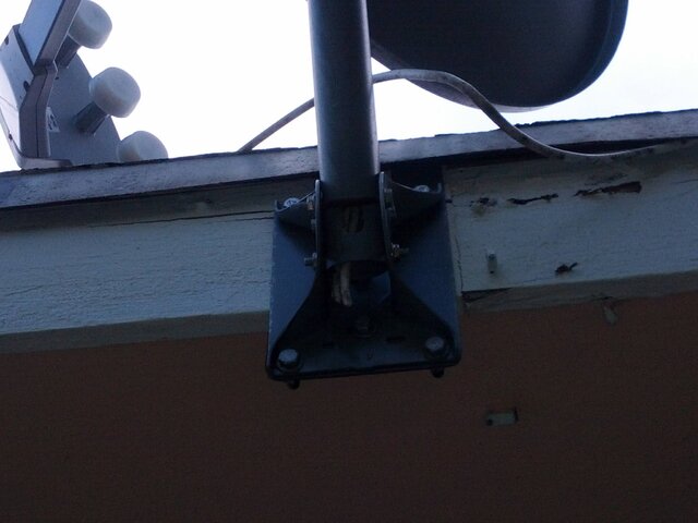

The dish has two cables coming out of it and those have been snipped at the base of the satellite. There are two cable holes going into the wall of our house where I assume those two cables ran inside. I have no clue how it was setup previously.
We want to setup just one receiver, the 211K. I know the 211K only has one input coaxial so I'm curious if something is missing or we only need to connect just one of those cables...

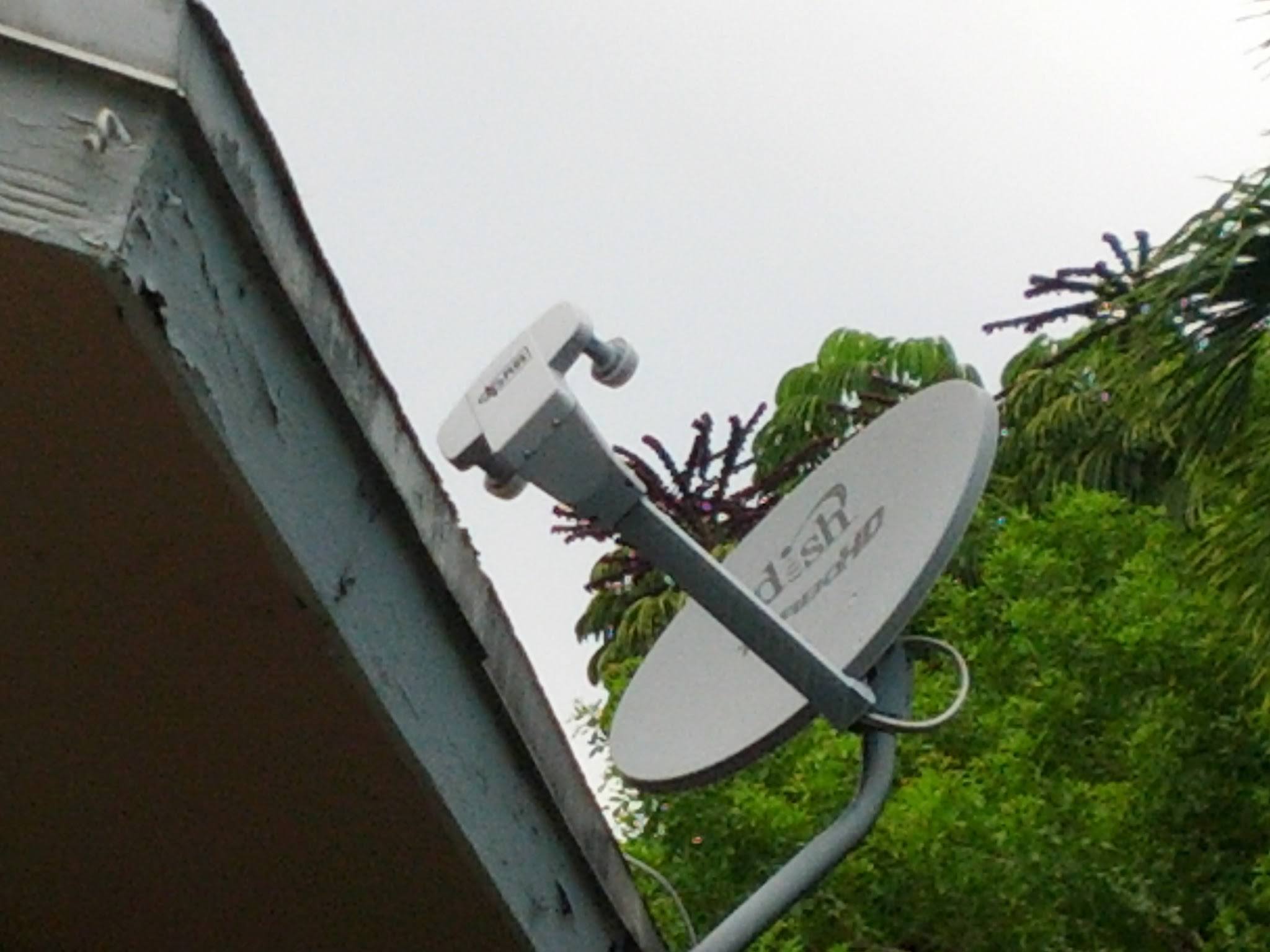

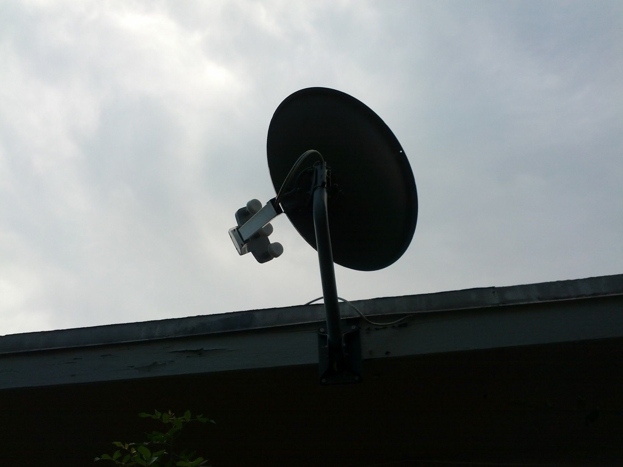

It only says TurboHD. Photo attached.
Thats a Dish 1000.2 so you should be fine
Hook up a cable from the dish to the 211k and run the check switch. It should find 110,119 & 129.

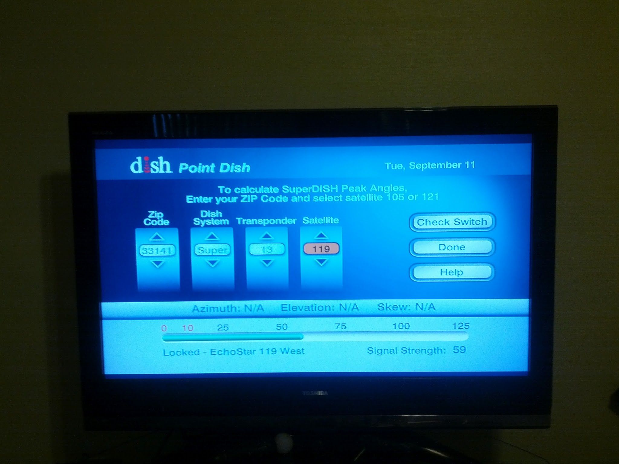

if it is out of whack all you would need to do is turn it left or right to get the best signal.
Signals on 110 & 119 should be in the 60's to low 70's
129 should be 50's to 60's

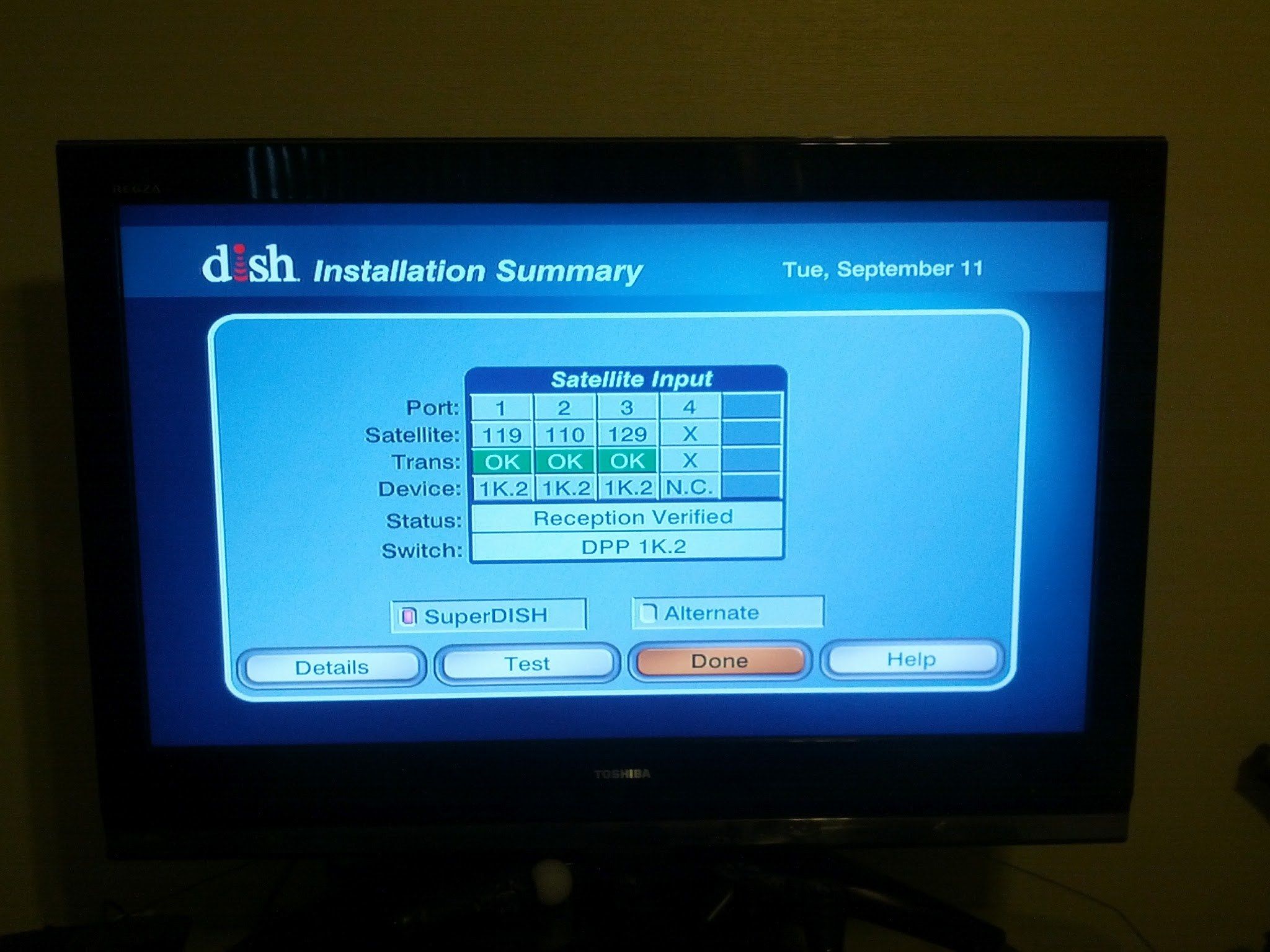

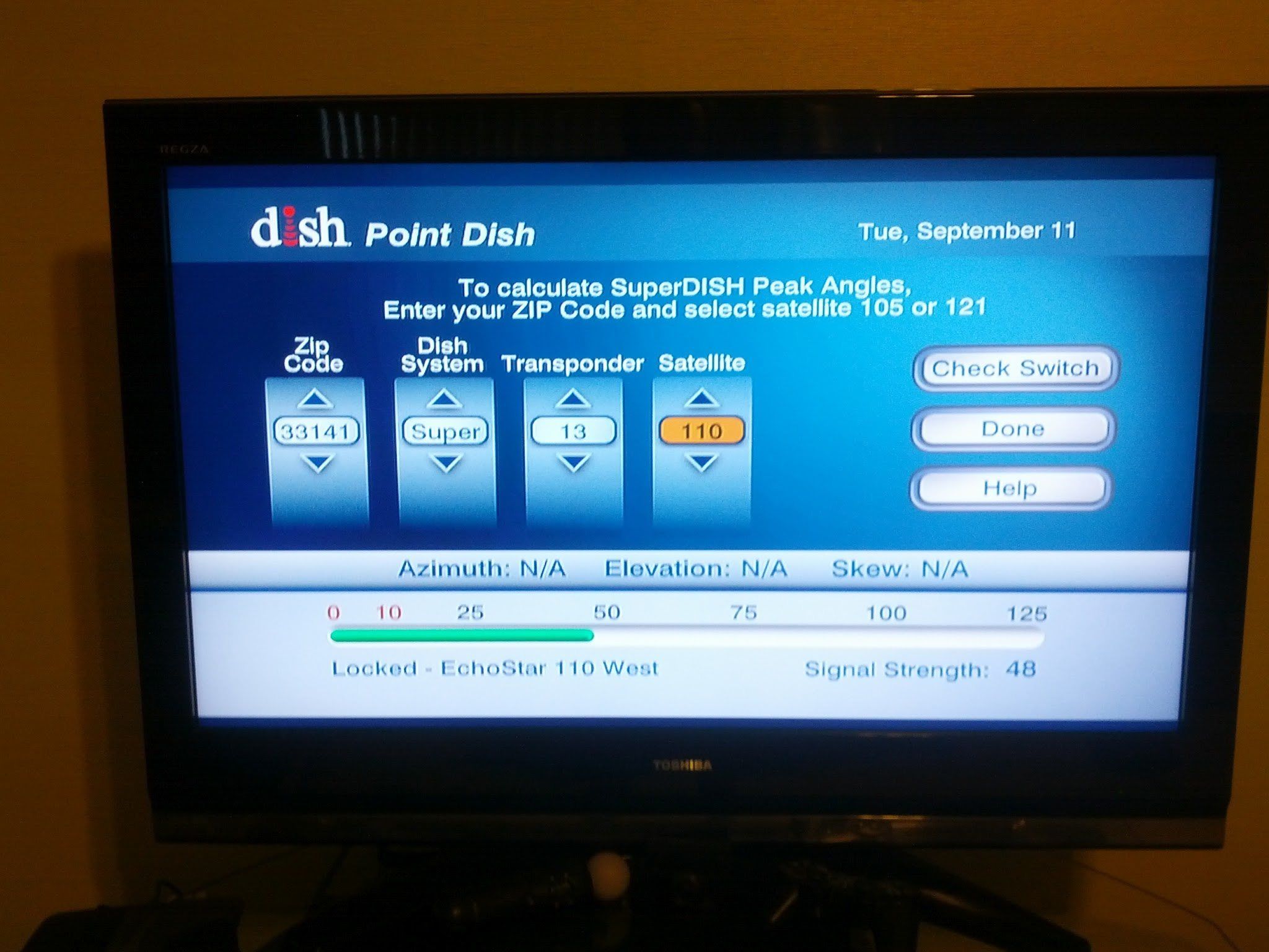

Finally bought a ladder, crimper, etc. and got the stuff setup.

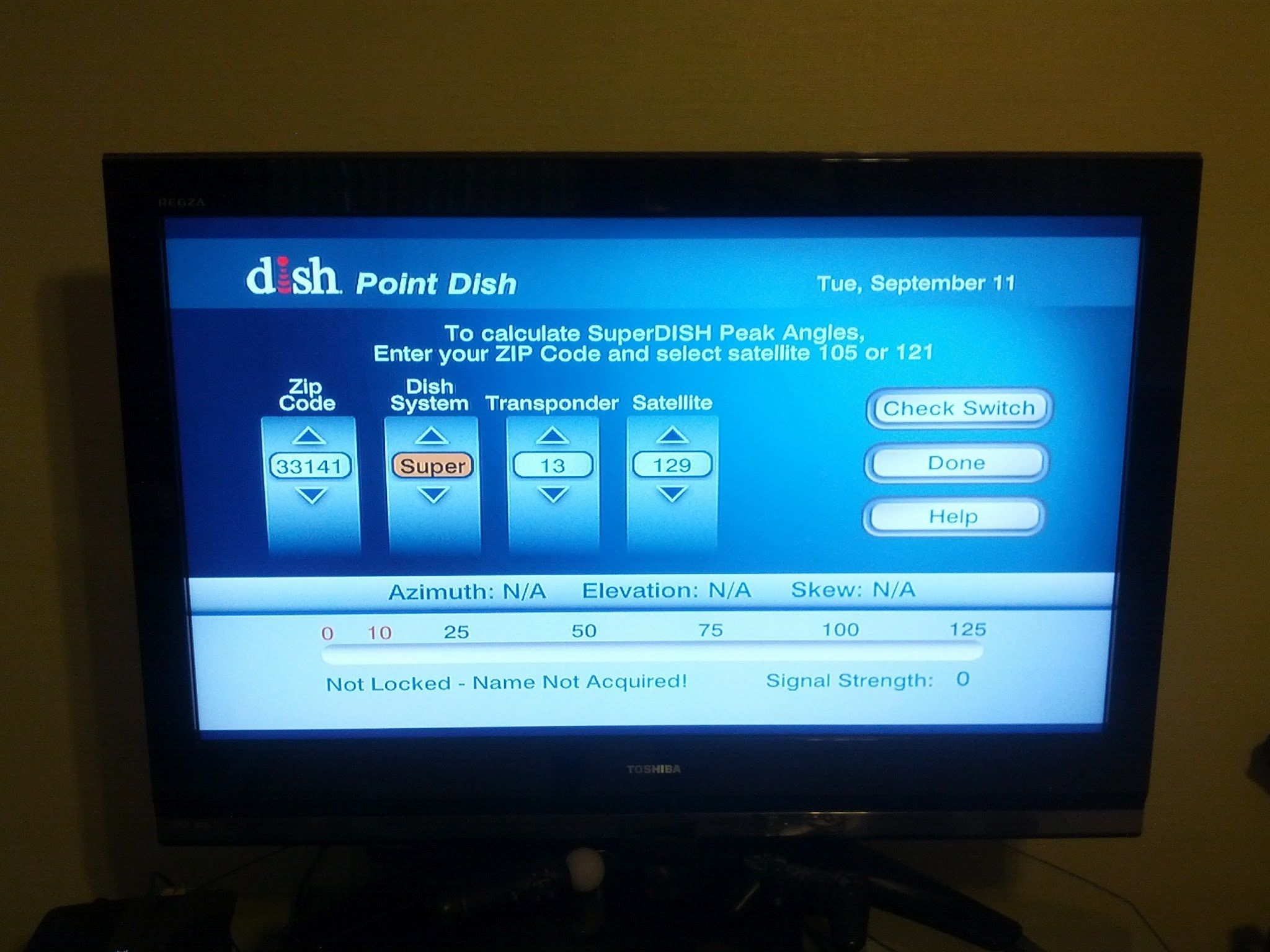

For Southern Florida, I'm receiving responses on Sat 110 and 119. However, 129 is not coming through on the Point Dish screen.
The Check Switch tests 1 to 4 complete and display the following:
After it downloaded the guide, it seems to be operating just fine.
Should I do anything at this point? Move the dish to get better levels or anything?
EDIT: I assume that Satellite 129 would carry some SD channels like ESPN1 and ESPN2. Those wouldn't come in at all and I receive a message stating total signal loss. The HD channels are present, though.
Actually, it now shows 129 coming through with the same/similar strength as the other satellites. But, I'm still receiving a total loss of signal error on ESPN SD channels. I prefer HD anyway, but still that's curious to me.
