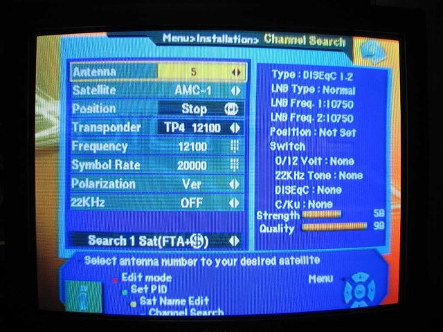

I am getting a Strength 58 / Quality 98 with my 1m dish on the Pentagon Channel. It was one of the trickier satellites to set my motor up to as it did require some very fine adjustments.
With Digiwave/Kusat almost anything will give you 98 quality no matter how bad or good you are aiming it so do not be amazed if it requires even more fine adjustments when it's rain.
The Pentagon Channel for me is around 45-60% but took while get it that way.
RtpiFan :)
