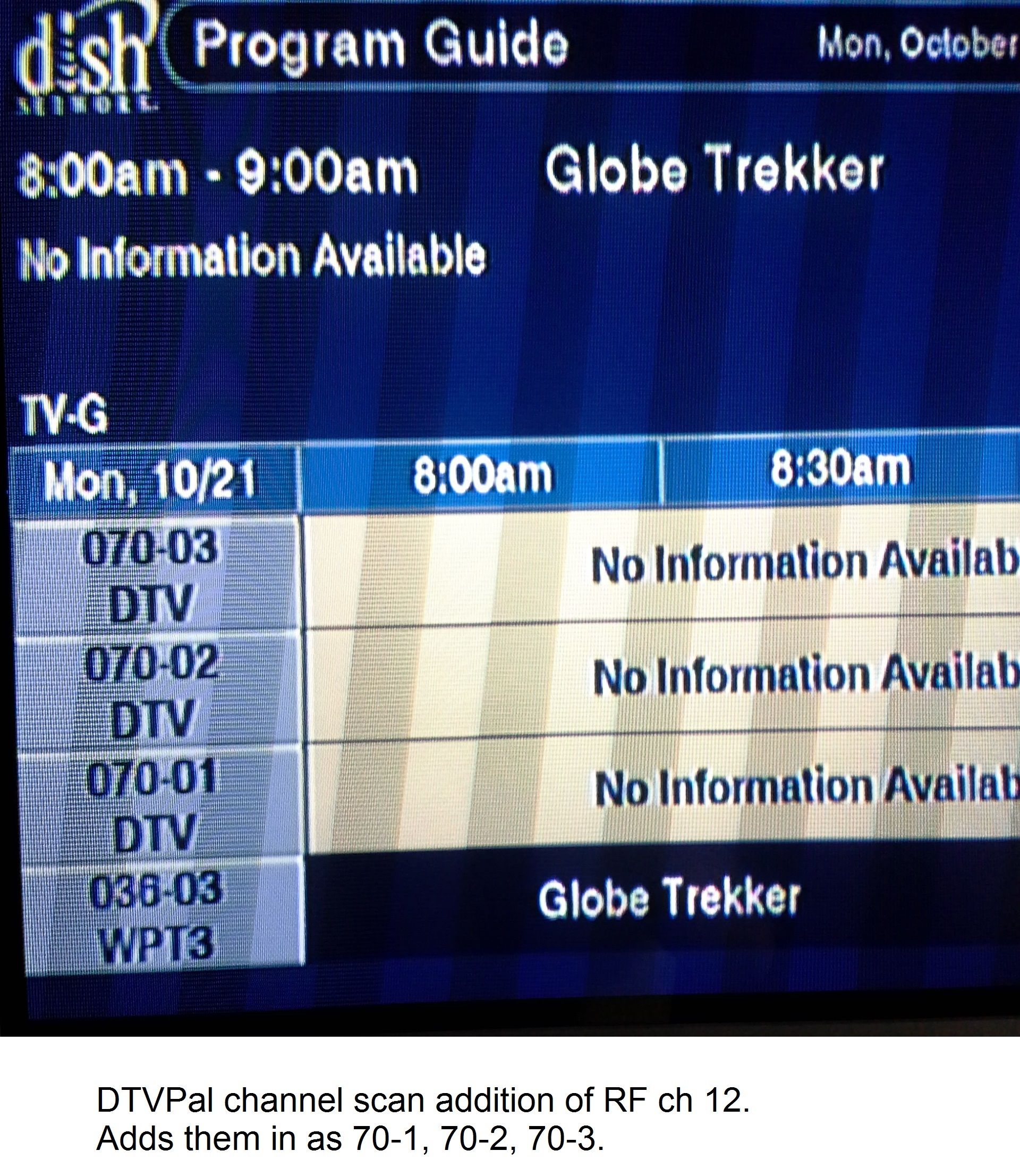

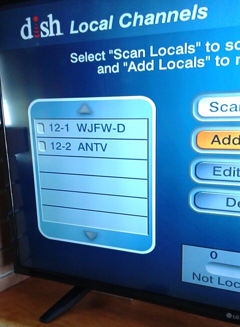

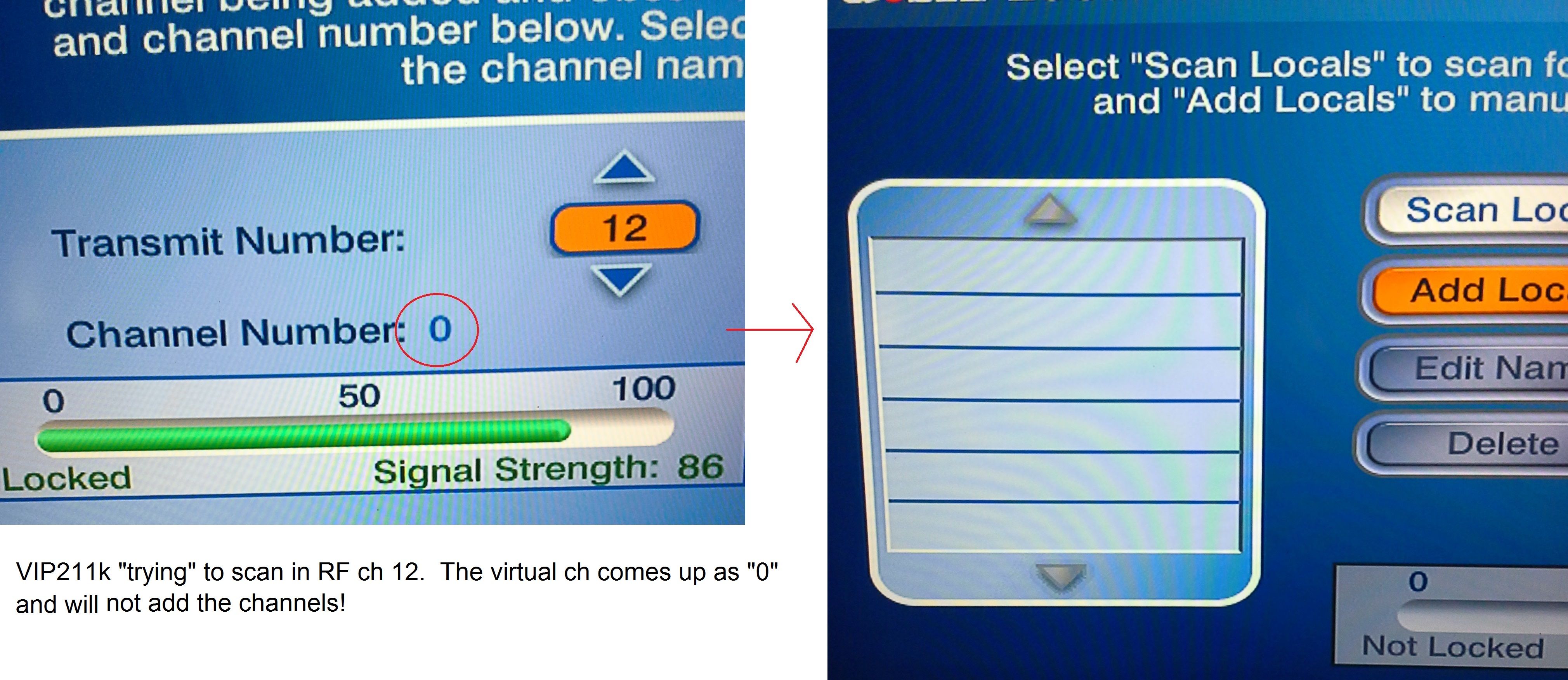

I am trying to scan in OTA RF channel 12, WMOW - Crandon, WI. WMOW transmits 1 main channel and 2 subchannels (3 total).

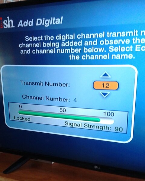

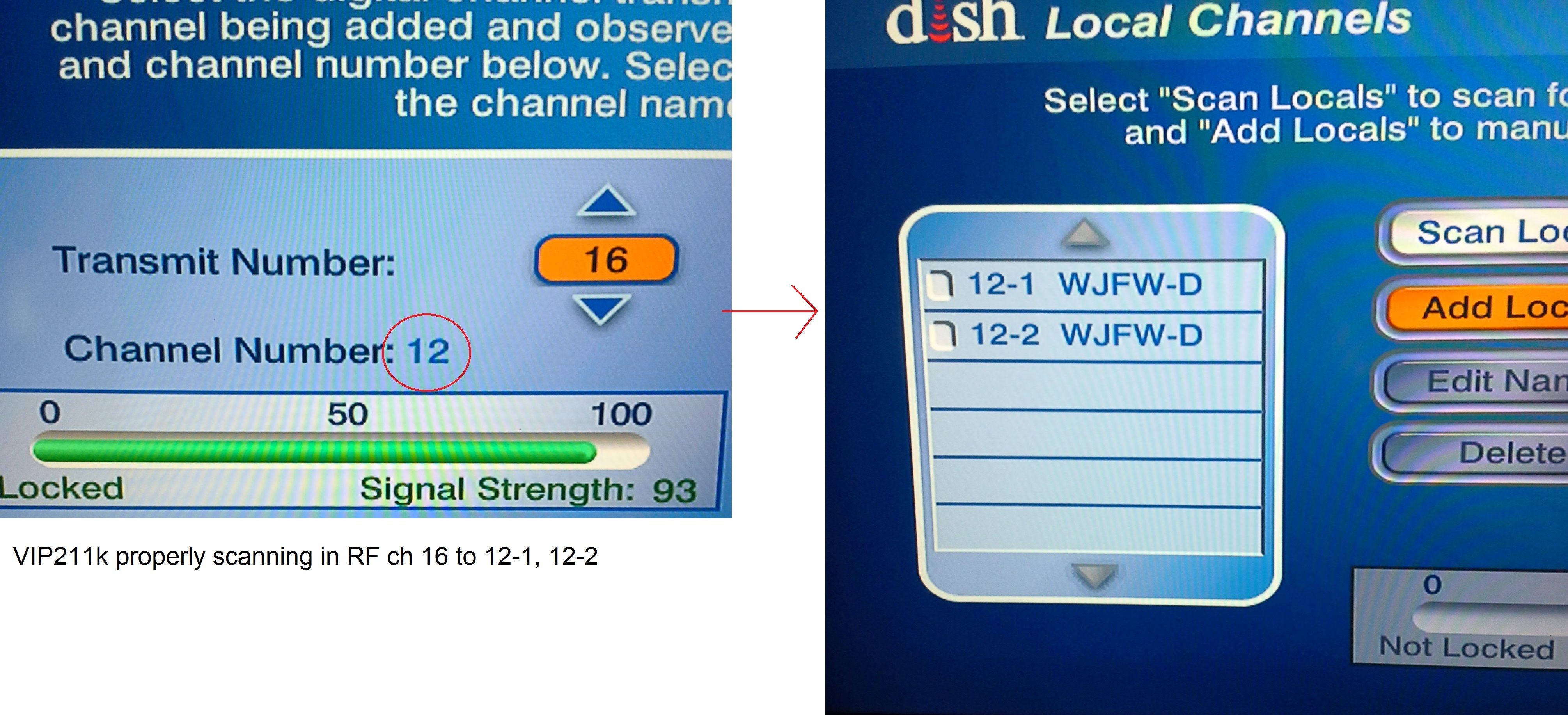

When I try to manually add RF ch 12 on the 211k it comes in as ch "0" and will not add the channels to the guide so they can be viewed.

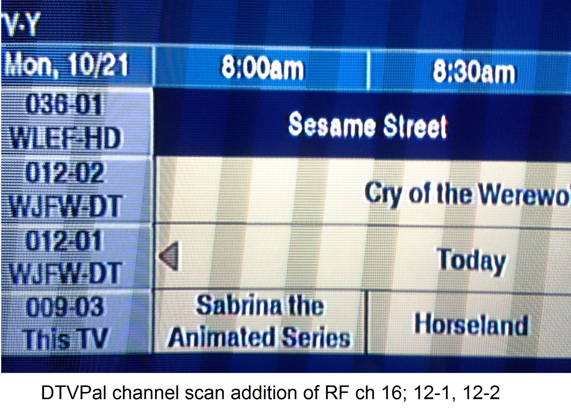

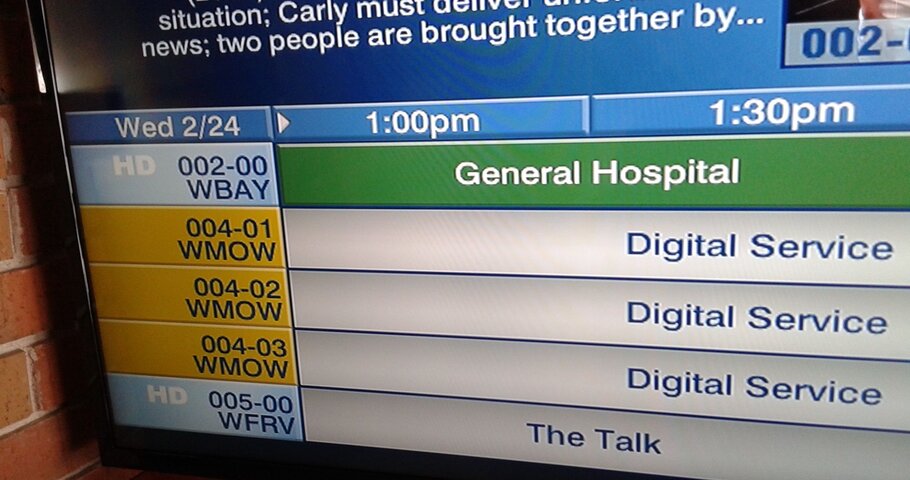

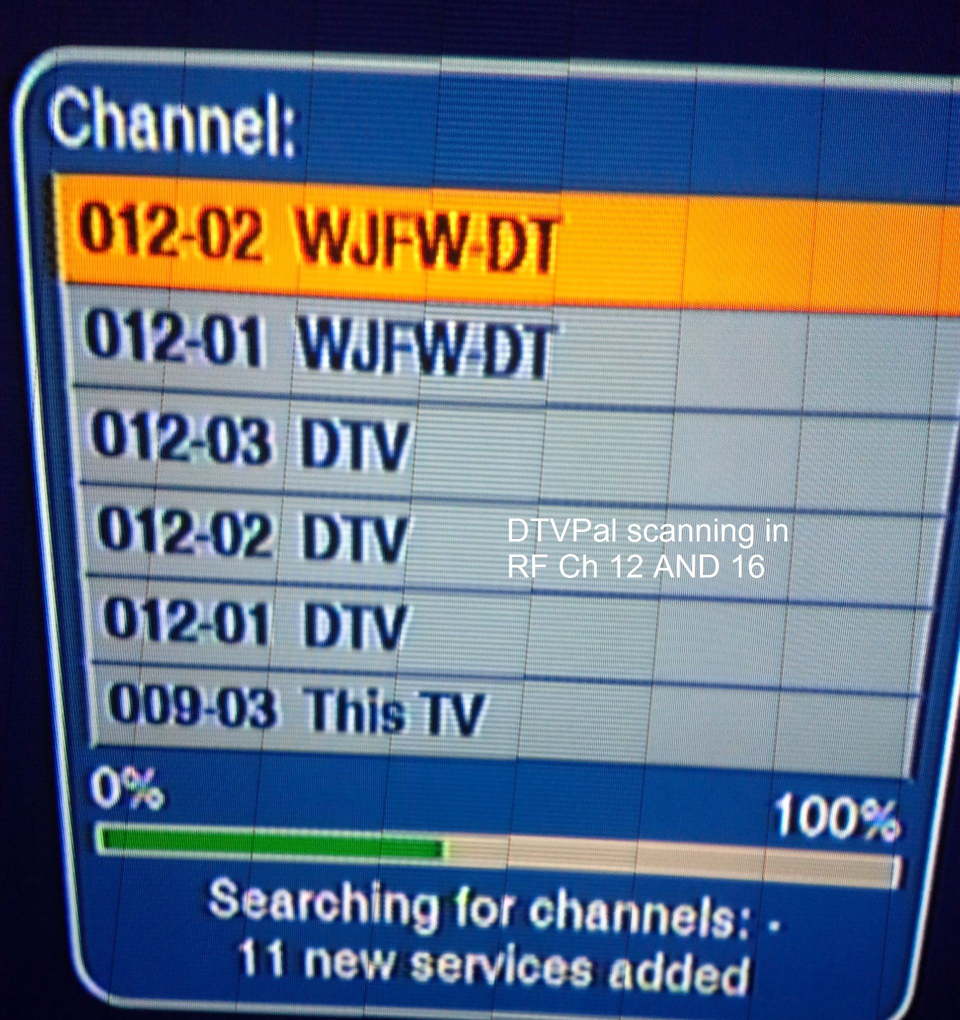

When I try the scan with a DTVPal they initially come in as 12-1, 12-2, 12-3 but then in the guide get added in as 70-1, 70-2, 70-3. (See attached pics).
This appears to be a glitch in the 211k.

So, are these channels actually broadcast on 12, 16, or 70? It looks like 16. When you try to manually add channel 70, what do you get?
The 211k will not let you do a manual scan of channel 70, only goes to 69. RF ch 70 is out of the TV broadcast range (2-69, now 2-51).
It's strange that the DTVPal adds a channel in as channel "70". RF TV channel 70 has not been in use for TV broadcasts since the early 1980's before cellular 824-849, 869-894 took over TV RF channels 70-83.
WMOW is broadcast on RF channel 12

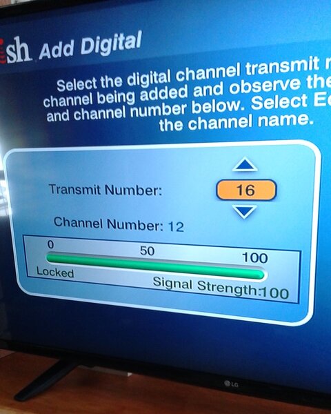

WJFW is broadcast on RF Channel 16
WJFW used to be RF channel 12 before with digital switch, that is why it comes up as virtual 12-1, 12-2.
On the Zenith DTT901 digital converter box it scans RF channel 16 (WJFW) as 12-1, 12-2 (Same as DTVPal)
and RF channel 12 (WMOW) as 12-3, 12-4, 12-5 (Not 70-1, 70-2, 70-3 like DTVPal)

I tried the scan with my Hauppauge USB ATSC/8VSB TV Tuner and I got:
12.1 WJFW-DT RF Channel 16
12.2 WJFW-DT RF Channel 16
4.1 WMOW-CW RF Channel 12
4.2 WMOW-DT RF Channel 12
4.3 THIS-TV RF Channel 12
So 4 different ATSC OTA digital tuners (211k, DTVPal, DTT901, and Hauppauge) and 4 different results.

I have a Winegard HD7698P connected to the 8VSB port on my 211k, so yes the HD7698P covers VHF RF channel 12. I am getting a signal strength of 86 from VHF RF channel 12 (see pictures above).

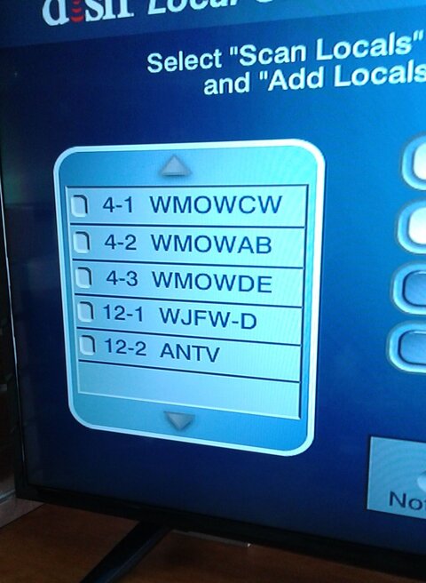

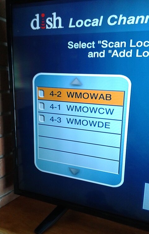

This problem is now FIXED!!!
When performing a channel scan the WMOW channels now scan in with virtual channel 4 and load into the receiver properly.
I am not sure if this was fixed on Dishnetwork's end or the OTA broadcasters end, it would be interesting to know what the problem was.
Either way, it is FINALLY fixed and I am happy...

sounds like Quincy (owner of WMOW) finally got the PSIP fixed to map the channels to 4-X instead of their RF station of 12-X
