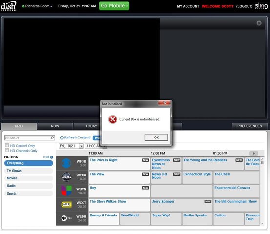

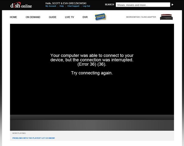

When DISH use to have DISH Remote Access I use to be able to watch live TV from home almost every time I tried to connect. However since they moved over to DISHOnline I fail to connect over 99% of the time.

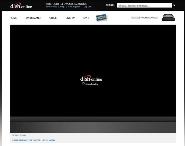

On my 722 in my son's room I have a Slingbox Pro hooked up to it. It is married to my receiver so I can watch it on the DISHOnline webside. But I can never connect to it through DISH Online, it just sits there and says loading, but it never loads. I can watch it however with my stand along Slingplayer software. I can also watch it fine at Slingbox.com, just can't watch it at DISHOnline.COM.

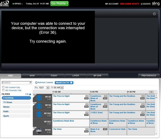

On my 722k and 922 it use to work, but over the past few months when I try to connect I always get an error 36. What good is it having a 922 or Sling Adapter if you can't watch it. What I find interesting is that the 722 Sling Adapter is showing up now in my Slingplayer software and on Slingbox.com, when I try connecting in the Slingplayer software it asks me for the password (which I don't know.) and if I try watching it on Slingbox.COM it tells me I need to watch it on DISHOnline.COM.
What is strange about all of this is I can watch them on my iPad, iphone and Android phone phone. So why can't I watch them on DISHOnline.COM?!
WHY ISNT THIS WORKING?

Scott, I have been having the exact same problem for months now. I cannot connect to my sling player at home on my internal network. I always get error 36, or error 2. However, I CAN always connect with my iPhone (on the first try) on my internal network using the exact same router and modem. Also, I CAN always connect externally using my iPhone when I am away from home.
I started a thread about this about four months ago and despite the best efforts of TG2, pabeater, and others, we never could figure out why sling never works internally on my home network. Here is the thread:

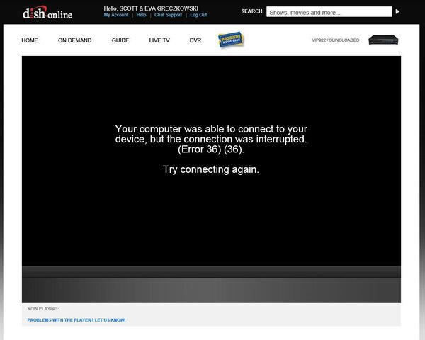

I tried the DRA website (which I didn't know was still online) and I get the same things..
Yet the DRA apps on my iPhone/iPad/ Android Phone all work fine... Its not a configuration error on my end.
It never has been on our end.....from the beginning with few exceptions this was a engineering/software problem with the marriage of Dish/Sling.
I just wish Dish would spit it out...come clean about the issues so many have experienced...or maybe it is just to complex to work correctly for all devices, etc. under the current system...
