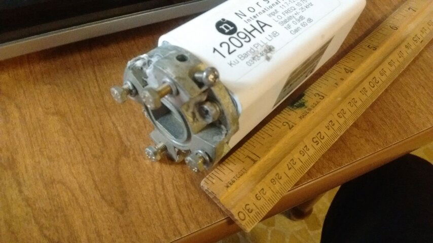

In my haste I did not install the spacer when changing out a KU LNB. I replaced a 1209HA Norsat LNB with an Primestar single on a 6' Channel Master solid dish.
I am receiving Cozi at 103W fine with a 16 db SNR?
The spacer is about 1/2" and is shaped as you see in the picture.
I am keeping it just in case I need it someday.

By spacer, you mean the silver colored piece with the screws?
If so, that part allow skew adjustment IIRR. Maybe the primestar has a 'different looking' skew adapter?

Ya the silver part. I can turn the whole LNB and feedhorn at the black ring that hold it onto the dish.
I need to see what a Primestar LNB looks like where it attaches to the feedhorn.
Maybe this is just spacer and I might be more turned if I placed it in there?
I should be it back so it does not get lost and for the sake of testing.
I've only seen those 'spacers' on the elliptical primestar dishes. Can't rotate that feed, it's bolted solid. Only way to skew is the LNB on the feed.
Your feed doesn't need it as the feed will skew in its holder,

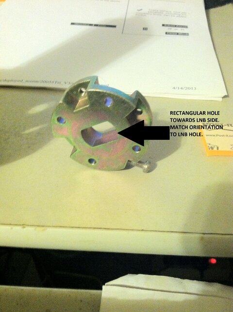

Yes you need the "spacer". Its a waveguide polarizer. Its job is to convert the circular polarized rf from the feedhorn to the linear polarized rf needed by the lnb. It will probably give you 2-3db of signal back.
It goes on only in one direction. The circular hole goes toward the feedhorn & the rectangular hole goes toward the lnb.
Was there something wrong with the Norsat LNB? I really don't think the Primestar LNB is a better choice than the high dollar Norsat PLL unless you have an issue with powering the LNB.
ken2400 an addition to my post above. I'm assuming the hole on the back side (away from the dish) of the CM feedhorn is round. If it isn't then you don't need the polarizer.
The 2 pics (its a prodelin polarizer but that doesn't matter) show better what I meant about which side goes towards the lnb etc.
If its working ok now you can get away with leaving it off ..... if its a long drive back to re-install it etc. But if you are in the area I would recommend putting it back on. As you know with ku signals they are subject to rain fade etc. I'd want every db of signal I could get so it might be worth the 2-3db to put it back on.
Ya I will get it back on. The next time I get up there and note the difference in SNR. Thanks for the pics.
