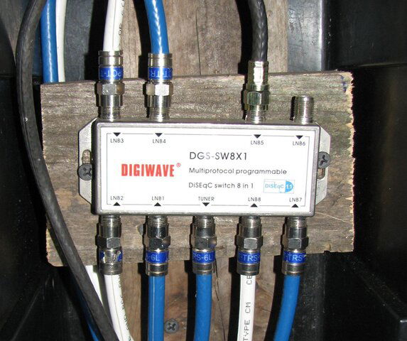

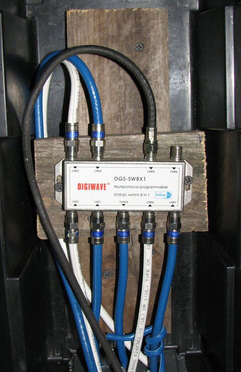

I have one of these Digiwave 8 way switches and it works just fine for me on a home theater pc. I have 7 dishes hooked up to it at the moment.
I can verify that it's Ijjit proof. :)
