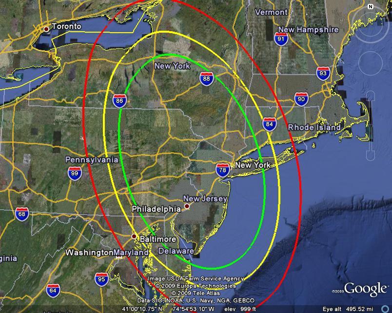

Looked at the map & Delaware is in the green & yellow circle, Does that mean it will cover me?? Any help would be good... I know on Directv it works but what about Dish?
you asked the same thing 3 months ago....nothing has changed really
http://www.satelliteguys.us/threads/293343-Question-about-quot-MOVING-quot?p=2988631
The maps for 61.5 are wrong.....as noted 3 months ago.
The reason Directv can give you NY locals is they are CONUS (whole US...just like cable channels) whereas Dish's versions are on spotbeam. Directv can still do distants rather easily. Dish not so much
Now while Dish is slowly moving channels from the "old" 61.5 to the "new" the maps are pretty much the same (although corrected)
The same transponder that is used for NY locals is also used for Norfolk, DC, Philly althogh different spotbeam

Please keep in mind that the spotbeams on 61.5 are changing with the move from E12 to E16. They will cover a much smaller area than the beams on E12.
