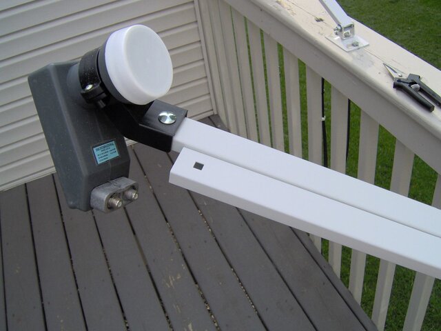

Here is the arm length difference between a 80cm and 90cm (the 90cm has the LNB on it)

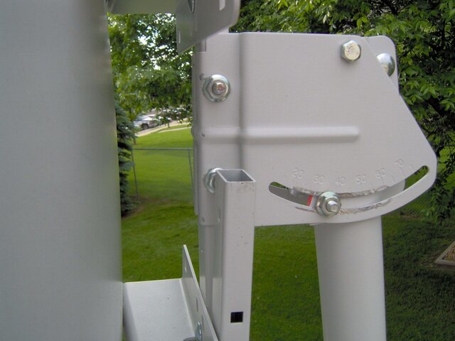

and the difference in the arm for mounting
