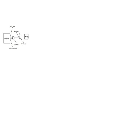

THE EXTENDED ANTENNA TRICK
If you have a direct coaxial backfeed for TV2 from the reciever
(you will need 2 splitters for this trick)
Splitter 1
-put a two way splitter in the TV2 line behind the reciever with one output of the splitter going to the reciever where TV2 line was
-Remove the antenna from back of reciever and attach coaxial from where the antenna was to the other splitter output
-attach the TV2 line that was hooked to the receiver to the splitters input
Splitter 2
-in the room with TV2 you will put a two way splitter in the line behind the TV
-the input of the splitter will go to the TV
-one output you will screw the antenna onto
-the other output will have the line coming from the reciever(input of splitter behind reciever) going into it.
This also works if your using a diplexer for TV2 as well only the Input of the splitter behind the reciever will go to the VHF/UHF side of the diplexer
