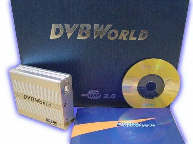

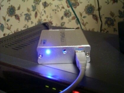

WOW!
I hate to start a review with the word WOW! But its the only word that sums up this wee box
I FINALLY got round to installing it (Took 2 minutes) after having it sitting here for MANY months, I deeply regret now not installing it sooner.
I watched the Super Bowl yesterday and recorded The Rolling Stones to test out the recording (MPEG2) to Hard Drive feature. Very easy just click on RECORD and it starts, then playback is a breeze and you can FF. RW. and pause. A really NEAT feature is the "Time Shift" much like a Tivo you can pause live TV then start again whenever you are ready! Then again you can FF. etc. through the recording, this will be a sweet feature when we get into the summer Rock concert season, it will also be nice for any sports that I want to record and keep.
So far I have only seen one High Definition broadcast (The State of the Union) and that was mind blowing so I can only guess what it will be like watching FTA HD of something I am interested in, again music or sports. I have installed a BUTTLOAD of HD systems for DirecTV but there is nothing like having a monitor right up against your face in HD.
Its also great now to be able to decode 4:2:2 broadcasts / feeds and of course it plays AC3 audio
Most fun I have had since the 40" C-Band escapade!
This will be more of a Review in progress as and when I find time to use this amazing product, I can see my receivers getting a lot less work in the future
(Will also add some screen shots......)
Really the only time now I will be using a receiver is for the Blind Scan feature!
