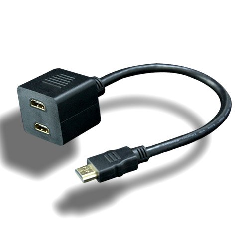

Tried a splitter like this:

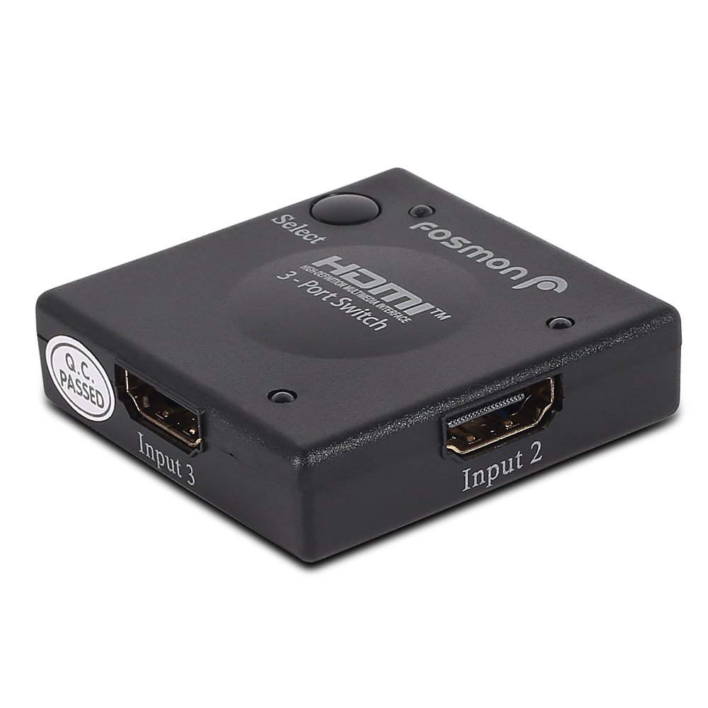

Then tried an HDMI switch like this:
This same switch had previously worked fine connecting an Xbox and Bluray to the primary TV.

It appears to me those are two into one, instead of what you want one into two. I don't know if they will work in reverse.

The switch I showed is backwards, multiple inputs to one HDMI feed, I want the opposite.

Using this splitter:
I was able to connect it between my PC and monitor. One of the two outputs provides both video and audio, the other neither. Hence it is likely defective. I should be able to do more tests in the morning with the second TV monitor.
Dish 612 does not like the Splitter
Using the PC's HDMI output and the passive splitter, I had no problem running either HDMI monitor or both at the same time.
Going back to the Dish 612, once and only once I saw the DVR splash screen and then was able to turn on the DVR and select local channels from the satellite. Cable channels gave me a notice that the system did not support high bandwidth signals. Except for this one time either HDMI TV said "No signal".
Clearly the Dish 612 does NOT like that splitter. Straight HDMI cables work fine with either TV.
