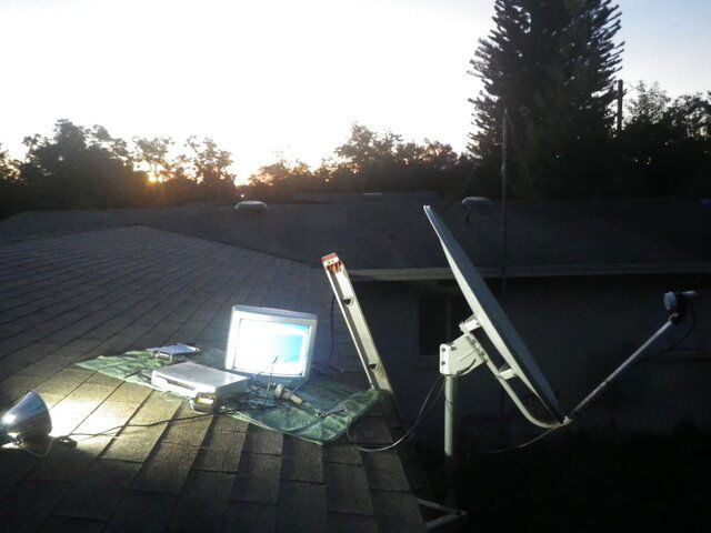

Hi all, got up early this morning and setup on the roof top to try and bring an old FTA dish back to life. Had a bad LNB (lightning) and installed a new universal LNB and got busy trying to find something. Was aiming for 87W and found something. Tried looking up on LyngSat but can't find a match. A blind scan came up with 6 channels - 5 Powerview and one called the DC channel. Active transponders my old DVB-S only receiver found were: 11776/V/5004, 11791/V/5004, 11757/H/3984, 11957/H/29281
Any idea where I'm at?
Thanks, Dale

Probably 87W.
You're on 87W SES2. Those are data transponders and the CNN mux including the DC Channel.

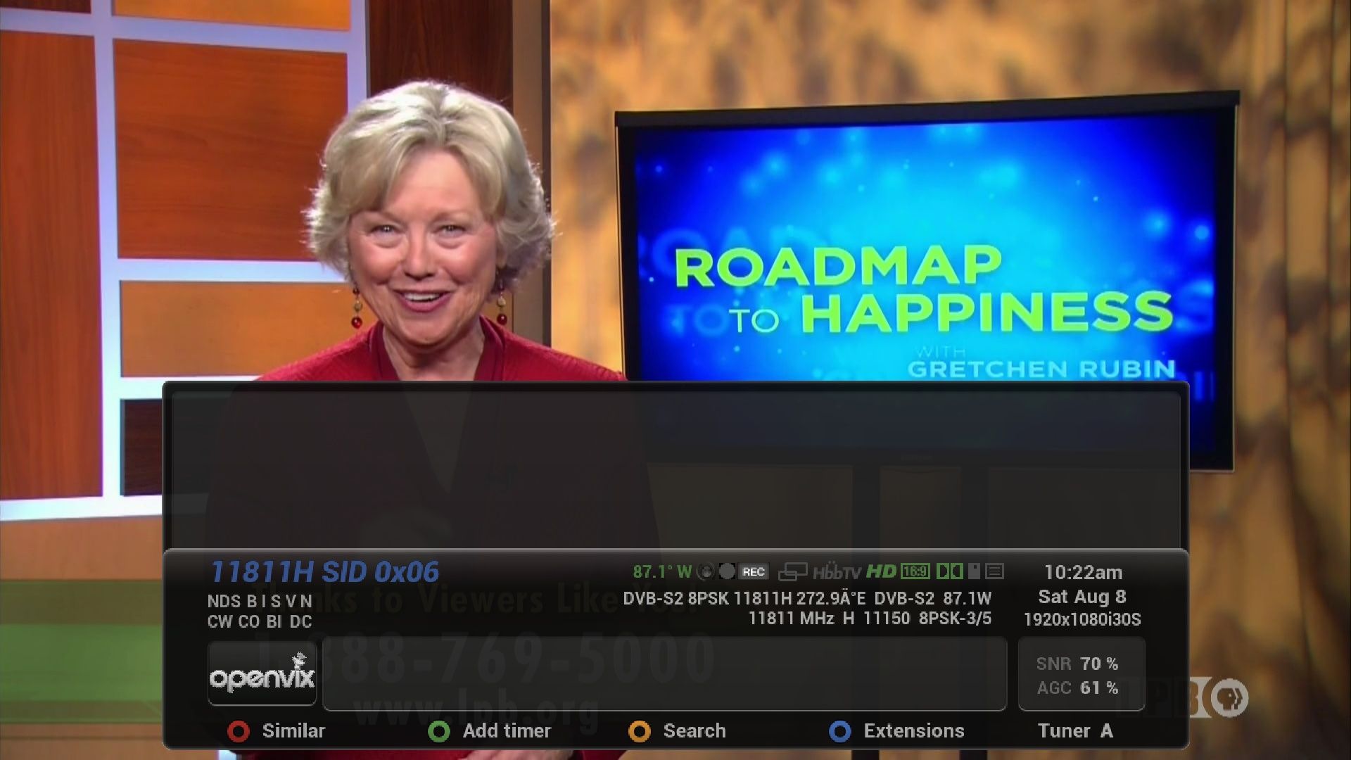

Patient Channel has an FEC of 7/8 so you need a higher C/N to lock it in. I find it doesn't always blind scan in. I agree that video on LPB is very good. So this is my PBS source since 125W is too low in the sky and tough to catch for me.
