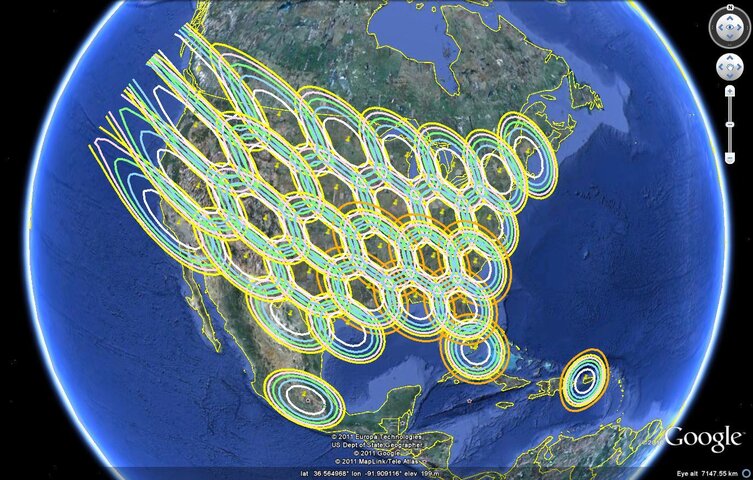

Major changes in the EX-5 BSS 17/24 Ghz design.
Previous design was a conventional Conus beam supplemented by a steerable spot for Mexico City.
New Design has a Conus North Beam (Eastern US), a Conus South Beam ( Southeast US), a Conus Beam (Continental US), and 30 spot beams steerable as a group. The spot beam group includes Mexico City and Puerto Rico.

All three Conus beams will operate simultaneously in the 17.3-17.7 Ghz band over twenty four, 26 Mhz channels or, the North and South Conus beams will opearte over six, 26 Mhz channels and each spot beam will use a 88 Mhz channel.
The Mexico City spot will use the 100 Mhz in the 17.7-17-8 Ghz range (US transmissions are prohibited in this range (reserved for fixed base operators in the US). Mexican transmissions are pending approval.

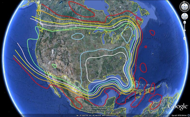

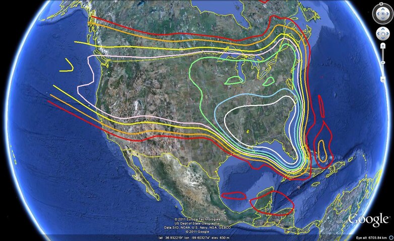

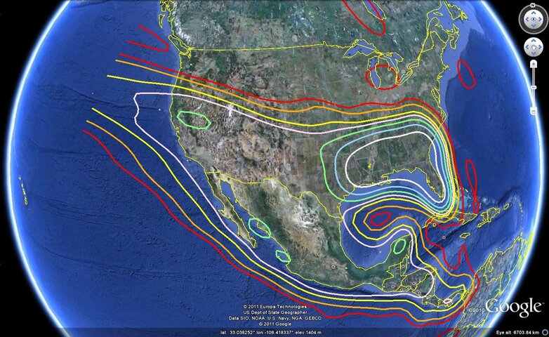

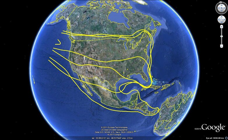

This satellite will use their existing uplink stations in the US. But, it also has antennas to receive uplinks from Mexico City and Puerto Rico. The Northern/Southern Conus/spot configuration covers all of Mexico The spot beam only covers the Mexico City area so whatever the use, it will be specific to that area. All dependent on Mexican authorizations . Adding to Dish Mexico??
Even though the satellite is capable of providing Mexico service, those features might never be used.

Based on the beam configuration specifically the south CONUS beam, the EX-5 satellite is designed also to be used at 77.2 W, another Dish BSS slot.
