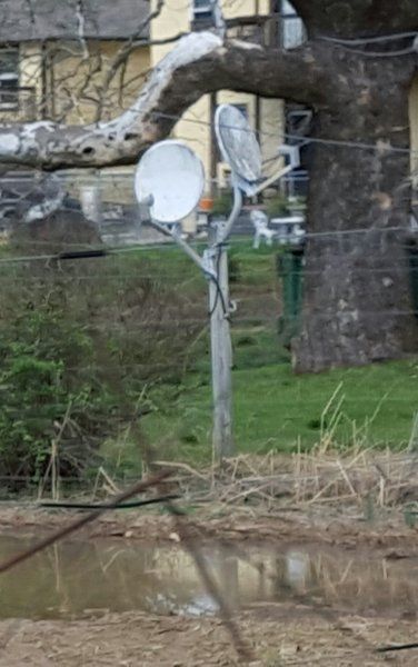

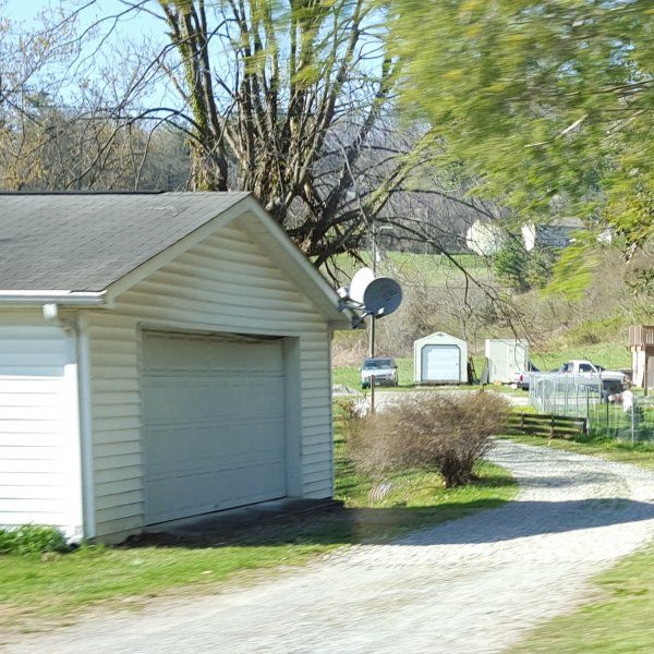

Also, what ever happened to the 148° W satellite? I understand it was somewhat of a sister satellite to 61.5 for the western half of the continental U.S.? I know someone who lives near a farm off a nearby highway that has two single-lnb dishes mounted to their fencepost (pictured), each facing 61.5 and 148, respectively. Why would they need two dishes looking at two satellites that are supposedly nearly identical?

Eastern arc is now 61.5 and 72.7 (77 is used for international programming via a wing dish)
Western arc is 110, 119, and 129
They use a single 1000.2 dish with either eastern or western arc lnbf
The current lnbf's are DPP(Dish Pro Plus) and DPH(Dish Pro Hybrid)

The Greek channels are now on 118.7. Most of the international channels have been moved there, with the exception of Mexico. The 61.5 satellite is still there and working fine but there is only so much room for all the channels, including local channels, on it so the internationals were moved off of it. The 148 satellite is long gone. It died and was sent into further space. Now, to your setup, you would need to see 110, 119, and 129 to get all of the channels for Roanoke including locals. You also need 118.7 to receive the Greek channels. So your best bet is to use a 1000+ antenna with the LNB that receives all of the satellites.
