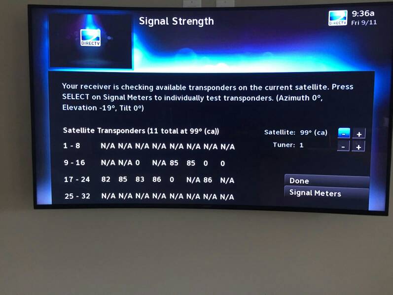

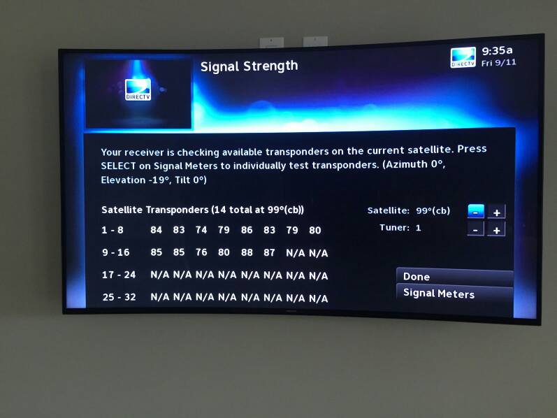

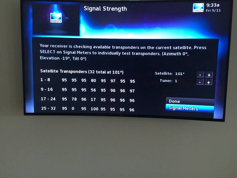

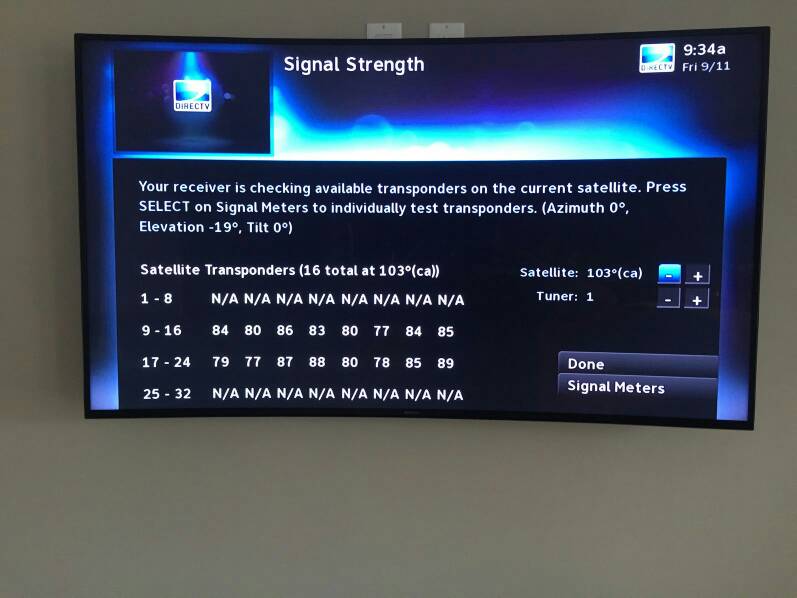

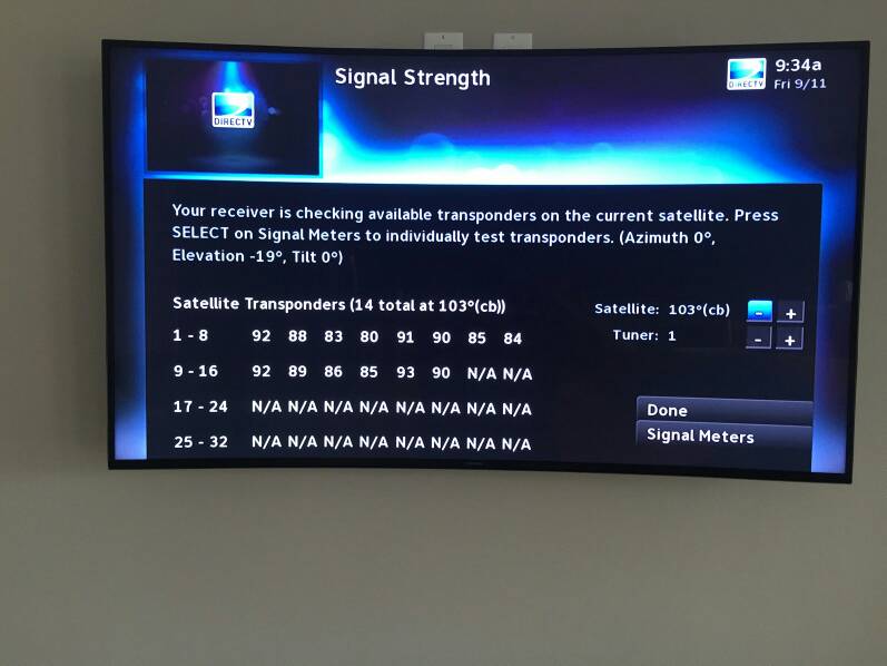

see attached.. compared with mine.. some are higher some are lower than mine but very comparable and I've had no issues getting my receivers activated.. should be noted weather is not the best today .. these values are better that'll what he had this morning before tweaking the dish

The dish needs to be better aligned. You will get a picture, but it will go out much more quickly in the rain and you will get error messages, as you already know.
BTW, any chance you could post a screen shot of the 103s signal strengths?

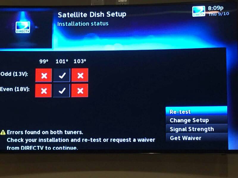

the problem he is having right now is that when the retailer sent in the activation last night he got this screen on both receivers.. his signal is better today than last night but so is the weather.
