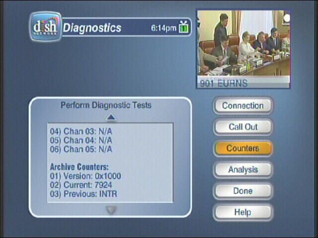

If you seen that signal level screen the you seen yellow blinking bar with a warnings about new scale.
No problem on all three Euro News channels here with D1000+ dish.
Signal strength is good - you don't have to worry about dish/switch/cabling.

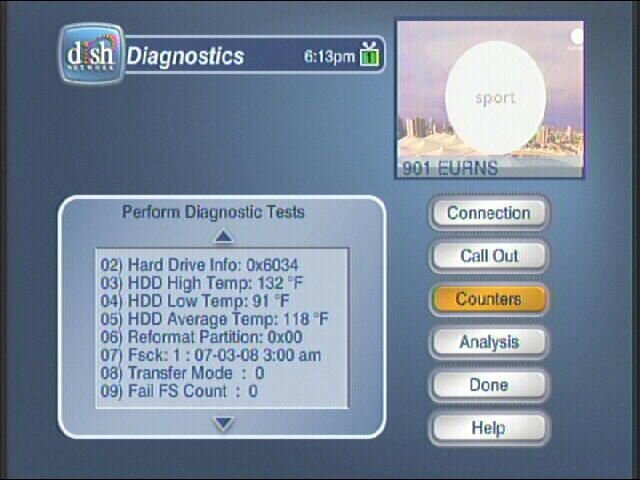

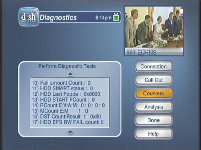

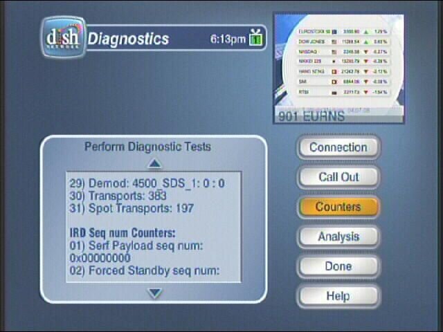

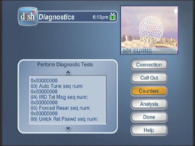

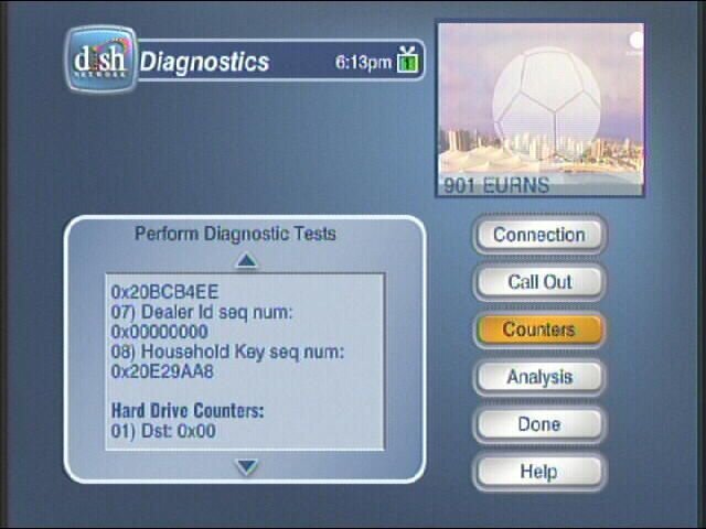

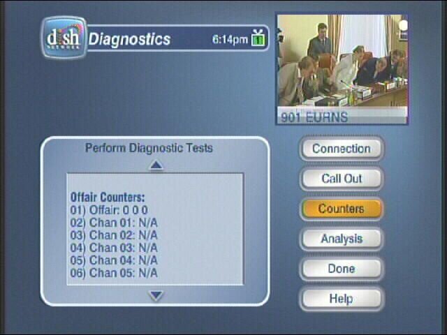

Time to check your DVR statistics - post pictures of all screens selecting "Counters" in Diag menu.
screen shots
here are my screen shots

OK, we see some data to dig down on picture#3: 13) 11:42.
Now lets make pictures of Details screen(s) after press two times on SysInfo button, just give it a couple minutes to finish check signals and parse history tables.
