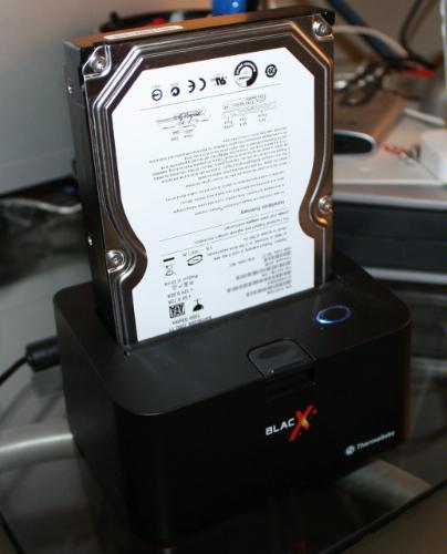

I use these for my MicroHD with bare 3.5" 1TB drives, my Dish 722k, and my LG Smart-tv: http://www.newegg.com/Product/Product.aspx?Item=N82E16817153071
Thermaltake BlacX ST0005U External Hard Drive SATA Enclosure Docking Station 2.5" & 3.5" USB 2.0 & eSATA
Nice thing about them, is they are BOTH USB and eSata. So, I could use either interface as a lot of new devices (such as newer Tivo's) are eSata inputs instead of USB. There's even a newer version that can handle USB 3.0. I even had the drive enclosure power supply for a WD "My Book" drive go bad, and I removed the internal drive and put it in one of these and didn't lose any of my VIP722k recordings from over the years.
