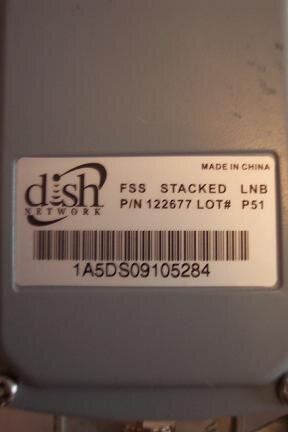

I am told by one of my contacts at Dish you can find the lot number by removing the plastic LNB Shroud and on the bottom there is a sticker with the information there.

I have a LNB assembly sitting right here and it does in fact have a Lot# on it. As soon as get my customer taking care of I'll let you guys know what the Lot# is on the LNB and if in fact it's the problem.
Yep, I've attached a picture of the new one i have here showing where the Lot# is located.
