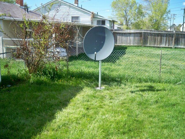

So as you might have saw my picture I sunk a fence pipe them put cement down it. Yes the pipe got hard but it move a little. I cannot explain a little. It seems more secure one way. The base in the ground it hard and does not move at all. Did I fook it up? I'm pretty sure it is not in a windy spot. But I do know when the wind hits. It might move. ANy other ideas?

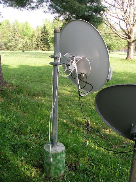

I too used fence pipe for my dishes. I too put concrete down the middle of the pipe. The base I dug down 30" to ensure I was below the frost line. I use a 10 1/2" dia plastic bucket which was 15" high. I cut the bottom off the bucket and dropped it over the pipe and centered it setting it on the ground. After cement was dry I cut away the bucket. Maybe over kill but been through two winters and wind, no movement or shifting.

Like I said. The base is solid. 100 pounds of concrete for the base. the base is sturdy. Just when I take my hand and move the pipe at the top back and forth. I could be over doing it. Since I will put the dish on it this friday. But when I move the post on the top. It goes back to center on the level. Plus I was not going to put the dish on the top. I was going to lower it down. Worst case. I put a stationary or 2nd dish on it and plant another pipe for my motorized dish.

Pics of what i did.
This a pic of mine. The dish is only mounted 37" above the base. No movement.

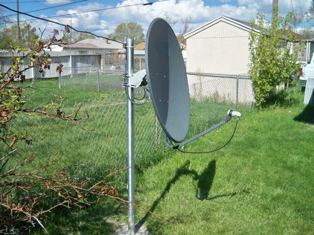

Well I got the dish up and wire ran. I was going for higher signals but I get like 30 on rtn and the signal jumps up to 40 and all over the place. Sigh. All the settings check out. Not sure if it was the dish or something else. But it is watchable. When I get a sec I might tweak it a little more. See if I can bounce it up to a stable 40 or something. Anyway here is some pics.
Hi ussexplroer and the group, nice and clean install! Love the thick lush northern lawn. Looks like the poll you used is at least 2 inches in diameter so I'm surprised you had any flex. Maybe the steel the post was made from was from a recycled car spring ;-)
What dish it that? Looks like winegard grey to me. 90 CM ? How does it do on other satellites? Sometimes a bouncing signal quality indicates a tree branch blocking some of the signal. How is the view under the bottom rim of the dish looking up at the LNB? Any branches?

Everything is geosatpro except the fortec mercury II receiver. It has the bullet lnbf, the gs-120 motor and the dish (believe it is 39" cannot remember). The place i ordered it from basicly gave me a good deal and it came from satellite av. If I would have known that. I would have ordered it direct. Anway shipping was great. From Satellite av to me was like 3 days fedex. This was like three years ago.
