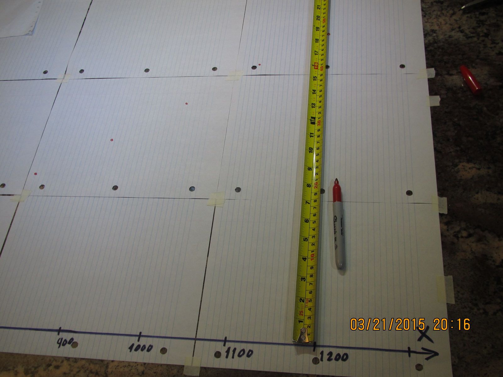

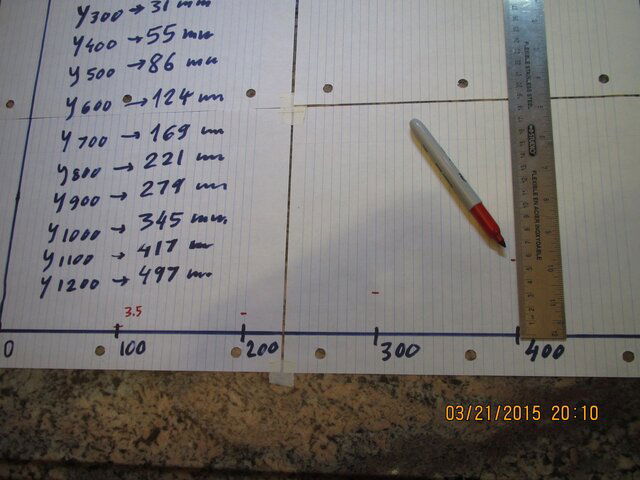

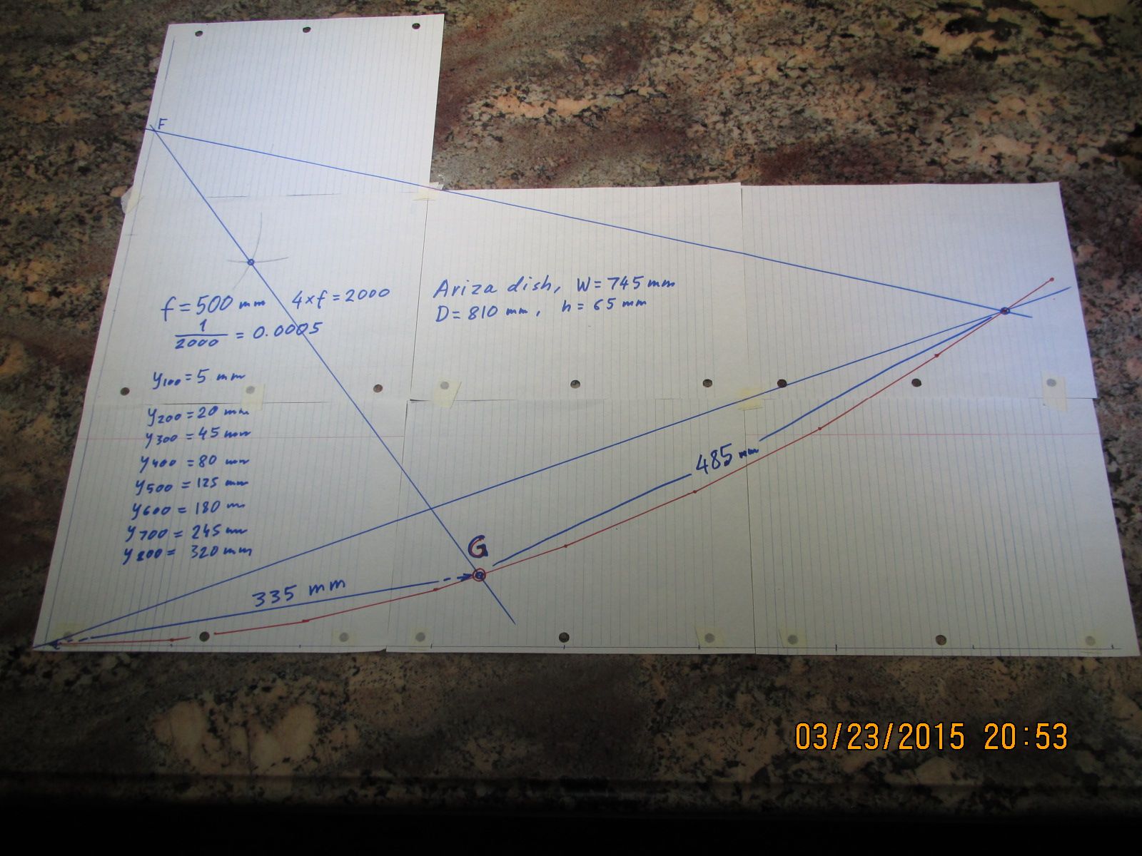

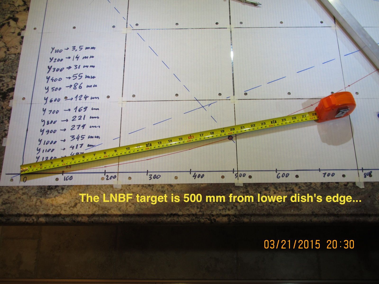

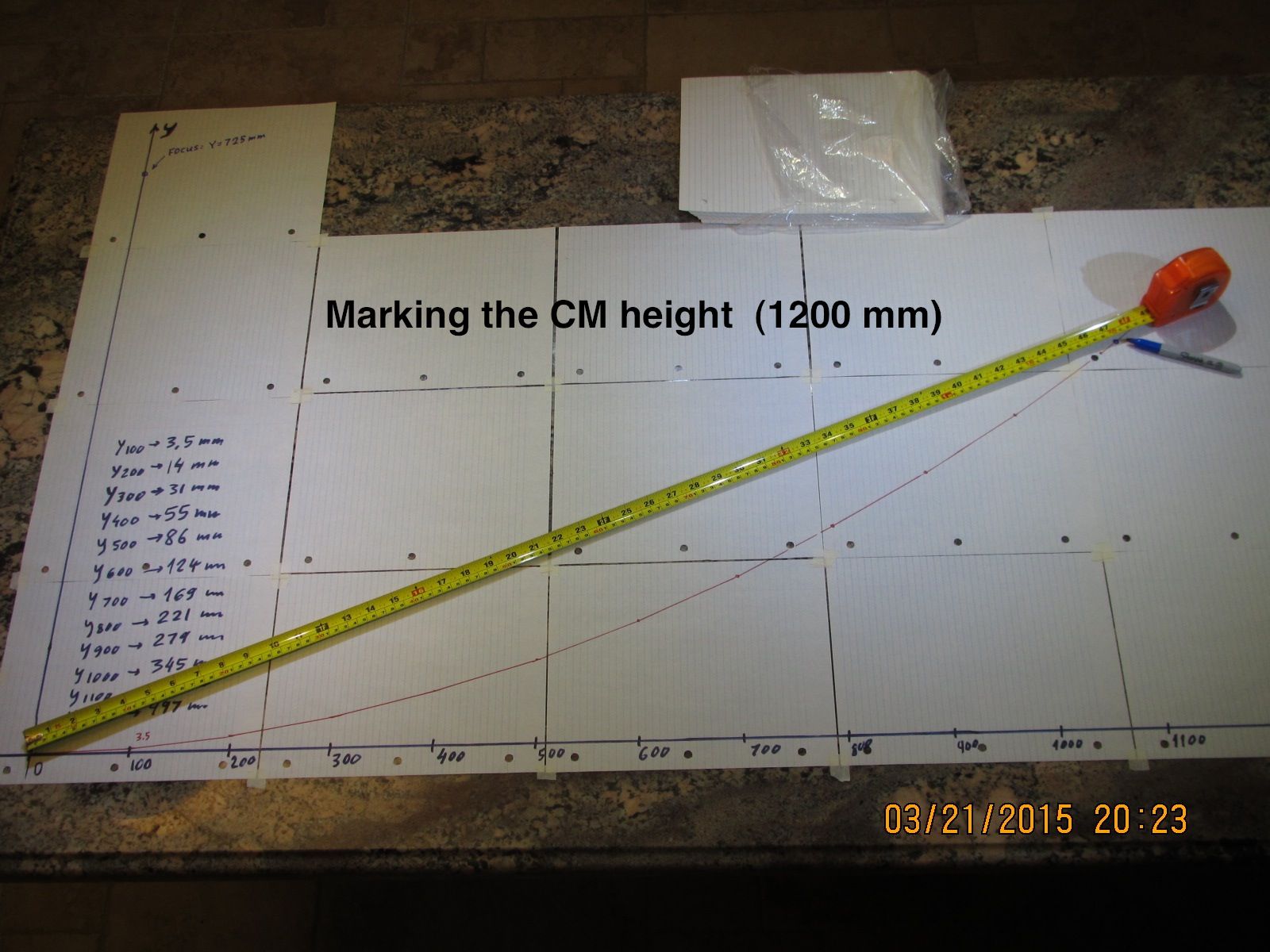

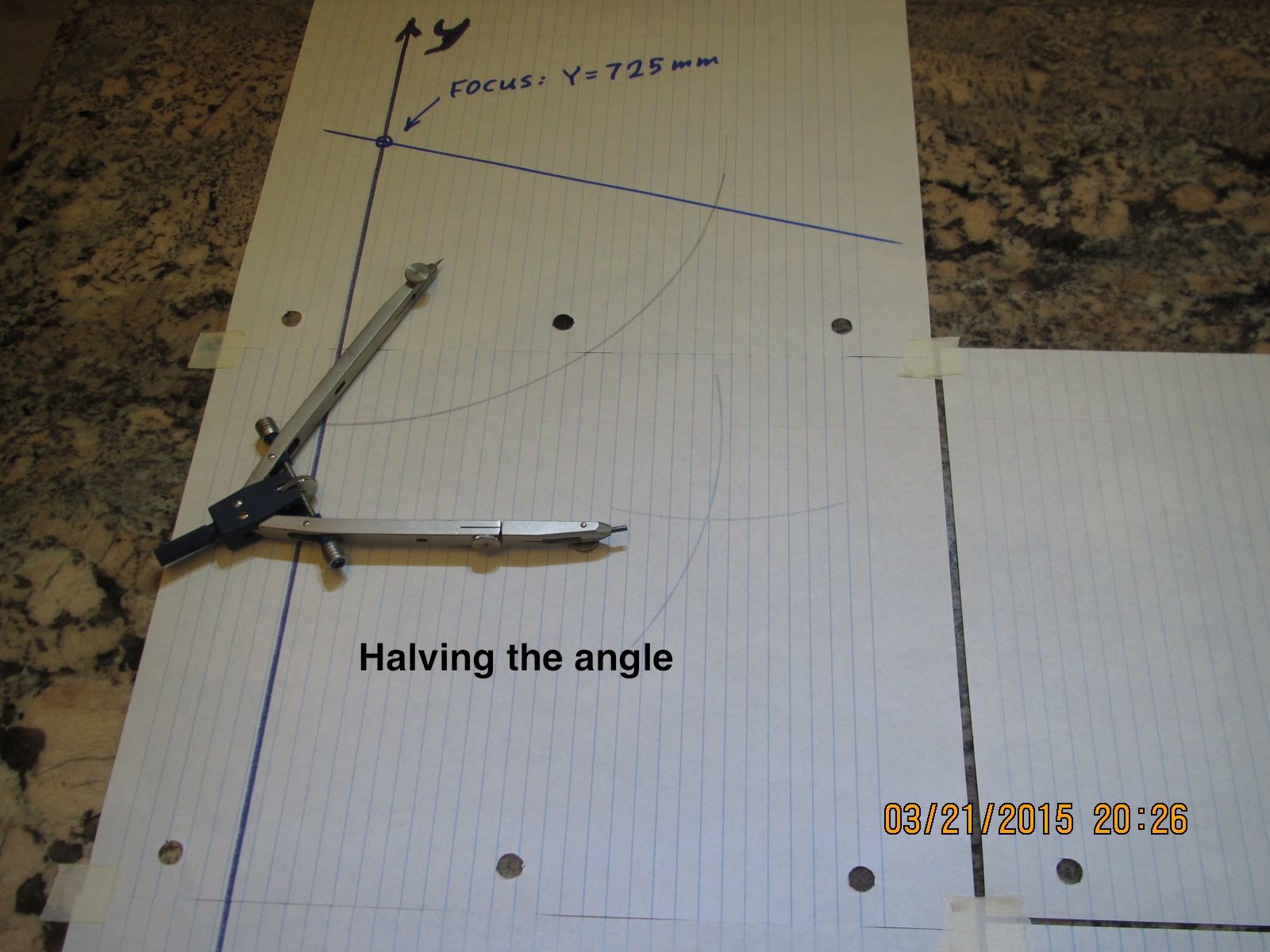

Proper aiming of LNBF is useful, as it helps obtain maximum Q. Some time ago Titanium planned to make laser device for it. Other forum member, Rima NTSS also did good work, using lasers, too.
Other members suggested computer program, Parabola 2, for needed calculations.

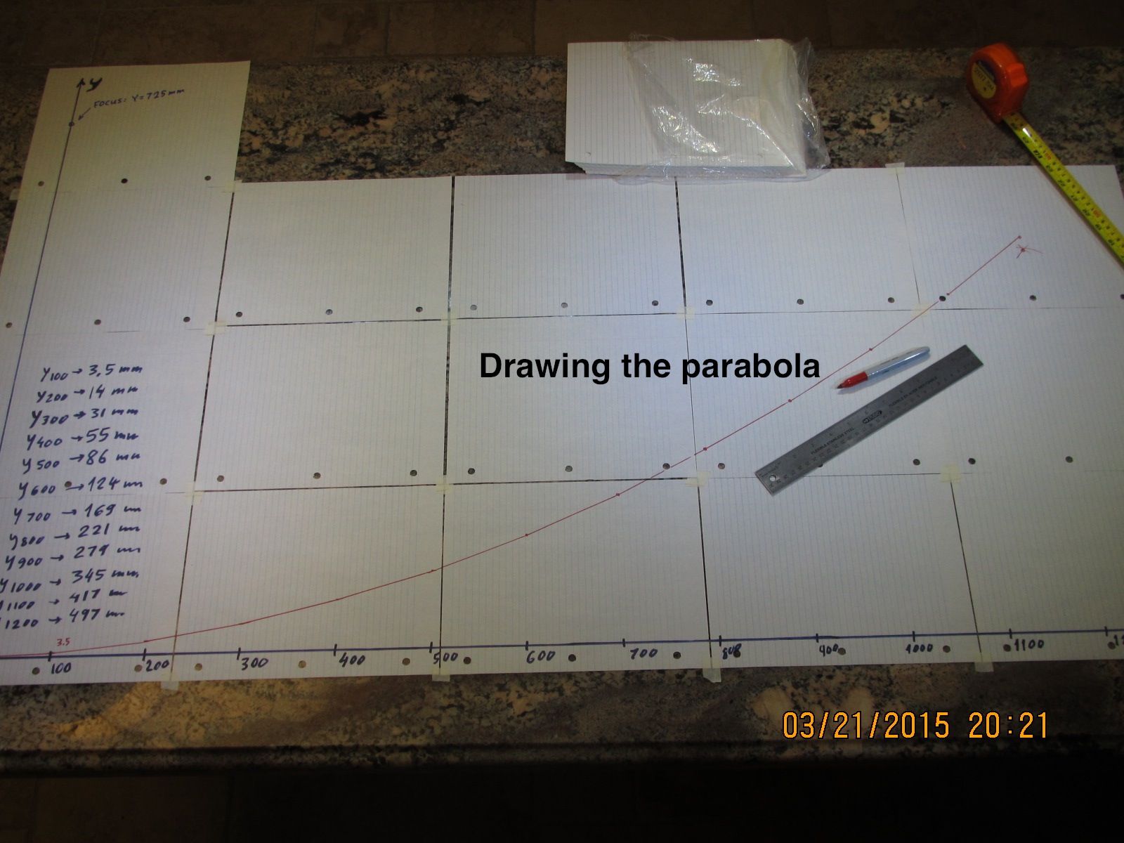

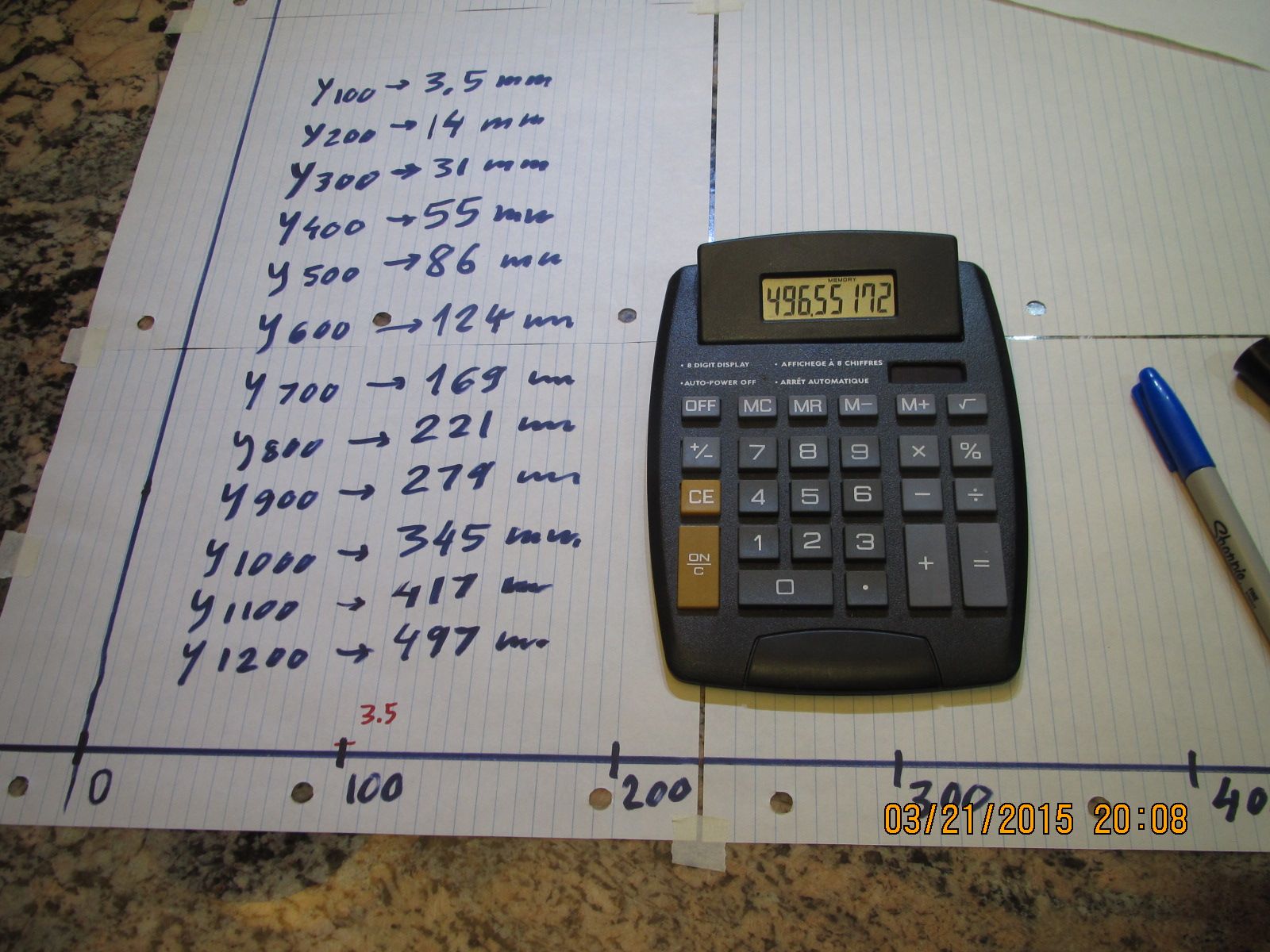

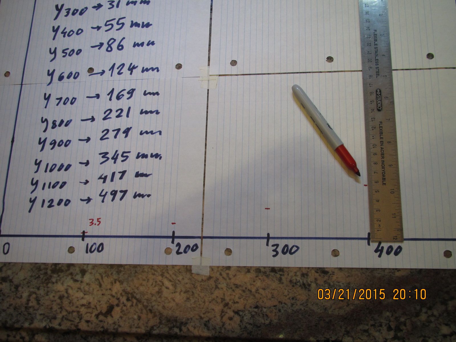

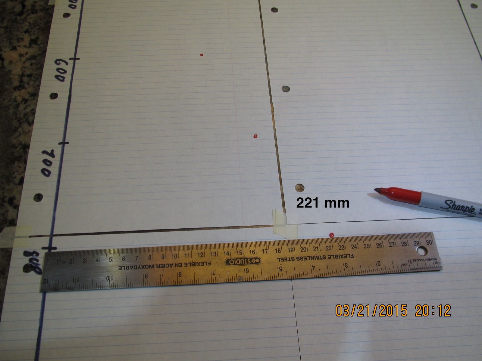

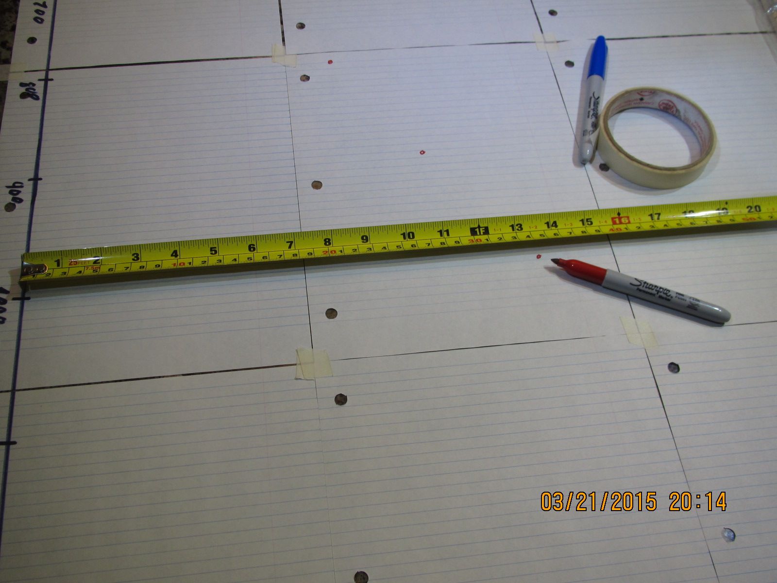

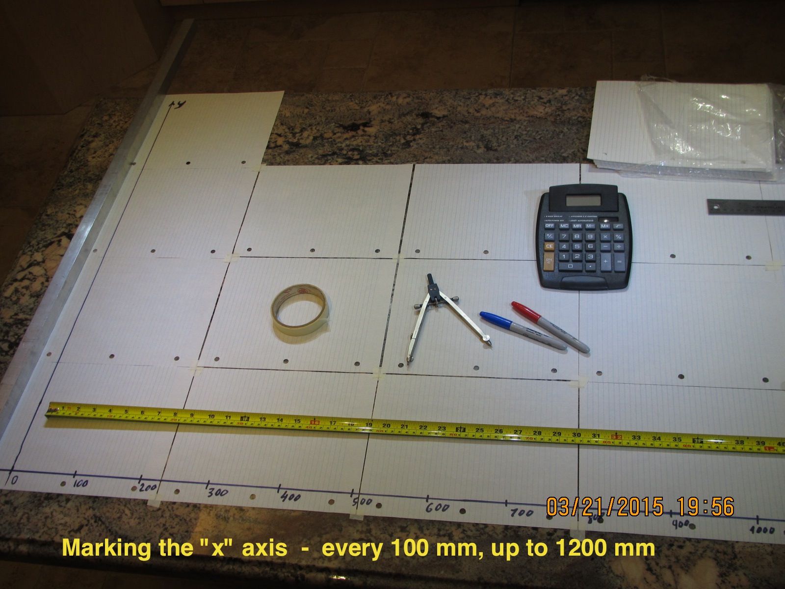

I tried to reach this goal without lasers and computer programs, using just paper, ruler and basic calculator.
Drawing of parabola was needed. Focal length was provided by Rima, in a picture of his post, its value - 725 mm.
For drawing of parabola, only the focal length is needed. Assumed scale 1:1
Pictures follow :
IMG_0860.JPG IMG_0861.JPG IMG_0862.JPG IMG_0863.JPG IMG_0864.JPG IMG_0865.JPG IMG_0866.JPG IMG_0867.JPG IMG_0868.JPG IMG_0869.JPG IMG_0870.JPG IMG_0871.JPG IMG_0872.JPG IMG_0873.JPG IMG_0874.JPG IMG_0875.JPG
Congratulations polgyver , you've chosen hardest way to go (which is not bad) and used tools many people today do not even know they exist! :) Good job. And, at the end of the day, you got all needed measurement of dish. However, I am afraid you will still need more sophisticated tools to physically install and adjust antenna and LNB. I have no doubts you can do that well.

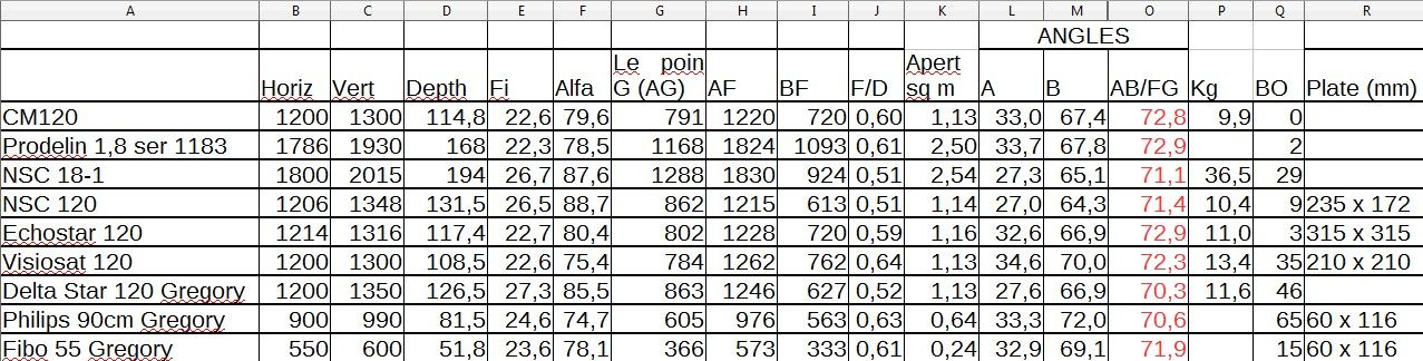

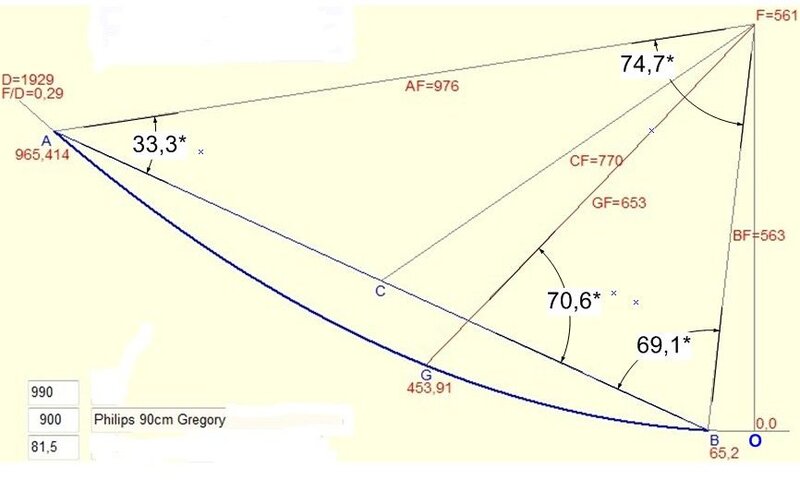

I've made spreadsheet another day, included in it data from some of my dishes. Perhaps I will need some of these data for future work and it is better to have it available all the times. Spreadsheet will probably grow horizontally and vertically as time passes. And spreadsheet is living creature, some data can be slightly changed in to make it more perfect.
So, what is this data about (columns):
A - Name of the dish;
B - Horizontal size of the working area (This represents real size of dish- 1200mm means 1,2m dish);
C - Vertical size of the working area;
D - Depth of the dish in the very middle of it;
E - Offset angle of the dish;
F - Opening angle (angle from antenna's focal point and lower and upper points of the dish);
G - Distance from upper point of the working area of the dish to the aiming point of the LNB (sometimes it is not easy to measure distance from lower part as there is obstacle- lower LNB-arm);
H - Distance from the upper point of the dish to the focal point F;
I - Distance from the lower point of the dish to the focal point F;
J - F/D of the dish;
K - Surface of the dish visible from satellite;
L - Angle A (see on screenshot);
M - Angle B;
O - Angle AB/FG;
P - Weight of the dish without feedarms and mount;
Q - Distance from center of the initial parabola (from which offset is made) and lower point of the our offset dish;
R - Distance between holes for fixing dish to it's mount.
Attached:
- screenshot of data-spreadsheet;

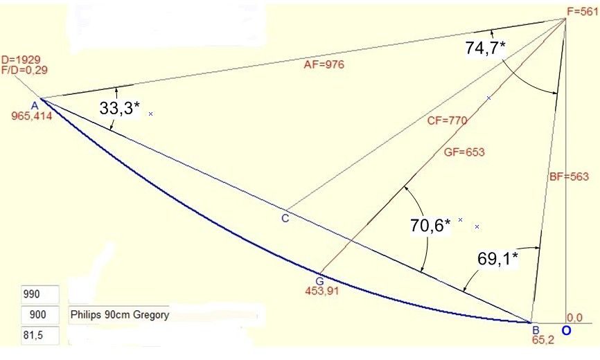

- screenshot of profile drawing of dish (example for 90cm Gregorian type);
Reactions: jorgek and polgyver
Polgyver, you're a constant inspiration to all of us! I fear, though, that you've made an error here: the height of the CM 1.2 m dish is 1.3 m, not 1.2 m (which is the width - as seen in Rima's spreadsheet).

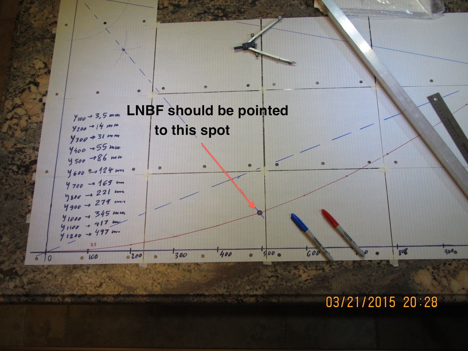

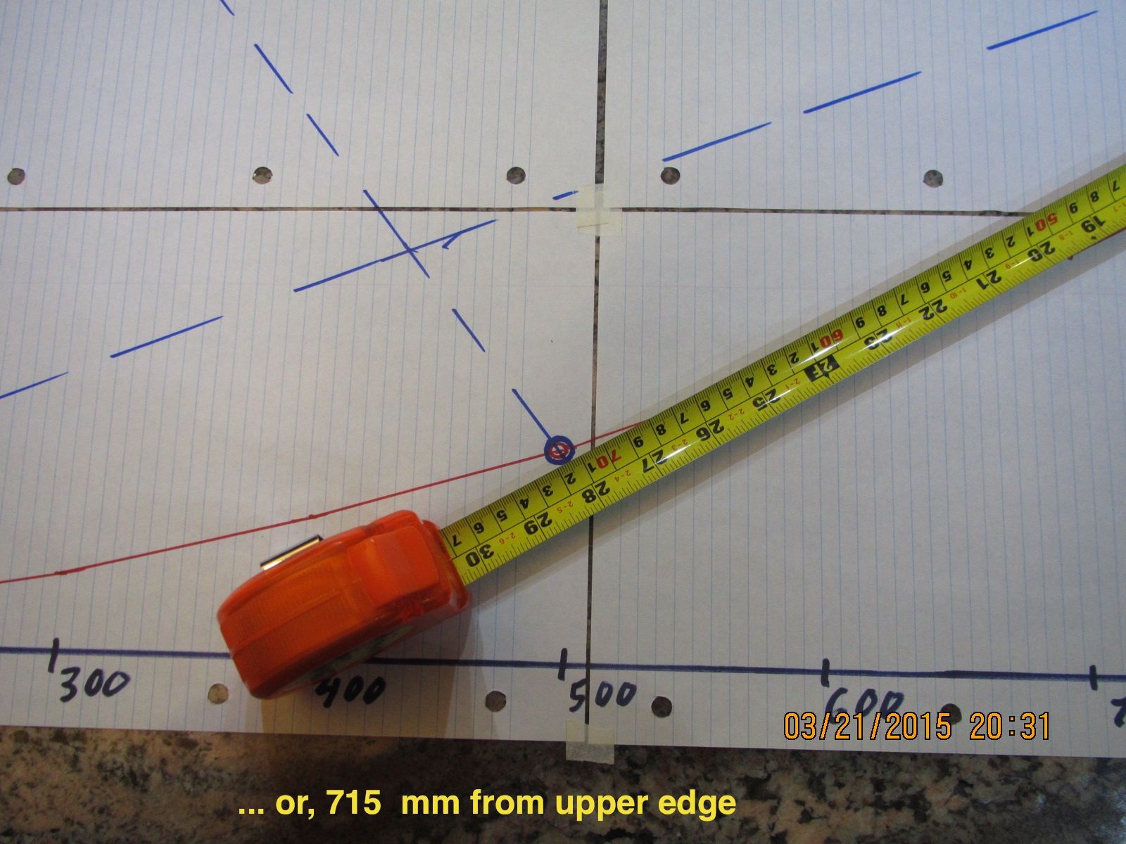

DVB-S2, you are right, I should have marked one more spot - 1300 mm, on X axis.
But the main goal was to show, that the location of target spot was closer to the bottom edge.
Had I done it correctly, the respective distances from bottom and top of the dish would have been, approximately, 550 and 770 mm.

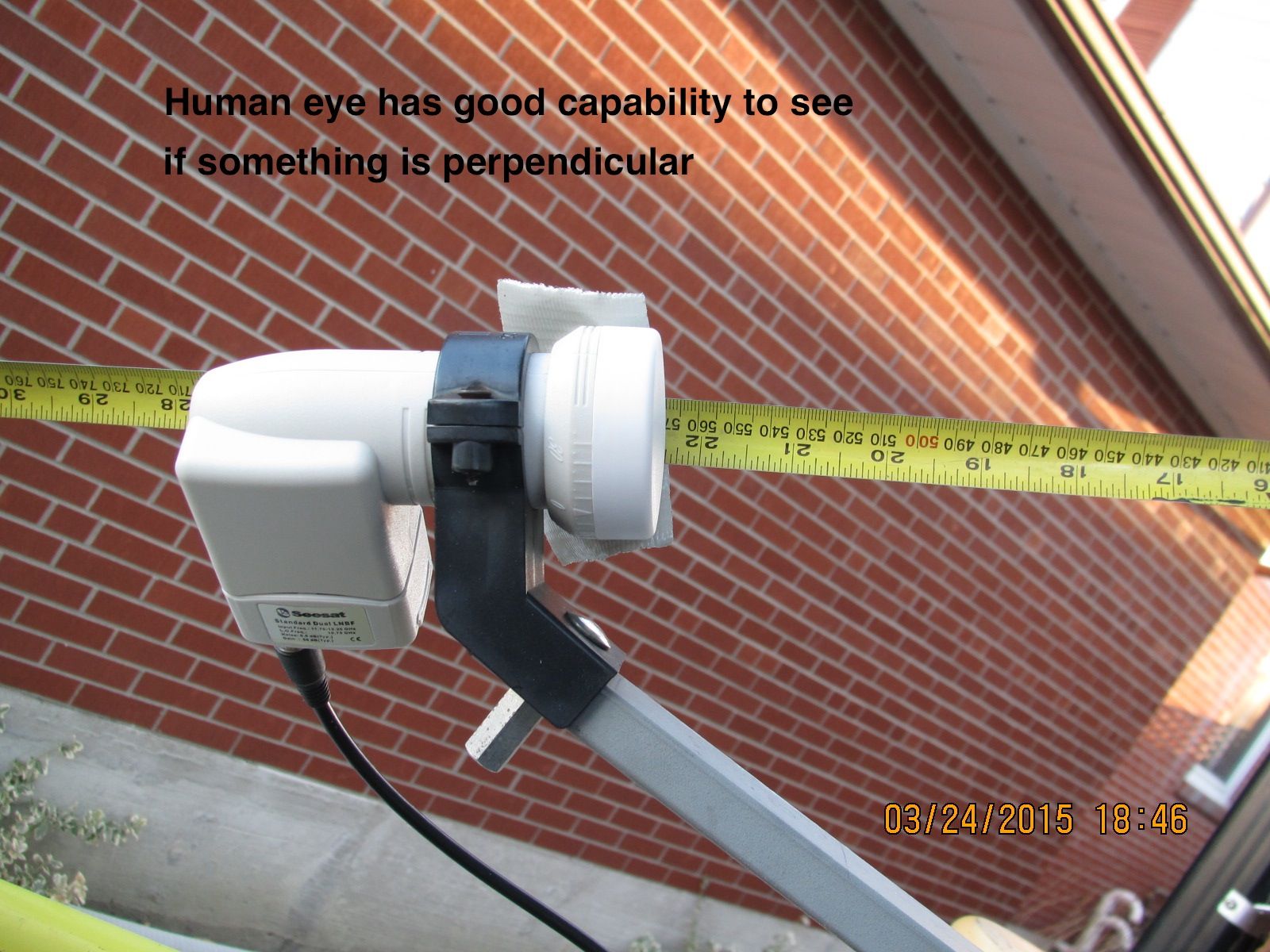

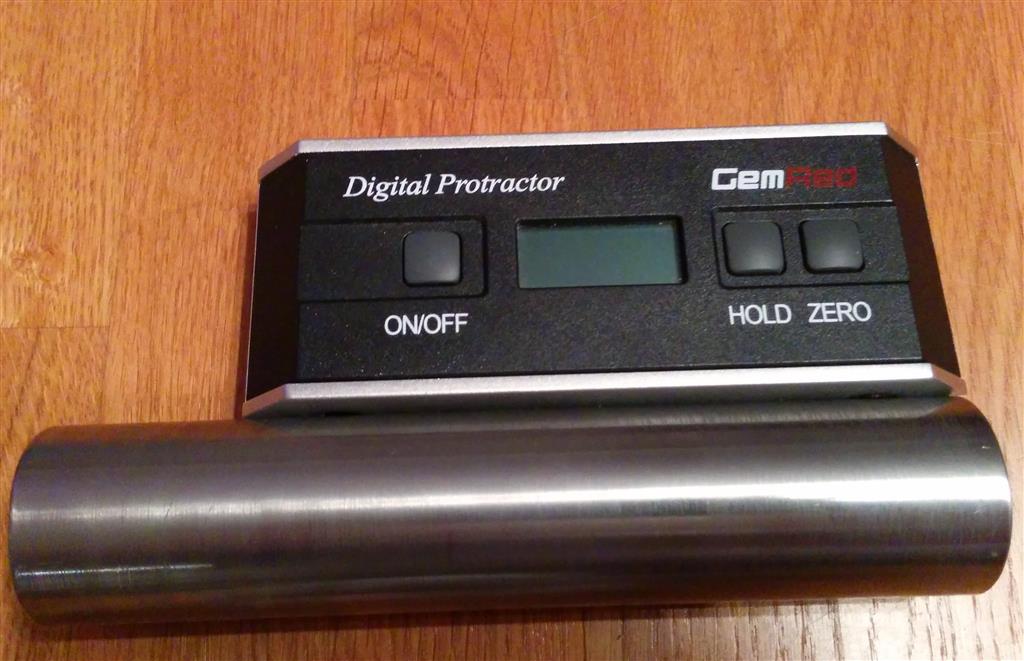

There is my new tool for antenna tuning. Very simple, but should be very helpful as well. It is just piece of metal pipe 40mm in diameter. This pipe will temporary replace LNB and digital protractor will be magneted to it. So, than I will be able to measure angle between LNB pointing line and leaning of the dish with the precision up to 0,1*. In such way it is possible to check whether LNB is located at antenna's focal point.
Reactions: polgyver

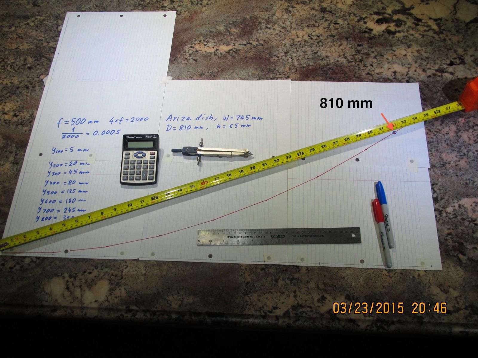

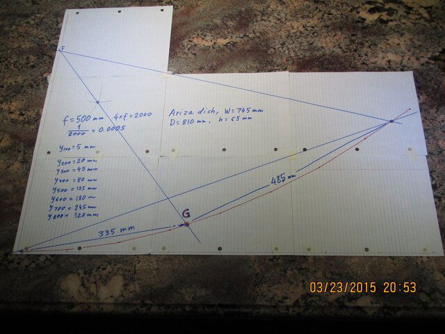

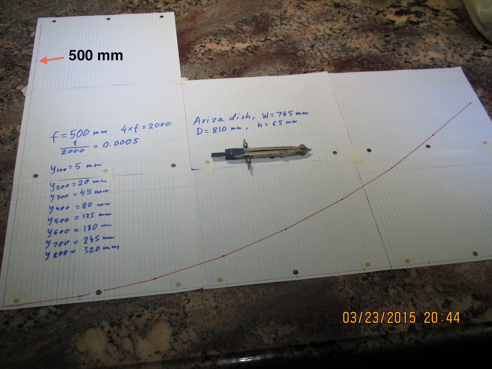

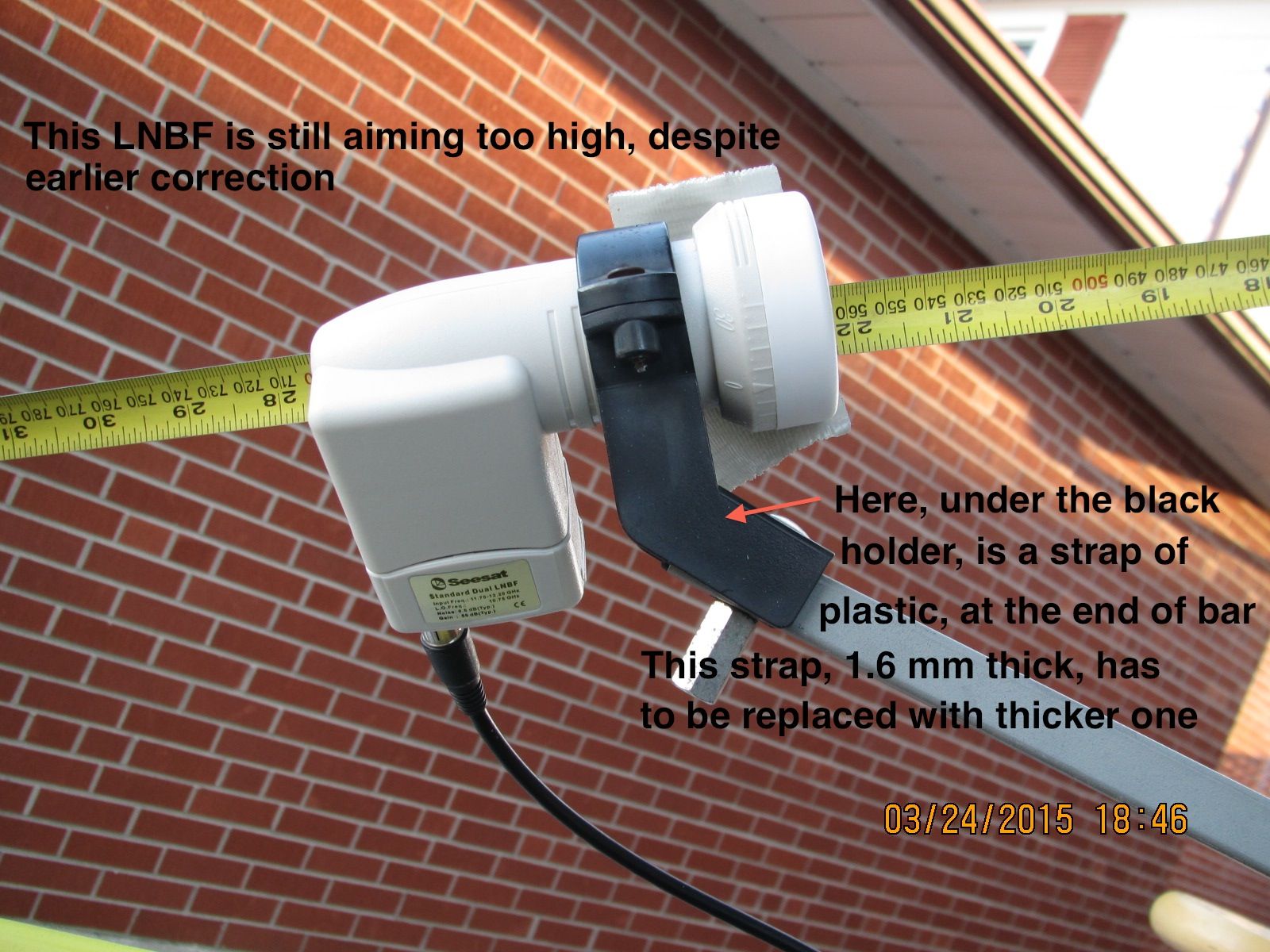

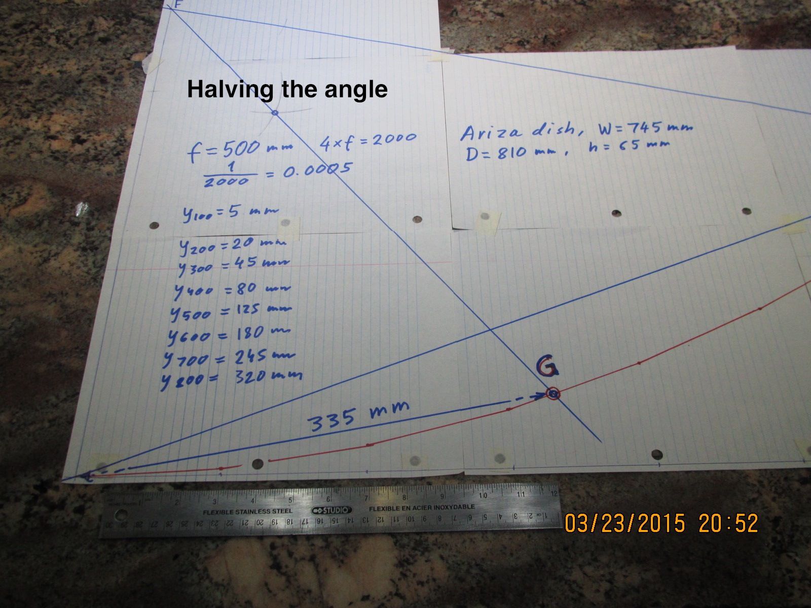

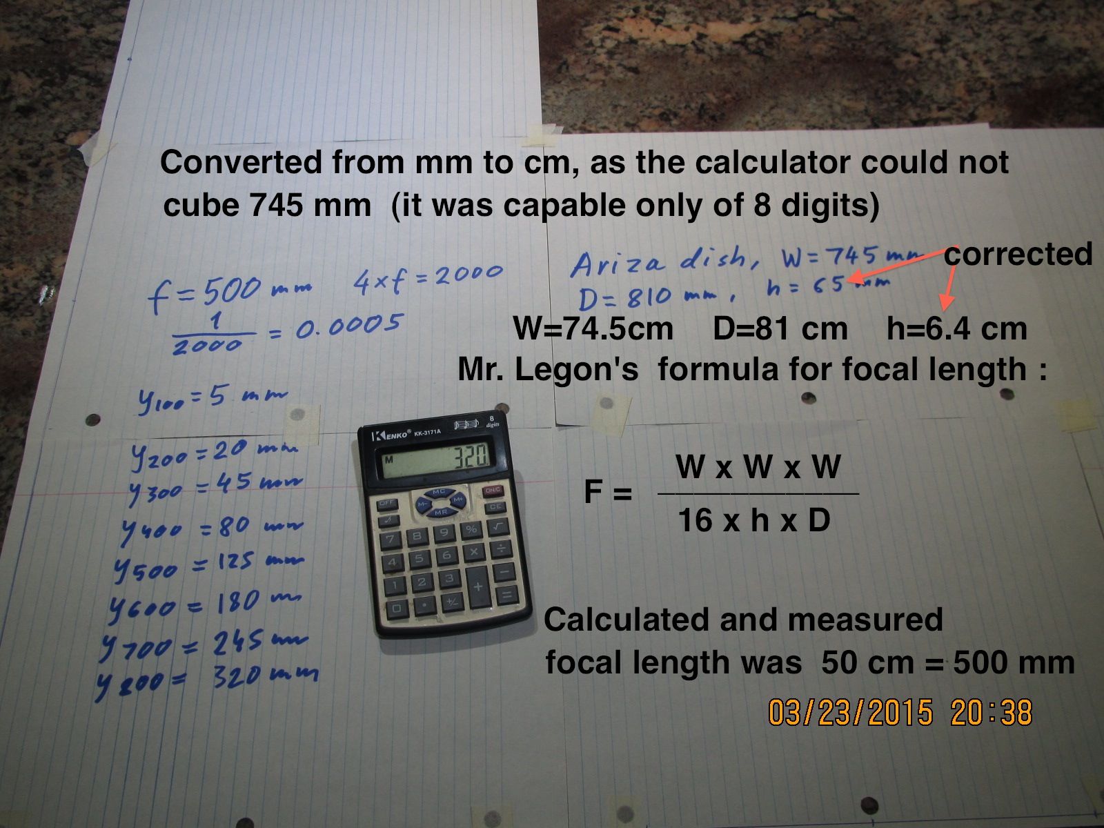

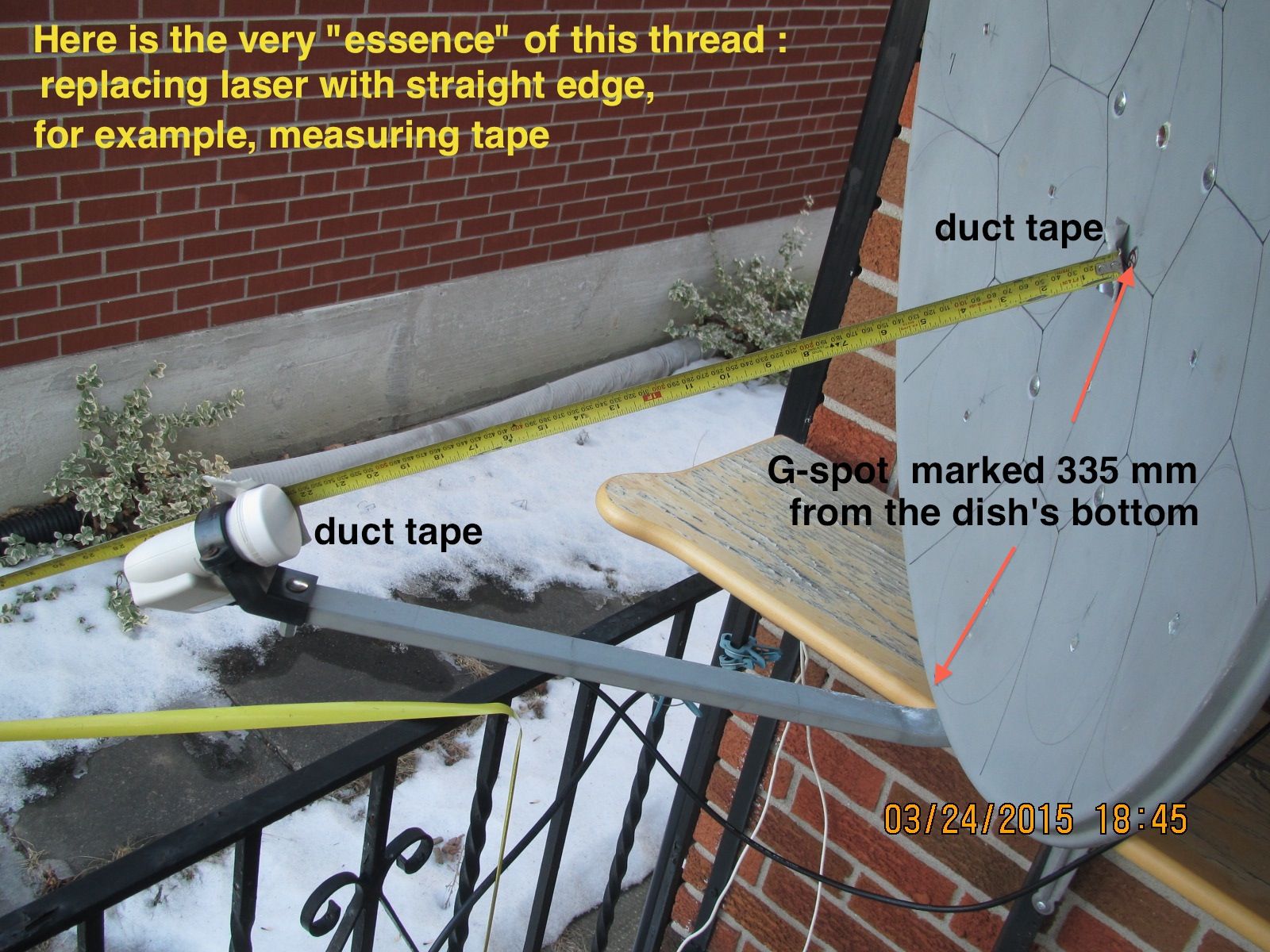

Tried it again yesterday and today, with a smaller dish which sits at my porch. Applied Mr. Legon equation. More on attached photos.
IMG_0876.JPG IMG_0877.JPG IMG_0878.JPG IMG_0879.JPG IMG_0880.JPG IMG_0881.JPG IMG_0882.JPG IMG_0883.JPG
Reactions: jorgek and RimaNTSS

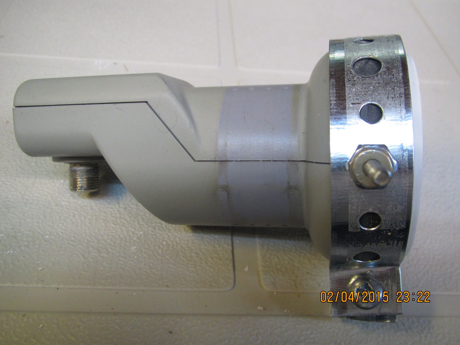

2 polgyver: Where do you consider is LNB's Phase center? Somewhere where I put red dot on your picture or somewhere else?
I think your dot shows it perfectly. I gathered from reading on this forum, that LNBF's phase center should be 1/4 - 1/2 inch below plastic front cover.
Also in this area was "axis" of 2 bolts for experimenting with LNBF angle, I think I posted this picture in your other thread.
