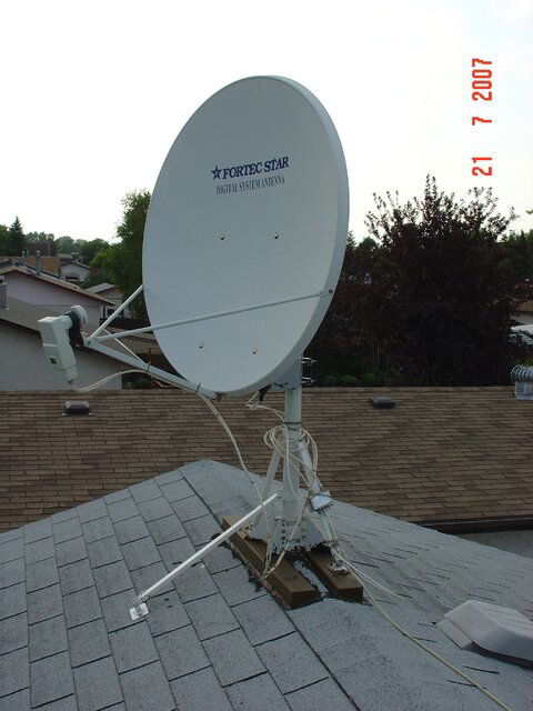

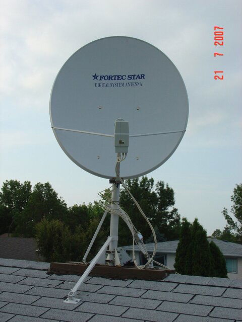

Today the Fortec Dish, Stab Motor, & Invacom QPH-031 LNB are very accurately tracking Satellites from 72.0W to 127.0W. On my South Satellite G 25 / 97.0W I can now get Q signal levels on 11966 = 65%, and on IceBergs' list 12152 = Q of up to 75%, and 12177 = Q of 75%. See Pics 1 & 2. It must be duly noted that without the help of the many wise folks in this great Satellite Forum, I would have been hopelessly lost.

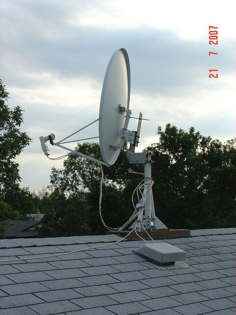

First Attempts - LNB Touching the Roof Shingles:/B

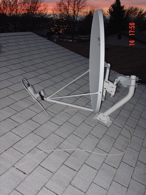

The first attempt was to try and install the Fortec Star Dish with the Standard Roof Mount. I was first sold a SG 2100 Motor. The low roof location resulted in the LNB hitting the roof shingles so it had to be turned upside down to avoid hitting the roof when rotating. See Picture 3. The whole setup was extremely shakey when walking by the dish. After many problems trying to acquire 97.0W I contacted Fortec Canada who instructed me to trade in my SG2100 Motor for a Stab HH 120 Motor that was $60.00 more. So I got the Stab HH 120 Motor.

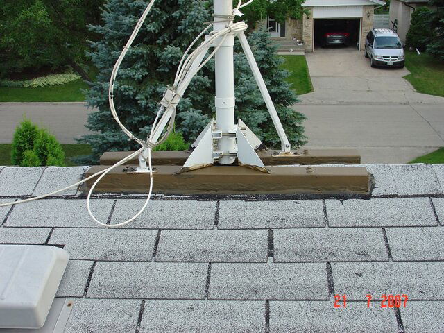

Placing the Fortec Ground Dish Mount on the Roof:

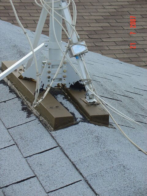

Talked to my great friend George, telling him that likely the best mount for this dish and motor was the Fortec Ground Mount. George said then let's put it on the Roof! (Everyone need to have a friend like George). So went to a local Plywood Store and bought a 8 Ft. Cedar Fence Post. Got their professional Carpenter to cut the Cedar Post down to 4 Ft. The 4 foot piece was cut again to the exact angle or pitch of the roof. (To get the right roof angle we took 2 - 2X4s and nailed them together on the roof then took them to the Plywood Store so the Carpenter could measure the exact roof pitch angle). We then mounted the 2 - 4 ft cedar posts on the roof Peak for the Base of the Fortec Ground Mount Post. See Pictures 4 & 5. Used washers to Plumb up the Dish Post used tar to waterproof everything, and this month painted the fading cedar posts with 3 coats of wood preservative.

Used a compass to get an idea where true South was and rotated the Dish and Motor to this point. See Picture # 6. By far The biggest problem was the Elevation of this Dish being so far off. Satcalculator.freehostia.com told me for Winnipeg (Canada) my Dish Elevation should be set to 22.7 degrees. But in fact it needed to set be 32.7 degrees!! The other major problem that needed to get resolved was someone on this Web site advised me that when in USALS on my ViewSat Receiver Antenna Settings you had to punch in your Longitude and Latitude coordinates then press OK to Blind Scan in each Satellite. This works well.

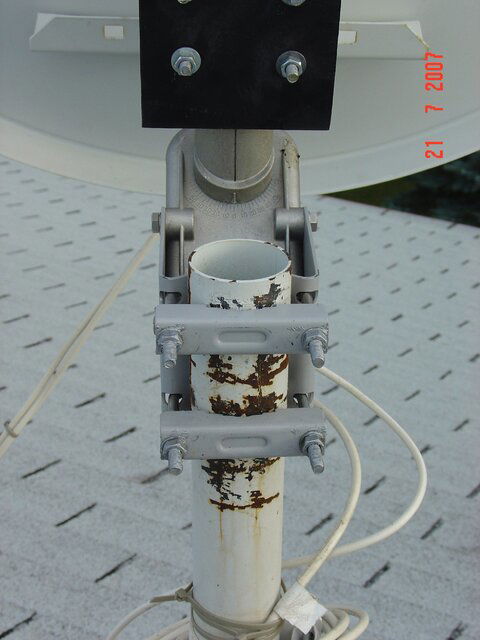

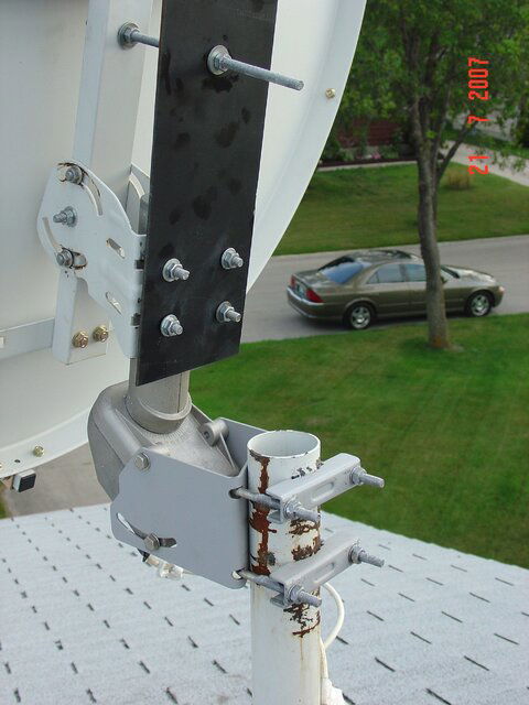

Pivot Bolt and Plate for Fine Tuning Dish Elevation:
A major problem I had was trying to fine tune the Elevation on the Fortec Star Dish. Thanks to some great advice from Anole, Bill190, and many others, we installed a Pivot Bolt and Steel Plate which has helped immensely in trying to adjust the elevation of the Dish. See picture #7. The Pivot Bolt has been the difference in being able to attain a Q of up to 63% on 11966 Russia Today on 97.0W.

Nice pictures, glad you got everything going :) The 120cm dish probably wouldn't improve reception enough to warrant the extra expense (and they are VERY expensive to ship). Looks like you have a nice system!
the plate is a great friggin idea,i'm installing a 1.2meter and i live in northern manitoba so your pics are a great help my friend.
i believe my Dish Elevation is the same ,so are you sure its not 22.7 degrees?
PICS LOOK GREAT
ONE more thing , what is the MEASUREMENTS on that plate?
PICS LOOK GREAT
Brotherhood, the Plate is about 4 inches wide by 8 inches high, I can measure it next time I go up.
Re Dish Elevation: it correctly calculates out at 22.7 degrees for our Location, but with this Fortec Star Dish there was a 10 degree error, as others have noted, I have NO idea why this happens with this Dish & Motor combo.
PICS LOOK GREAT
Brotherhood, the actual measurements of the Plate were 12.75 by 4 inches (thanks to Anole).

I noticed one pic that showed the cables running into the diseqc switch-but
couldn't see a rain-loop (looked like the rain could run right down into the connectors, but I prob just couldnt see enough of it) So that might be something to look at.

Do you think the measurements of the Plate would be the same for a 1.2meter?

Brotherhood, the 1.2 meter dish should be identical on the back (if you are using a Fortec Star Dish), so the Pivot Bolt, Plate and Threaded Rod setup should work for the 120 cm Dish. Thanks for the Fishing invite, you will get a lot more satisfaction and great experience if you choose to do it yourself. Have you picked out the type of Dish and Motor that your going to use?

Thanks a lot TurboSat. How do I set up a Rain Loop to the Chieta DisEqC switch? Guess I need to do some rewiring here?

Rain loop is just making aloop in the cable before it goes into the switch, so the rain dripping down it drips off the loop, instead of running down into the connectors. I never trust connectors exposed to weather!
