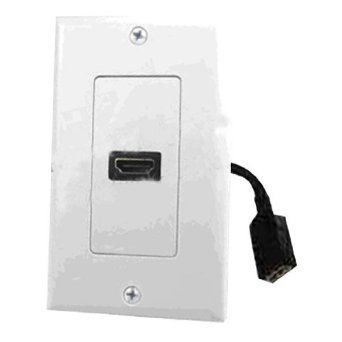

The low voltage wiring (HDMI and USB) shouldn't require any special care other than being in-wall rated. I would suggest putting an HDMI switch in though so that you only have to put 1 HDMI cable in the wall. Also look for wall jacks that have HDMI connectors at a right angle to the jack in the wall so that you minimize cable bend inside the wall.
I'm thinking something like this:
Order from Amazon.
