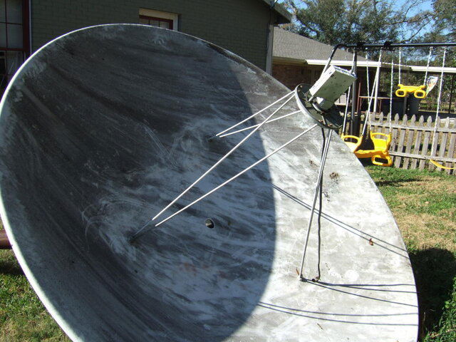

Got offered a Birdview from Skewed down in Lousianna (way down lol ) almost to the coast. setup a pickup date and drove down , the drive took about 6 hours ( thats about what we thought made a little better time maybe). Meet Skewed , he gave instructions to his house and left his cell phone #. the directions were spot on, but he called me when i was probably 5 miles from his house , checking on me. We got to his house and took some pictures and talked , started to take out some bolts and talked. Before you know it Stogie5150 called on his cell phone he was about 15 miles away.

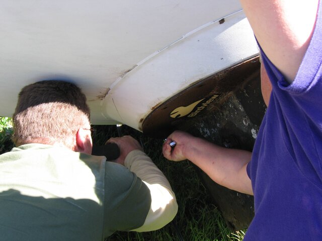

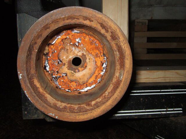

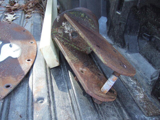

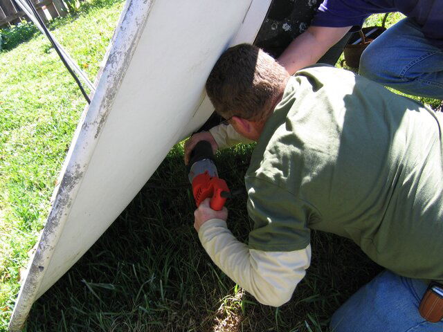

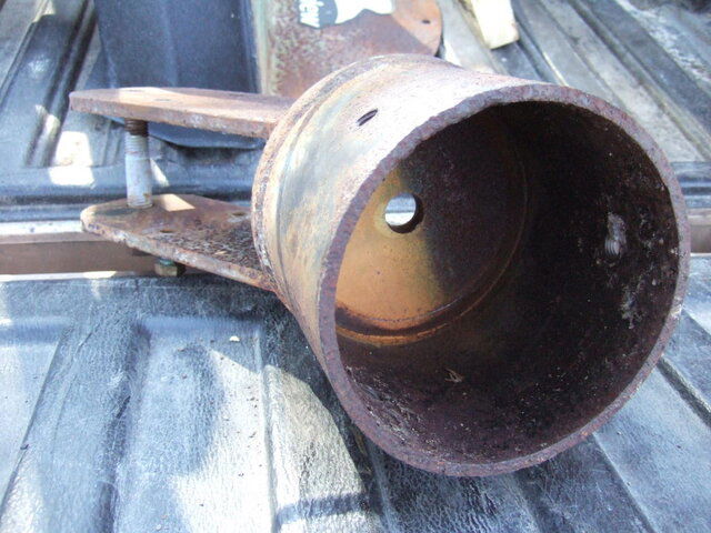

We continued to take bolts out and spray PB Blaster on them. Stogie arrived when we had all the bolts on holding the dish to the motor mount off ( ok almost all) two were spinning without comming out , one was broke off and another was 2/3 of the way out when it started spinning.
Stogie told me that some of the bolts would do this and he was right. so we cut the three bolts that wouldn't come out and talked a bit about SatGuys and everything. We discussed the bolts, even found a solution ( i don't know the cost but will have to check since i'm missing four bolts on the mount 2 upper & 2 lower)Skewed mentioned that they made a gun like a rivit gun that presses a sleeve/nut into a hole like this and should work for our purpose. (sounded good maybe a solution for this problem). :eureka

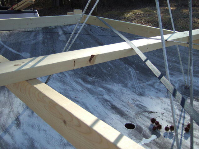

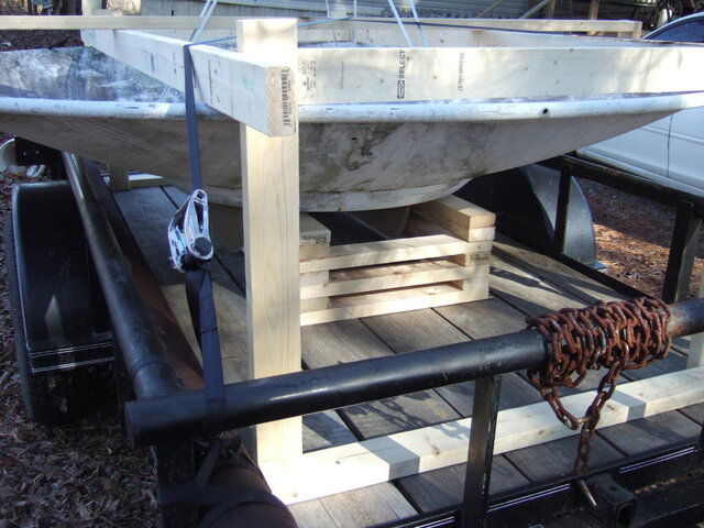

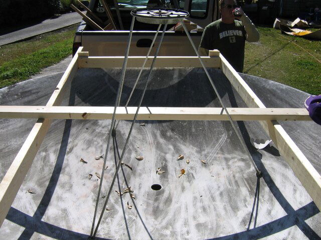

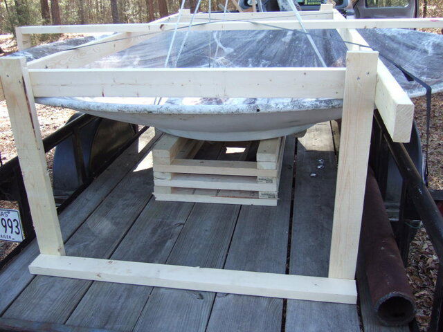

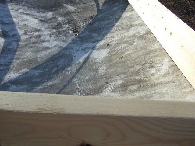

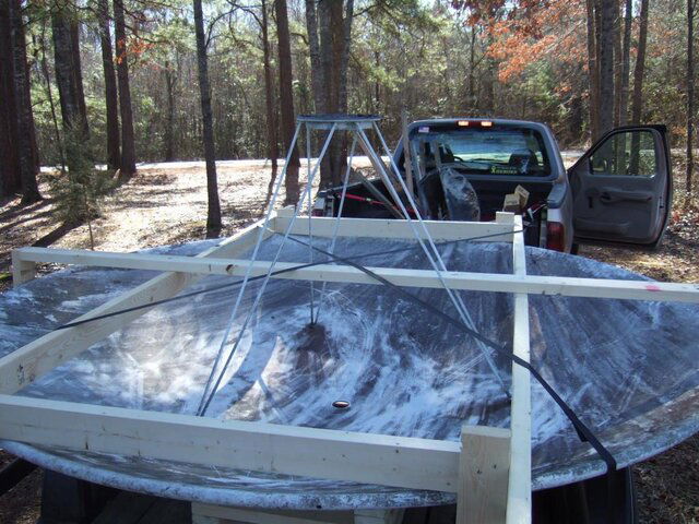

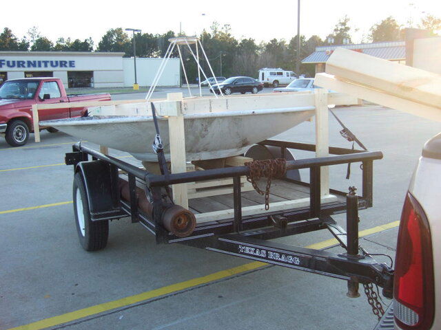

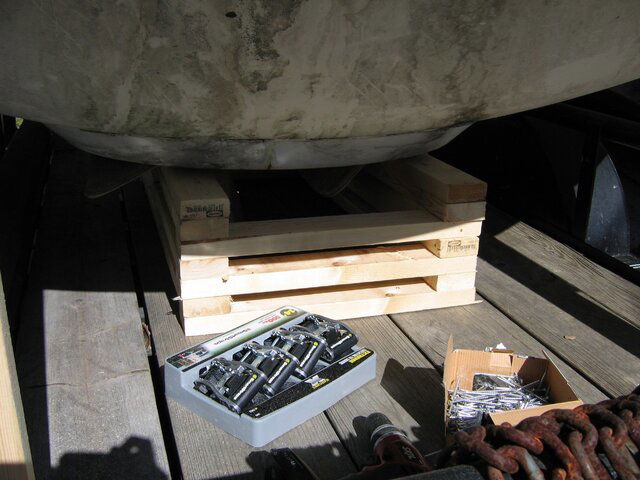

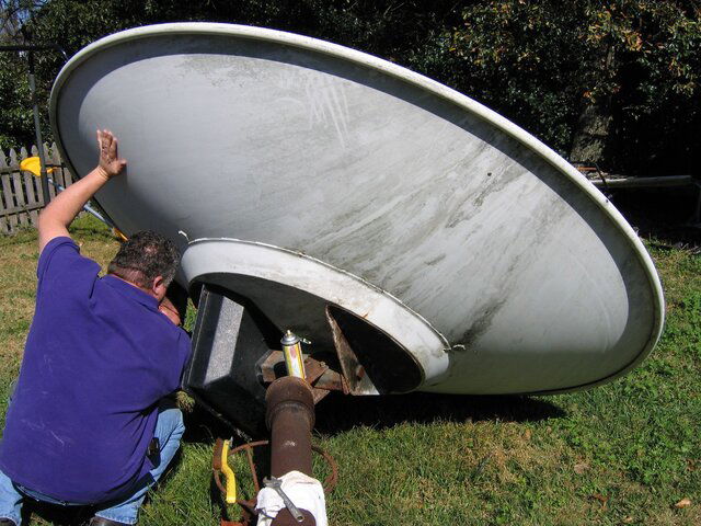

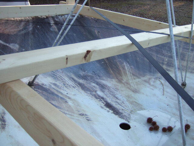

Ok we got everything undone, and here was where having someone who had done it before helps, Stogie jumped right on the main bolts that hold the motor on the cap. and then removed the center cap bolt. after that we started building the cradle to hold the dish ( and i had already cut several boards to speed this process up a bit). I will detail the cradle in another post and make a parts list for it. Its a simple design that worked for Stogie and it worked well for me.

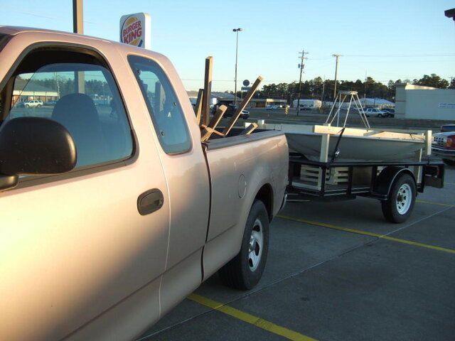

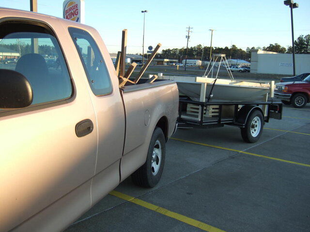

so we got the dish loaded and strapped down loaded the motor and all other pieces. strapped everything into place and was ready to depart. So from about 10:30 til 2 to get everything loaded up and done thats not bad.

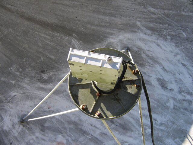

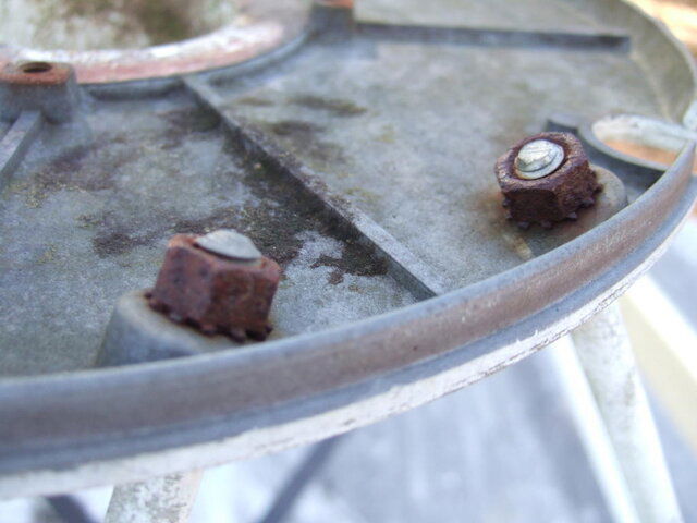

I see that you guys left the feed support arms on, probably a good idea the way the steel nuts looked on those aluminum support arms.
George, if you are going to modify your scalar for a CoRotor, you might check my thread for how I enlarged the center hole, it worked real well. There are some threaded holes already in the scalar that can be used to retain your new feed with.
If you really want those nuts off (I would), there's a device called a "Nut Cracker"
[ame=http://www.amazon.com/Professional-Cracker-Splitter-Buster-C-FRAME/dp/B000J47UL4]Amazon.com: Professional Nut Cracker / Splitter/ Buster C-FRAME: Home Improvement[/ame]
that you can use to split those nuts and get them off. Then just clean up the threads with a chaser and voi-la
Probably get one on fleabay for cheap
Another style
[ame="http://www.amazon.com/Nut-Splitter-Tool-Set-Piece/dp/B0000AX88Q/ref=pd_bxgy_hi_img_b"]Amazon.com: Nut Splitter Tool Set - 2 Piece: Home Improvement[/ame]
There's another technique for getting steel and aluminum separated, but it's a little nasty. I used to use this when I broke a tap off in a valuable aluminum part or when I wanted to "shrink" a drill.
Get some Sulfuric acid (H2SO4). It used to be you could get it from an auto parts store (battery acid). Use it like Liquid Wrench. It will eat the steel. It will eat the aluminum too but at a much much much slower rate. It will eat your cloths and your hands too so be extremely careful. Let it set for a day or so. Water will dilute it away (like with a garden hose) You might want to use a glass eyedropper to put a drop between the aluminum threads and the nut.
