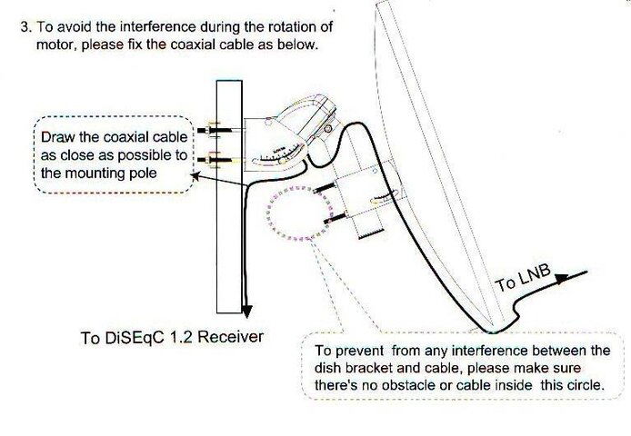

I don't know if this has anything to do with it but I was going through by motor manual today (see picture) and it says not to put the cable down by or near the dish bracket near their illustrated circle.
My coax is by that location so I wonder if I should re-locate it away from that area? I mounted my switch on the back of the LNB bracket holder and for the most part, I really have not had any troubles with it but on that transponder and I think in other bird that I can't remember right now.
I will re-locate the coax to see. Anyone know why this area can cause interference on the back of the motor mount?
Lak7 is correct, this is suggested to keep the cables from getting tangled on and pulled by the dish when it moves.
