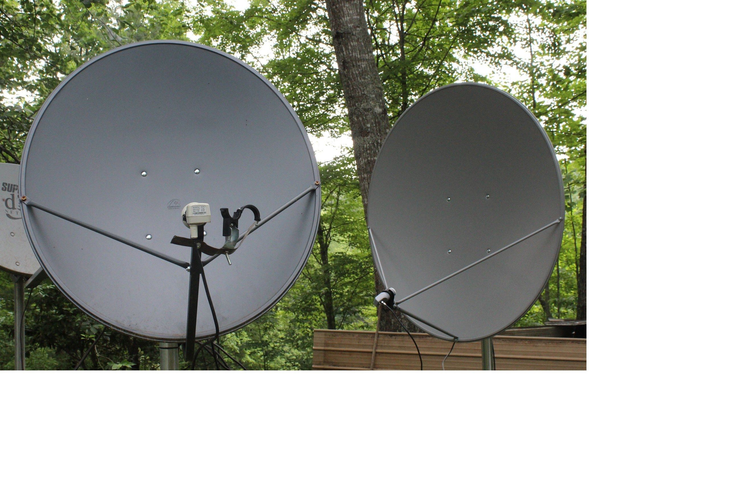

Don't have any promotional photos of the 90cm and 1.2m side by side. Have a few of the install here at home. Will post up over the weekend.

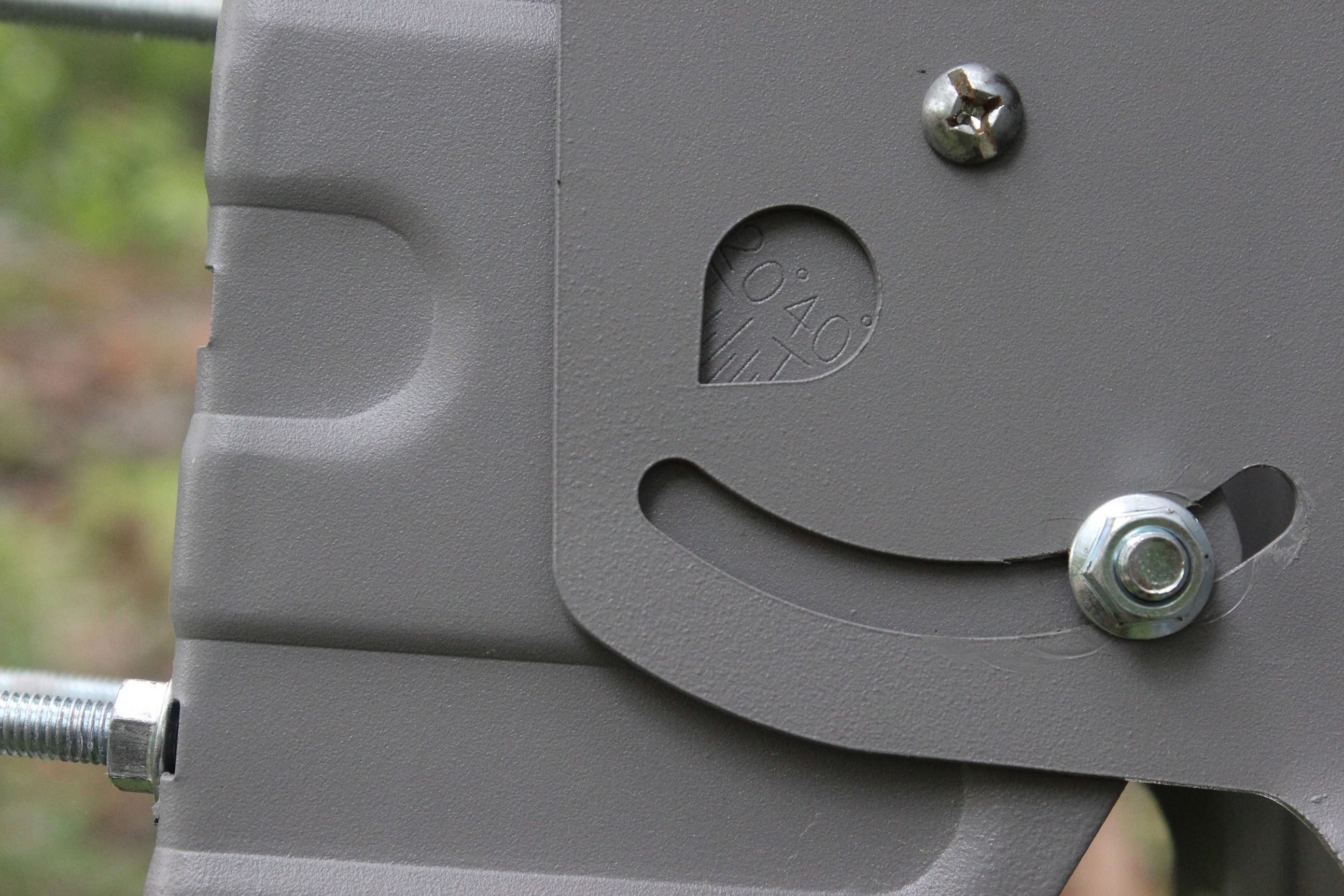

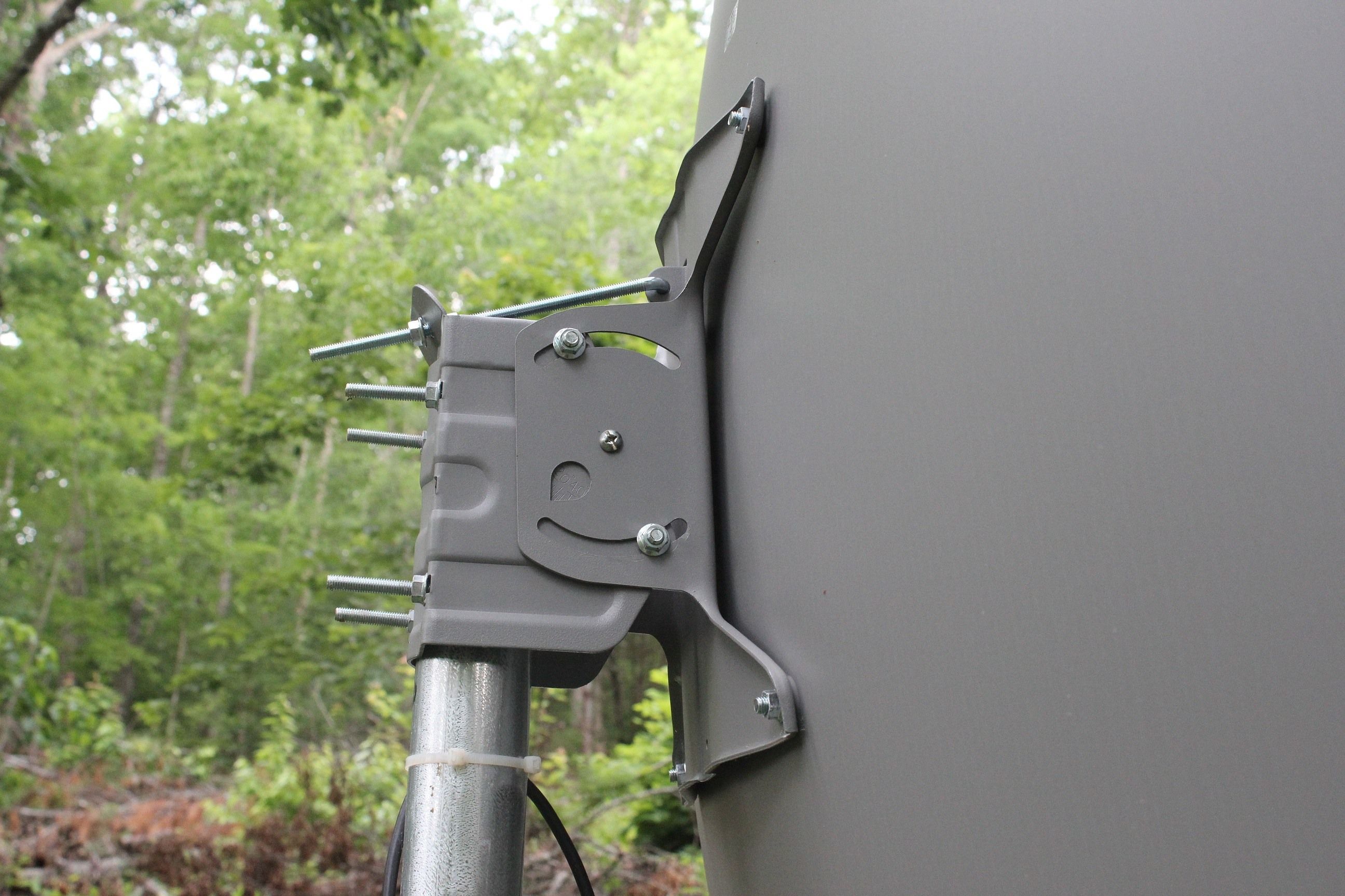

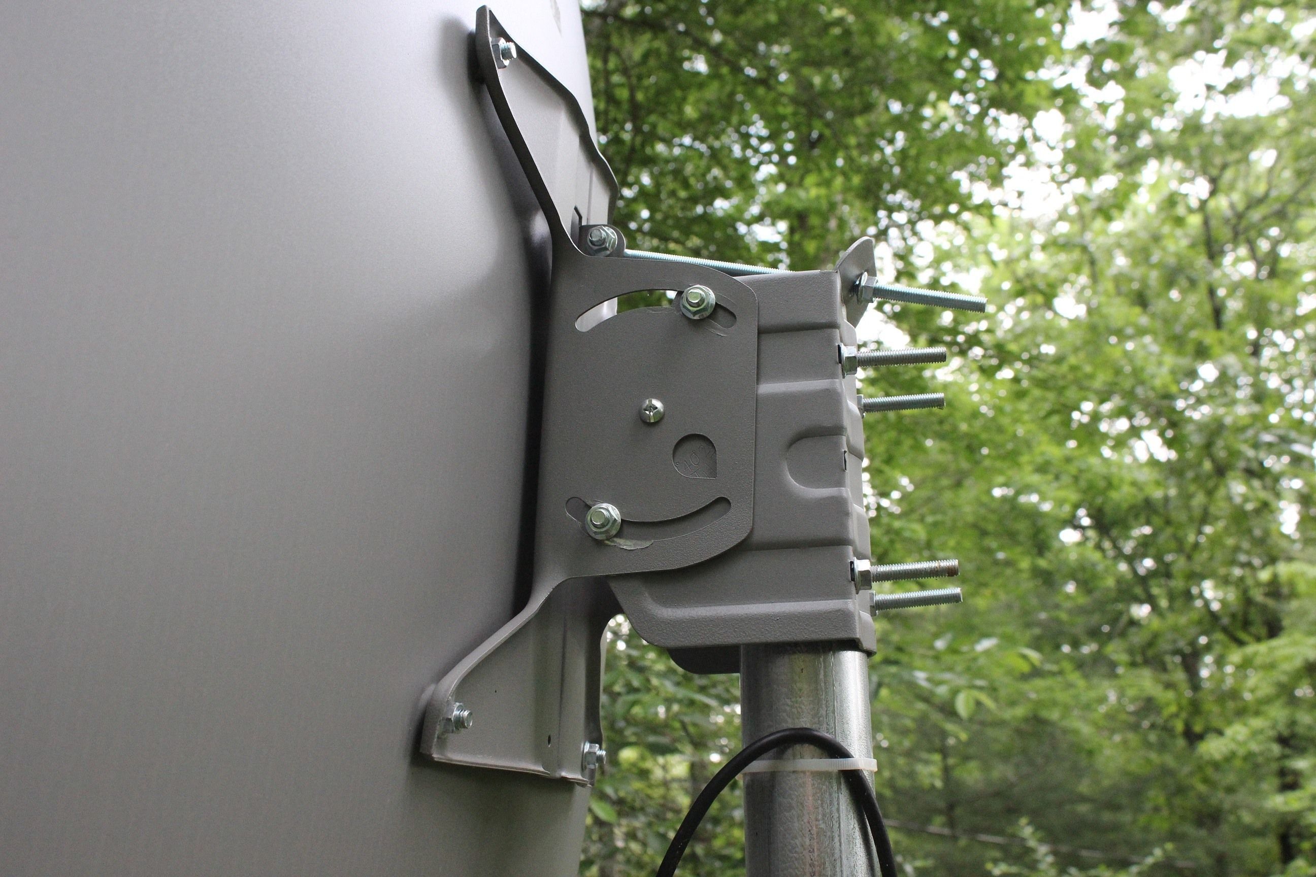

Note: The 1.2m bracket assembly is incomplete and missing two screws installed in the center pivot holes. I'm sure Michael will find the m6 x 12mm bolts on his work bench and finish assembling the dish without the fancy wire!
Fine tuning the dish elevation is simplified with the threaded adjuster. I use it to optimize the signal for my miniBUD, where every dB counts!

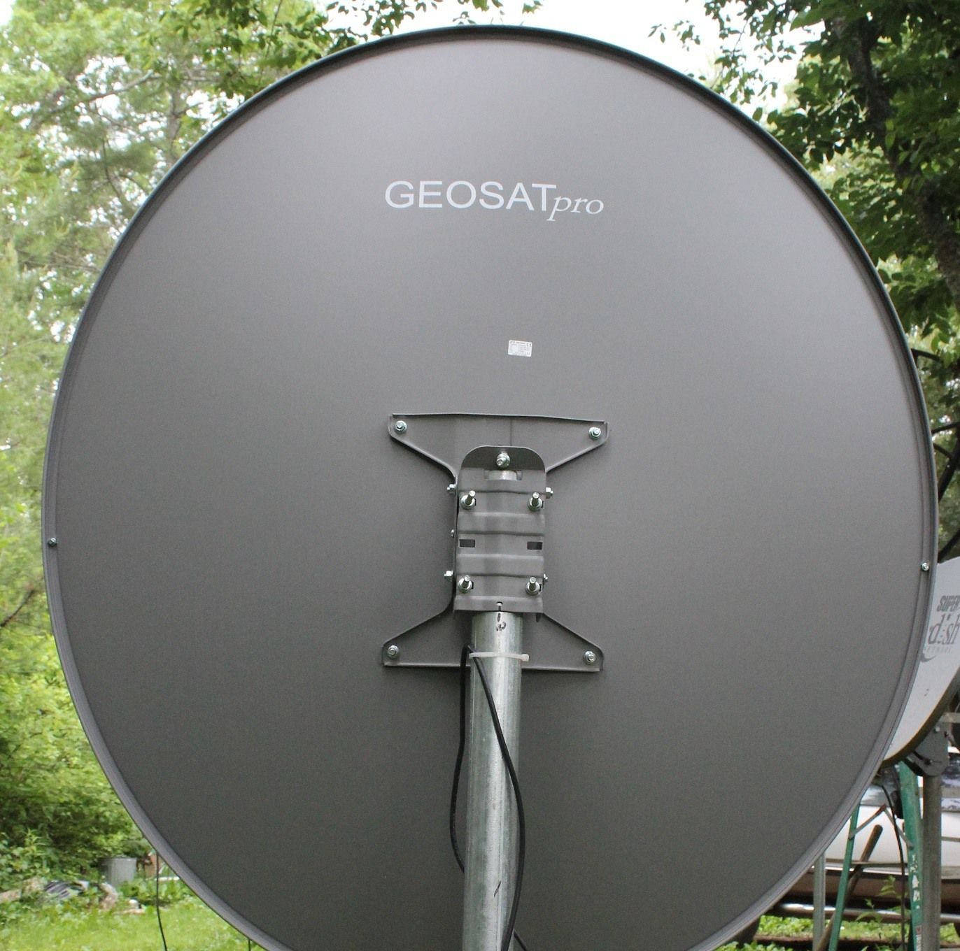

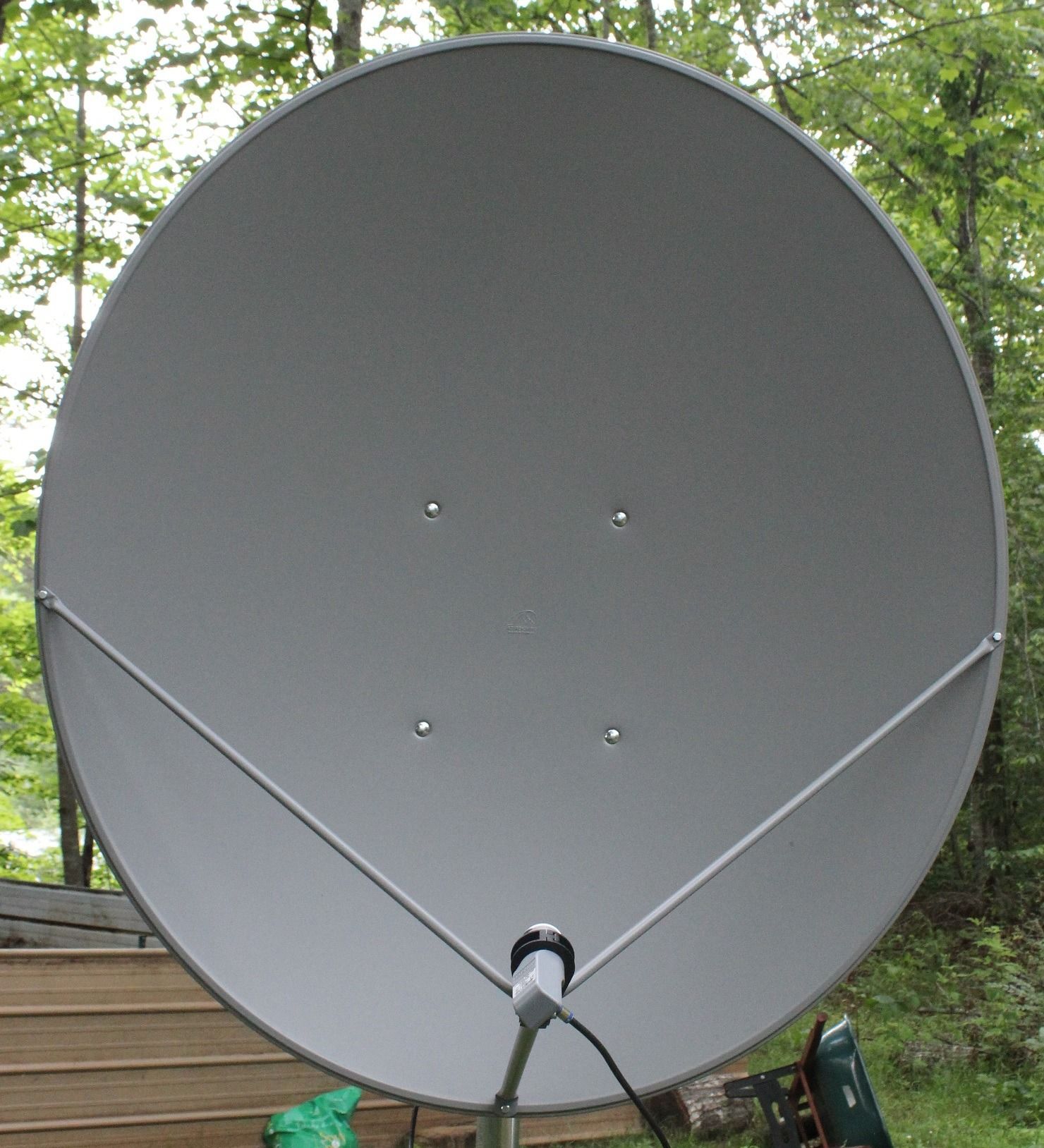

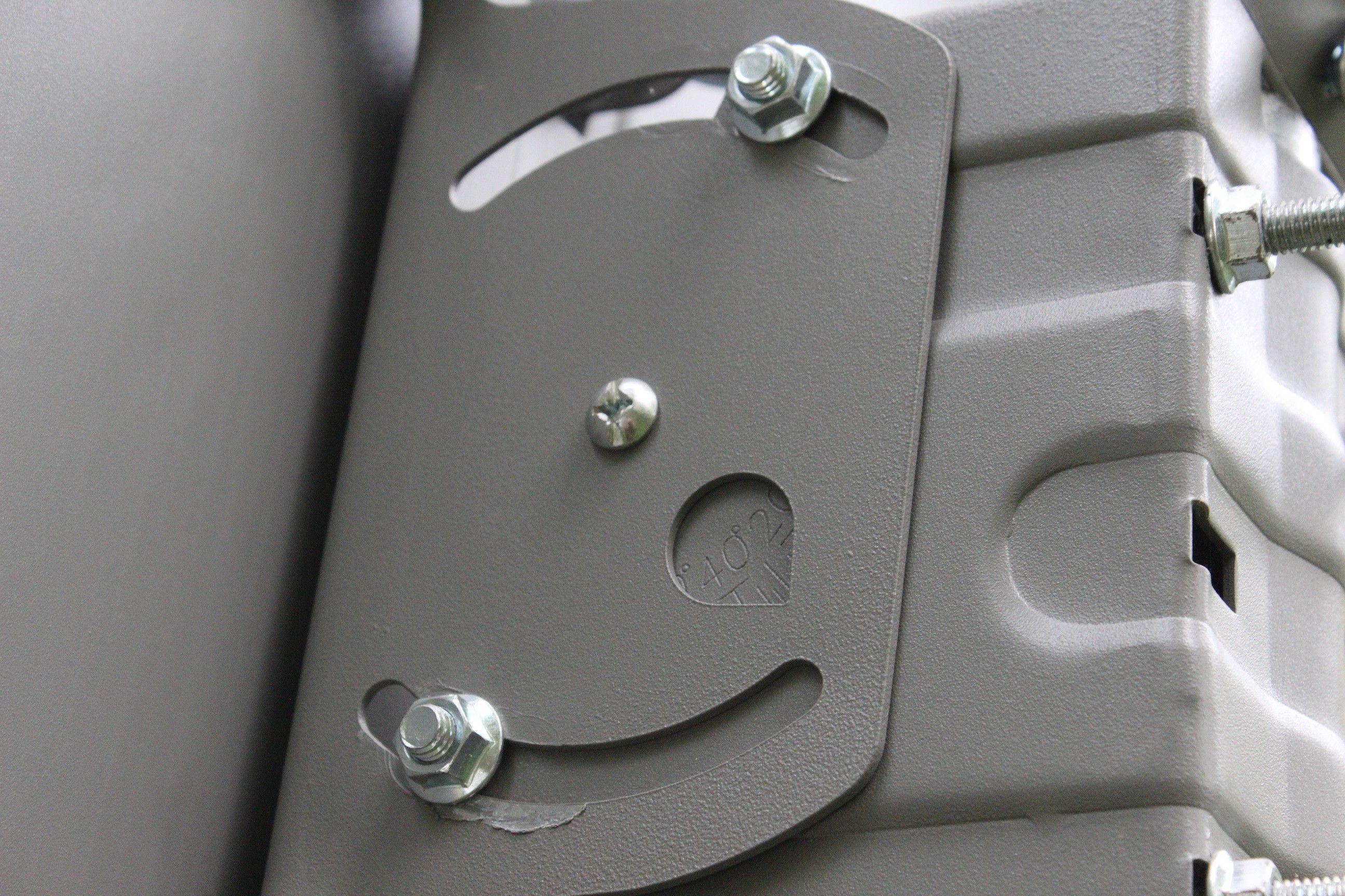

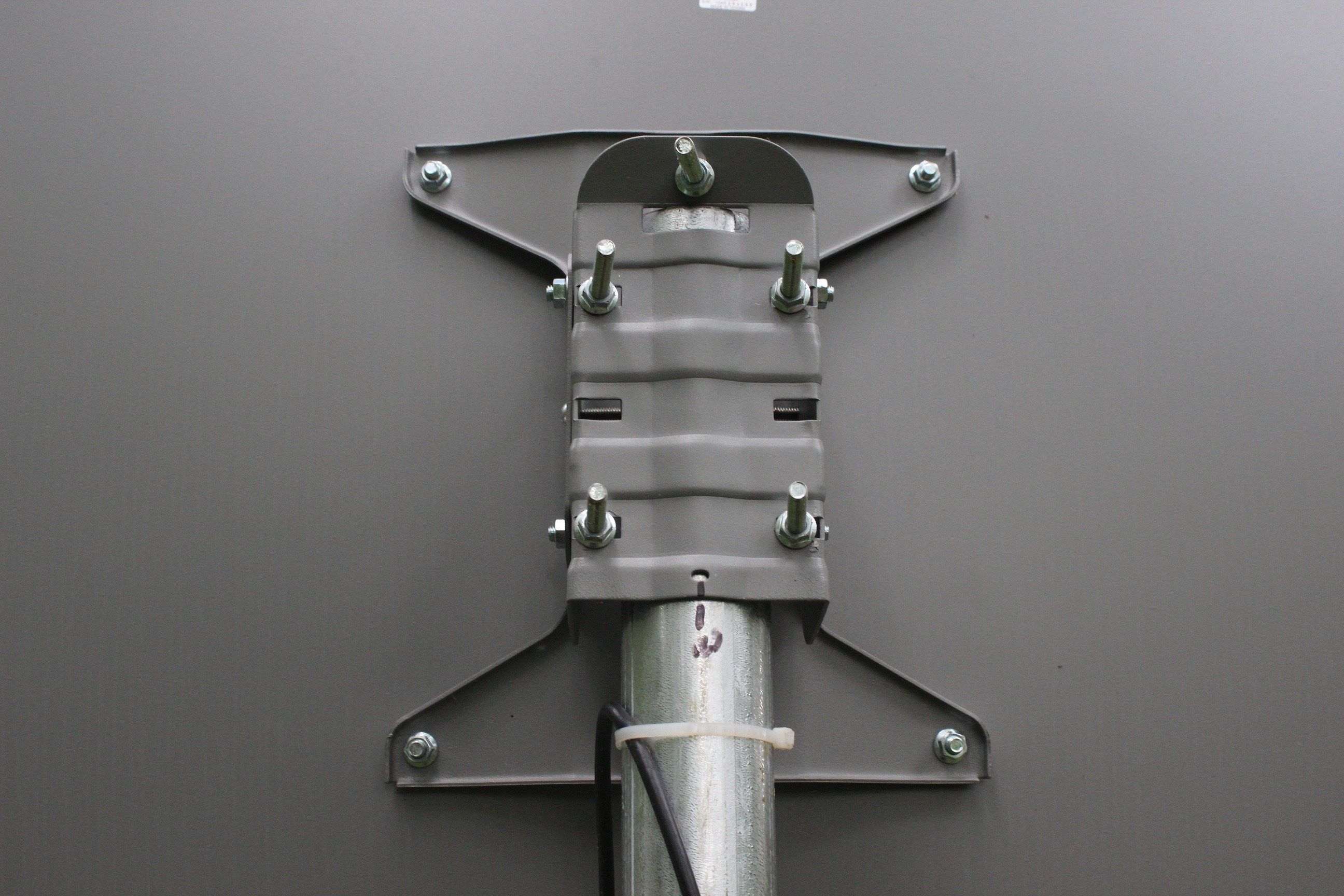

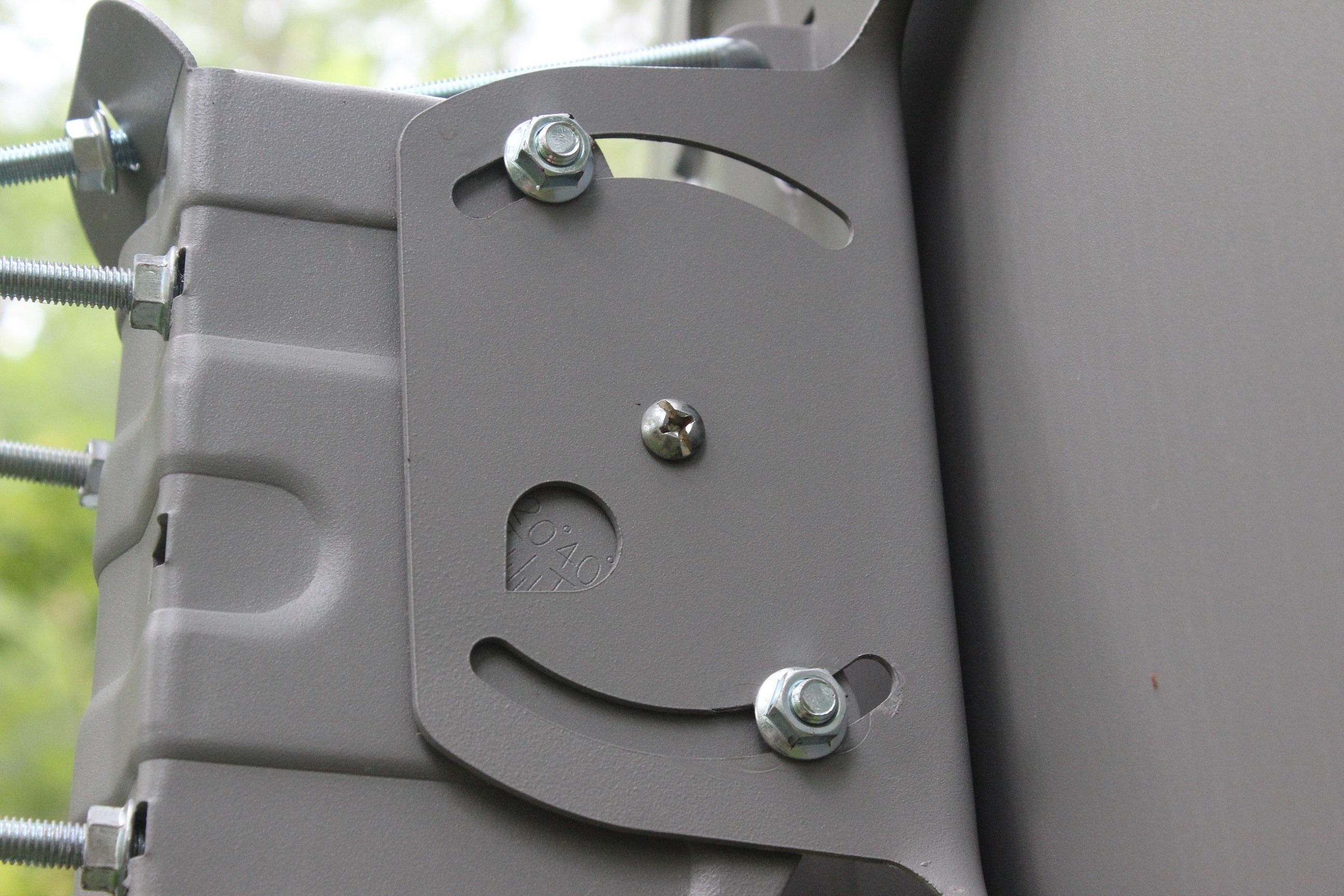

Added some pictures too. As you can see in the photographs the pivot screws are installed ;)
What is the lowest elevation angle the 1.2m can be adjusted to when on a pole? My 90cm GEOSATpro cannot go low enough for AMC21 at 19.5 deg. when mounted on one of poles without being creative. It's fine if using the adjustable J mount it came with when mounted elsewhere.
I should look at the picture before speaking, but...
sounds like you're fixed, so can you just invert the dish?
That's the (a, one) easy way to get to zero elevation. ;)
