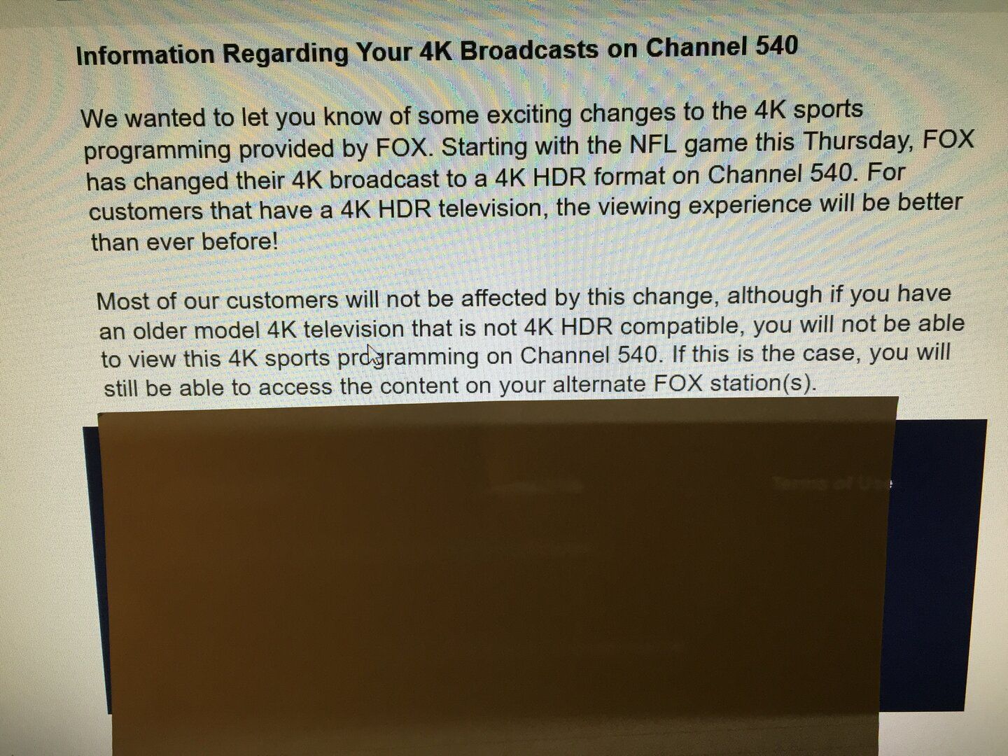

Dish sent me the following email message about ten minutes ago. I hope it helps.
Reactions: charlesrshell
