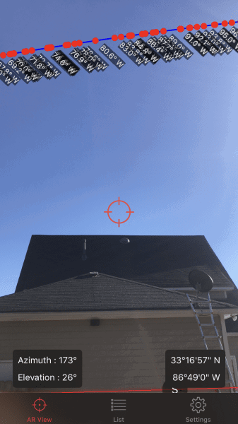

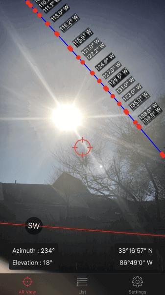

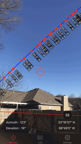

I'm attaching some pictures of Dishpointer app to show what I can see. I basically start getting into trees at 133 and further west, and 30W and further east. Meaning I can see (I think, anyway) 34W to 133W or so. The ladder up to my Dish Network dish was from me repointing from EA to WA
