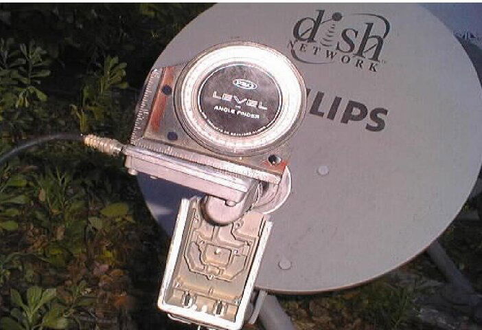

The Level Angle Meter measures 16 degrees (In Calif.). This was for CCTV. Of cource the polarity was off by 90 degrees because I Strapped the Universal LNBF on a gutted Dishnet LNB (and 18 inch dish).
I could also get a few of the feeds on IA5 lin NDTV.
