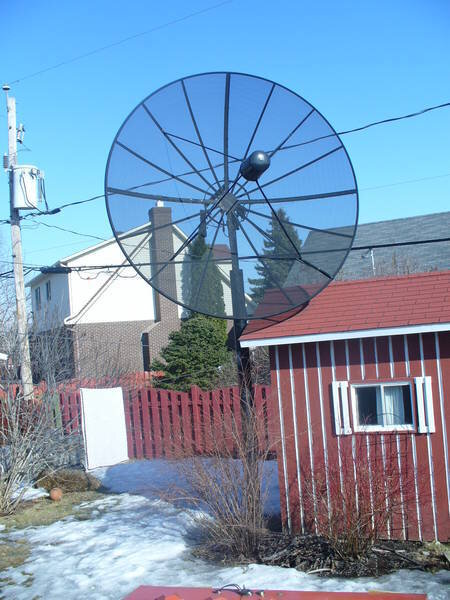

My problems is its installed a bit high, about 12'. I want to know if ist possible to dismantle it on the post and bring it all on the ground that way. How much do you think it weight
one other thing , i want to know if a did a good find, heres some pictures

On a 10' Unimesh, the mount alone is about 30 pounds, and each of the 4 panels is about 15.
And about 15 for the Actuator. So at least 100 pounds.
You can remove the Actuator, then remove the Dish from the Mount.
The hard part is getting the rusty hardware to break loose.
There should be a hole in the center of the Dish, you could feed a rope through that and through the mount, ans lower it slowly.
More hands the better.
First:
:welcome
Congrats on the dish, it looks like a decent one. It looks to be a 10 footer. You will definately need some help, you and a friend should be able to handle it, but I think you should be able to get it down ok. Be careful!
Lak7 has already said the weight i was going to guess 100-120 total weight
i had two people install my 10 fter and it was awkward so if you remove it whole three people is suggested . the mount has to go up about 1 ft before it clears the pole.
so several ways
1) park you truck below dish spin whole dish around and place two boards 6 or 8 inch across bed of truck and two people ( one at each side can lift and lower to truck bed.
2) remove the 4 bolts holding the dish to mount plus the motor connection and lower the dish to ground and then lower the mount. thes 4 bolts usually are rusted up pretty good so use some PB Blaster and probably plan on replacing the bolts.
3) use a sazall and cut the pole close to the groung 2/3 way through and push the dish over with one person holding the dish. ( main thing is to recover as much of the pole as possible for re-use)
remove the pole and reuse easy way to extract is to disg dirt from one side and bump the pole ( with no dish on it ) with the truck bumper . it should push the pole out or over.
main thing is to be safe and :welcome to the group
good find and be careful with older mesh some of it tears easy or is easy to bend.

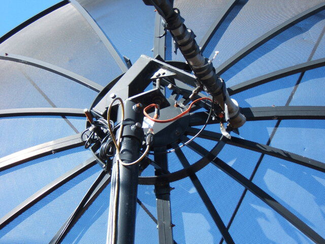

Wabo the 1 thing that, I would do on this dish is mark you're 4 pie pannel to go back together the same way they where taken apart, just take a screw driver an scribe a 1, 2, 3, an 4 lines where they bolt the pies together. now most of the time this is not needed, but after looking at you're pictures, I would do it on this 1, for the guy that bolted this 1 together over tighten it bolts, you can see it where the pies are bolted together with its crush marks on the square alum box tubing.

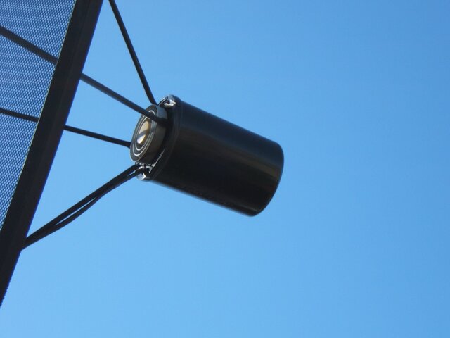

I opened the cap on top of the feedhorn, to find a califonia amp C/Ku linear feed. is it a good quality piece to start with? Its marked as a Startrack dish, anyone know anything about this brand?

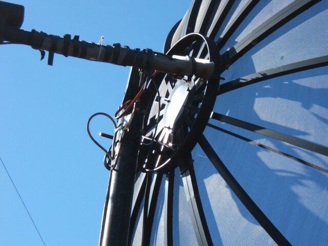

a few other question, is the vonweise actuator i got with it a good one, or should get a new one. It gets its power from something that looks like a extension cord including the plugs. What should i buy for this 10ft dish.
What could be the expected arc i should get with it, it will be installed at 71 3''W and 48 24''N. Is the lenght of the actuator have an effect on the range of the dish?
thanks for all your inputs it went really great!!!
Mine is a Startrak, its a good dish, mesh is on the small size so it works well with ku. The c/ku feed is certainly a bonus, you don't usually find those on older dishes. Von Weisse is a top of the line actuator, you might need to take it apart, clean it up and grease it but try it first, it might be fine. It looks like they had heat tape on it to keep it from freezing up. I would suggest getting a rubber boot for it or whatever arm you eventually use, it will keep water from getting in and it won't freeze. It looks like a 24" arm, same as mine, I can sweep from 58 degrees to 137 degrees with my setup but it really depends on your line of site what you will be able to see.
It looks to me like you got a good one!
