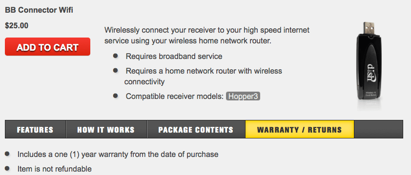

Really? I got it from the Dish store after we got the H3. Their ad says "Compatible receiver models: Hopper3". It also says "Item is not refundable". Well F me.
If WiFi is built in, why would you need one? Are you saying that on prior models, the Adapter gave you better network speeds than the built in WiFi?
I don't know. I used one of those on my Hopper 1. It sits it the drawer with my H3. I would try it without it.
