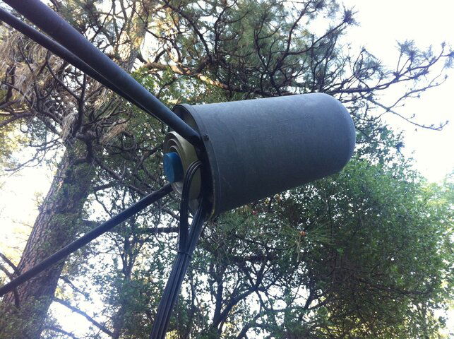

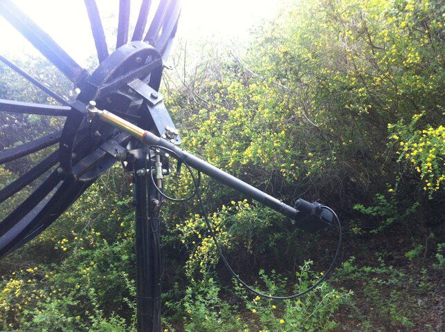

Ok here are the pictures, the device says Homecable on it

In pic #1, the domed cover is removable, a picture of what's under that cover.

Ok, i looked under the cover and theLNB is a Chapparal C-Band model. It's a little confusing to as the old line had a 2 double coax setup
and this only has one connection. I am assuming everything was working before hand but may need a new LNB.
Was looking at trying a DMX741. I did buy a sat finder to test things before I buy and start taking things apart.
Other than using the Sat finder, how do you test a unit to make sure it's still functional?
What is the receiver model? A new LNBF will not with an older analog receiver. .
BITD, Satellite ribbon cable had two coaxes. Used for dual band or just a 'spare'.
Checking the coax: put the meter in the coax line near the lnb. Short jumper to LNB. Should get an indication of power. Use the receiver to move the dish. Should see meter needle rise and fall.
I am thinking it was dual band beforehand and they updated to the chapparal model at a later date due
to digital conversion
