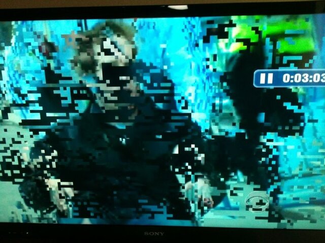

Is the issue experienced on both SD and HD?
Video is more noticeable on HD than SD, but yes, have seen this on SD. PIM me and we can work out a way for me to send you sample videos.
· Is there a specific time of day you experience the issue?
Evening news broadcasts are particularly bad. Prime Time shows also bad. Have also had this happen during NBC morning NHL broadcasts. There is a 6 hour time difference to the east coast, so the NBC NHL is usually on about 6:30AM. However, this will occur during all hours, perhaps not quite so frequently. Don't watch networks too often during daytime hours.
· Is DD 5.1 being offered during regular programming on SD or HD? Can you provide specific examples?
Have not noticed DD 5.1. Guide says news is in stereo.
