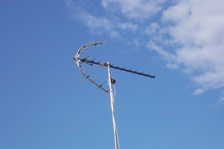

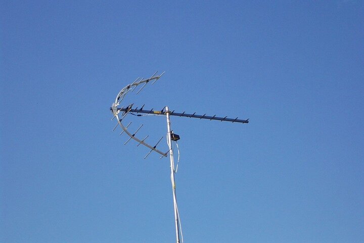

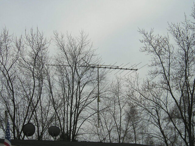

Just installed the hd7082P combo for the parents. see picture below. do not need to mount real high. if you get a bad storm you take it down temporarily.

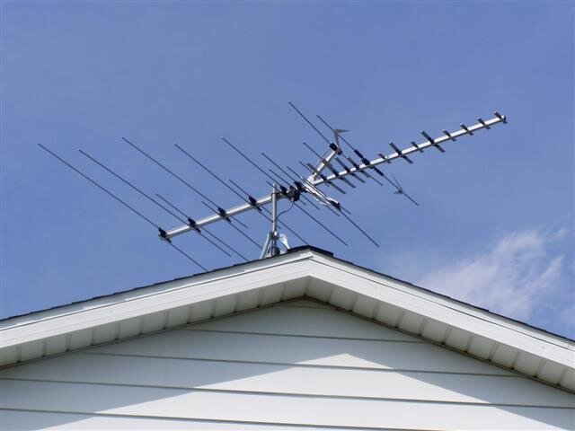

Rick:
here is a few photos of my nearly 20 year old winegard antenna that i was talking about. have you seen this model before?
I am not familiar with that antenna.

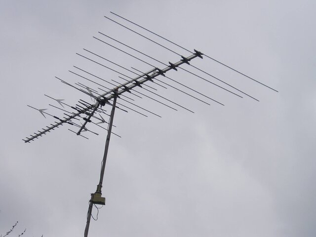

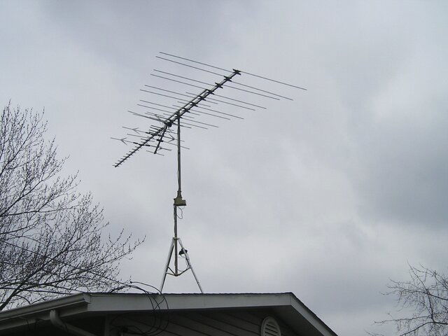

Jim5506 said:
Do you have a ceiling mounted projector? 'Cause that antenna looks upside down!!
Hey Jim
i have to agree with you,that antenna does look like it's upside down.

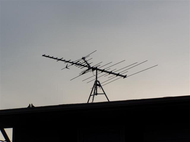

Dodge:
you have a picture of your 25 year old antenna? took mine down yesterday to try the old ( lightly tap the rivots to knock corosion off ) and i have about 5 or more lose elements from the large crows and a couple of Owls that have claimed the antenna as their sitting area
