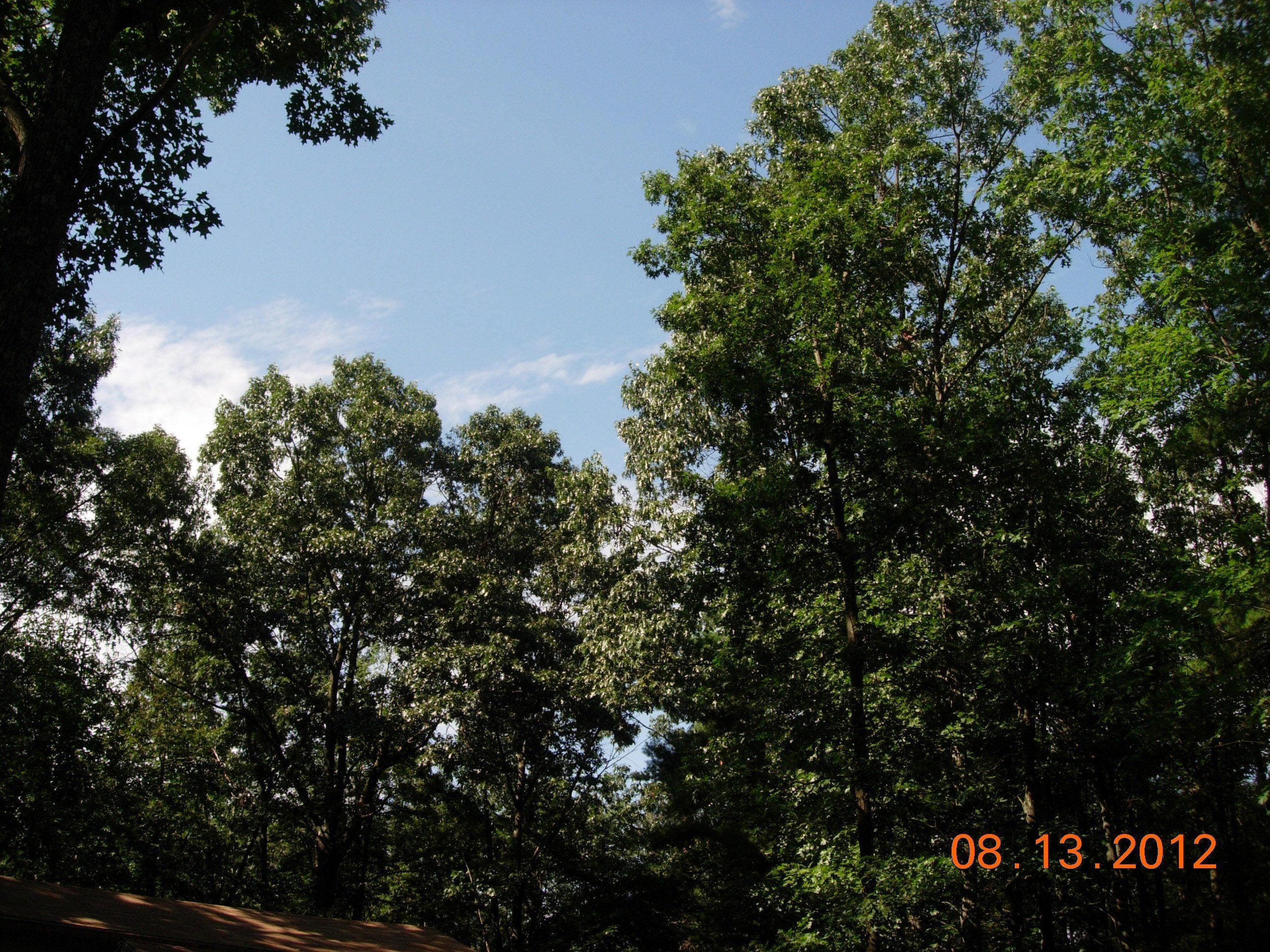

The compass heading for the 101 sat in your area is about 224 degrees. Can you post a picture of that from behind where you want the dish to go?

Here is a shot looking 224-225 degrees. The signal comes in when the satellite is positioned toward the v just to the left of the righthand trees. Do I have enough room for the HD signal?

Directv requires us to have a 10 degree window on all sides so that's prolly why the tech refused. As for the picture, I prolly wouldn't touch it either but pictures don't always tell the complete truth of a clearing IMO
The HD signal comes from around 101W so that shouldn't be an issue (unless you subscribe to Spanish language programming). If you do away with the SD equipment, they may be more interested in setting you up (again, unless you subscribe to Spanish language programming).
From your photo, your situation is not promising in the long term. DIRECTV's rules that they give to installers are pretty persnickety about the long-term viability so that may also be a concern.
It does look rather close. Without the satellite positions overlaid, it's hard to say for sure. Since your local sd channels are from 101, you only need 99, 101, and 103. A local independent installer might do it for you.

I am thinking that by putting the dish on the back side of the house instead of the front yard and removing enough trees I might be able to get clearance for the HD service.
BINGO! By moving the dish to the farther side of the house, your tree clearance issues should go away. From your picture, I think you original location may work, but moving it to the opposite side of the house should be just the ticket.
