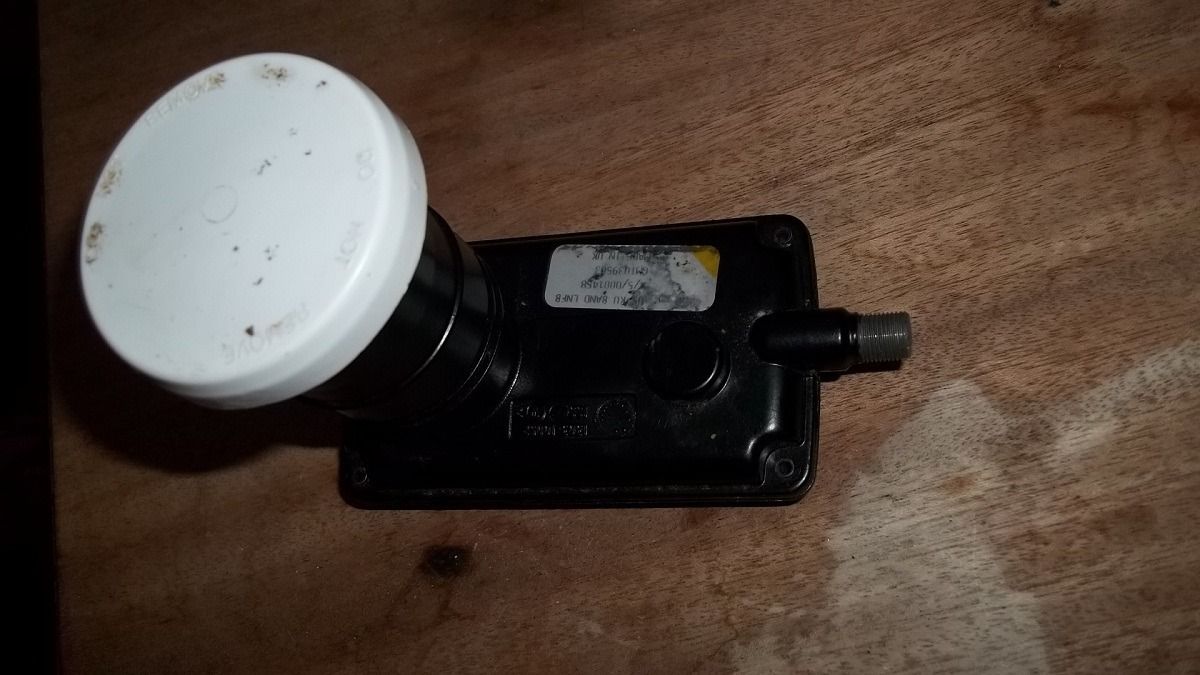

i need help identifying an LNBF. it has a sticker but i cant read all of it, but ill try my best to describe it.
it is a KU type made in the UK. has the following numbers on body 1303-10052 then on the neck right before the eye part it has this number 10102 V2
the sticker has this (as far as i can tell) K/5/0001458 dont know if that part number, stock number or?
next it has GMT039503 (last number could be a 6 or 8 dont know for sure, sticker ripped there.
i guess i would need to know the freq and hz most importantly to get my system set up. (coolsat 5K).

If its made in the UK more than likely its a Universal
Use Universal 9750/10600 as the LNB Freq
Searching turns up that this is an Amstrad SLB1
C&P:
SLB1 is single band output unit with 10 GHz LO that was designed to cover 10.95 - 11.7 GHz
so it wont even work here then since he needs it to go to 12.2
it basically covers low band (10.7-11.7)
C&P:
Sounds about right may have been used for the Eutelsat or Arab programming birds since they use those freqs.

Any lnbf will work for analog and digital. The part of the band of frequencies that lnbf is designed to receive is 10.7 to 11.7 Ghz. (used in Eu, Aisa, the Mid East) The part of the Ku band used here in N.A. is 11.7 to 12.2 Ghz. So it won't work. A Wildblue dish and LNBF will work, although the dish is smaller than the recommended minimum size. Although it may receive some of the stronger transponders. The settings for the Wildblue lnbf should be Standard, L.O.= 10750
