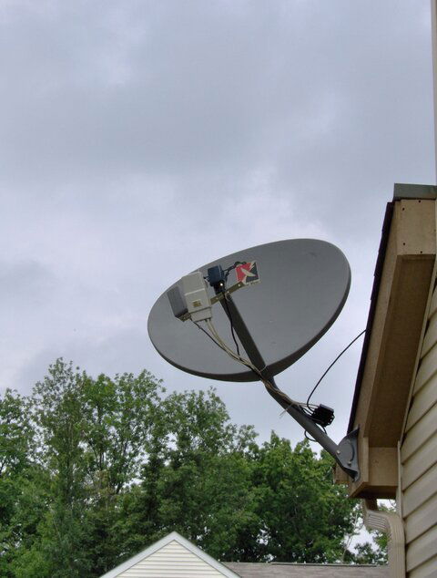

My first FTA setup started out with a Fortec 80cm dish, Invacom Quad (QPH-301), and a SMD312 motor. This connected to my current receiver (Fortec Classic NA). Since my house faces true south and I had no desire to mount it in the front yard, the roof was my only option. Carefully, I was able to use the mount that came with my 80cm at the peak of the roof, as far back as possible (pic included). Due to the difficulty of trying to mount on your stomach, I was able to get it as level and plum as possible. Due the the size of the dish and motor type (connecting arm facing downward), I was having probs with the dish hitting the roof as it rotated. I was able to resolve this by adding a pipe ext to the mount, but it did mess with my aligment a bit and loss signals at the far west and east SATs (good from 43w to 121w). As most of us have come to figure out, the dish size was a bit too small for my tastes :). I ended up selling the dish and motor and bought a Fortec 1.2m dish w/HH120 motor to replace it. Prob is that it didn't come with a mount.

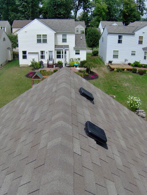

Pic 1: View of the roof from ground level from the backyard. Front of house faces straight south.
Pic 2: close up view to a possible eve placement for mounting the dish. gutter would have to be trimed a bit and probably would need a tall pole (5 feet) to clear the front roof, but would prevent from drilling into the roof itself

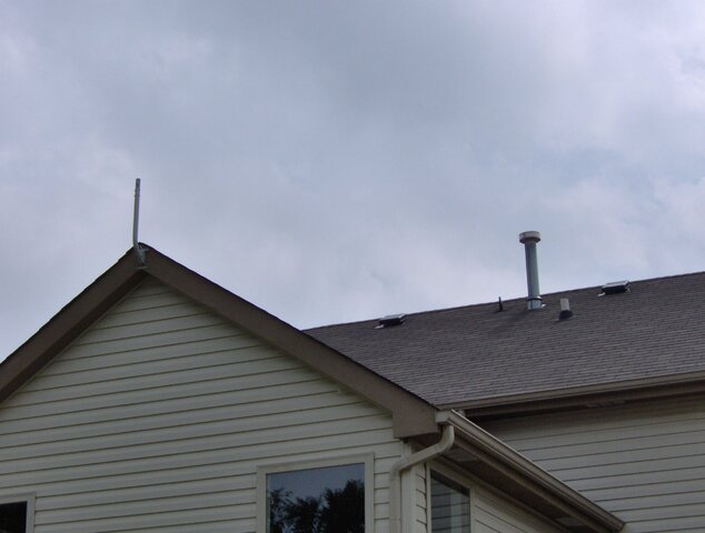

Pic 3: current dish I have at the rt side of my house (if looking from the backyard). Invacom is at the 91 for g11 and nimiq, fortec universal (blue) is at AMC3 (101) and the grey DTV lnb is at the 82.

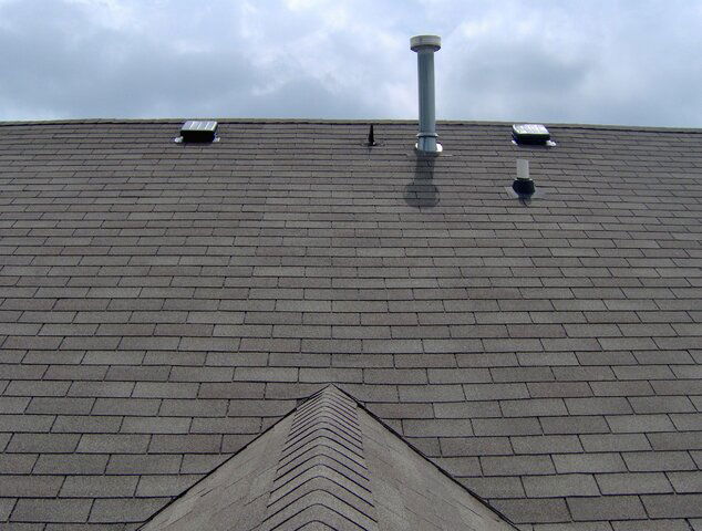

Pic 4: view from the top of the back roof (about half way) facing true south. The front roof is aprox 17 feet in length to the top and is at a 30 deg angle. I don't mind mounting on the front roof as long as I can't see it from the front of the house.
Pic 5: a 180 deg turn from Pic 4. Old 80cm mount is visable at the end of the roof. If the eve location from pic 2 wont work, I'd like to mount the dish somewhere in the middle of this roof. Far enough back to stand behind and align, but close enough in to hide the dish a bit. (old 80 cm dish was a real eyesore). With the HH120 arm facing up, it should add a little height for the dish. The rear roof is at a 32 deg pitch, so a NPM is not possible (all the ones i've found max out at 30 deg).

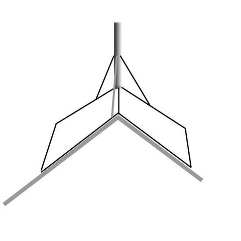

I did a roof mount on my 1.2 dish and I think if you do a search on my posts you will be able to find some pictures of my install.
Over the years I have monted many Non Pen roof mounts that have been custom built for the peak. Make sure to use a pad and weight the Non Pen with cinder blocks.
A local fab shop charges about $150 for this configuration with 1 5/8" - 2 1/2" post.
See drawing below ....
A NPM would be ideal. Most of the NPM's i've found max out at 30 deg peaks. Are you saying that these can be modifed? I need one for a 32 deg pitch. Would it be really hard to modify for the extra 2 deg needed?
