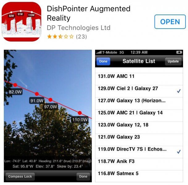

Do you have a smartphone? It might be well worth your time and money to get the DishPointer AR App so you can locate the Dish satellites in the sky.
I don't know that the Pro version gives you anything extra that the Augmented Reality basic version does.
Dishpointer may show you holes in the tress but what are you pointing with? The dish arm does not represent the signal path to the satellite.
If you position the phone with the App at the location of the dish, you should be able to determine if the satellites are behind the tree or if lowering the dish by a few feet was enough to shoot under the tree.

My response about the App may not work, though, since it hasn't been updated (at least on the Apple App Store) since 2011. But if you can get a sense for where the satellites actually are in the sky (and like you said, the arm does not point at a satellite but somewhere between the two or three satellites). It may be the side of the house is not the best place in the long term for the OP's dish.
