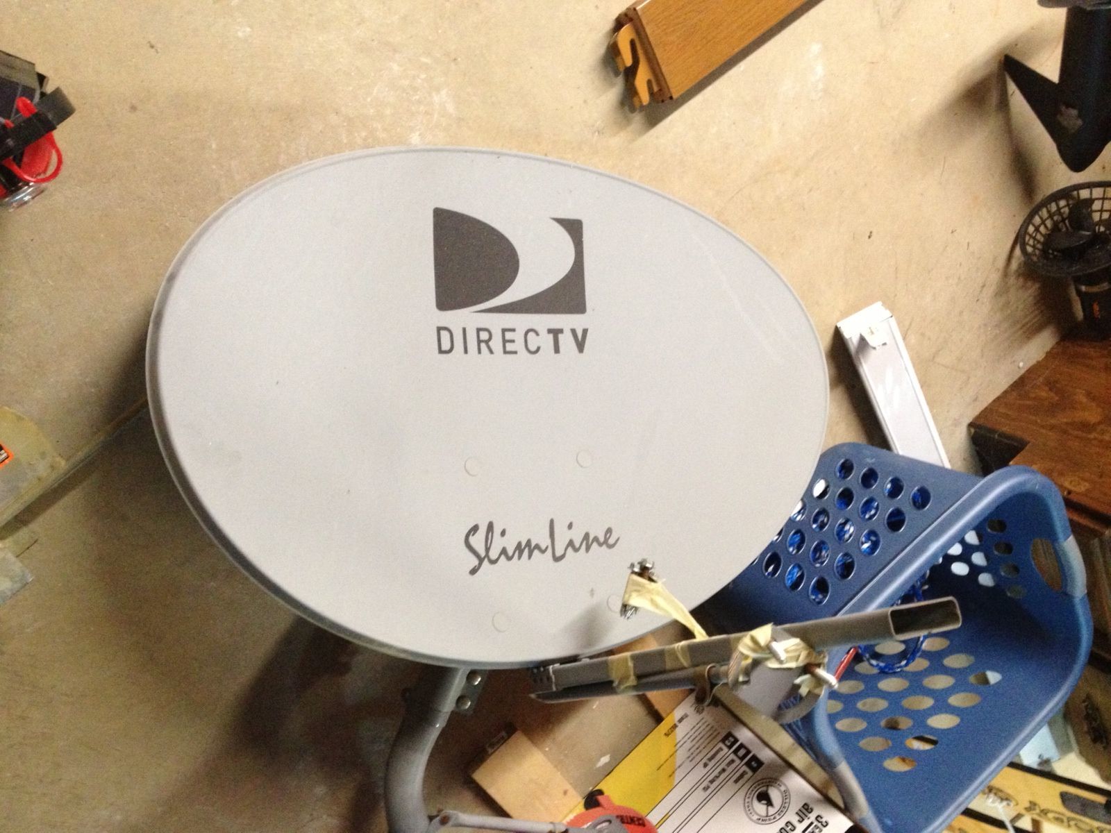

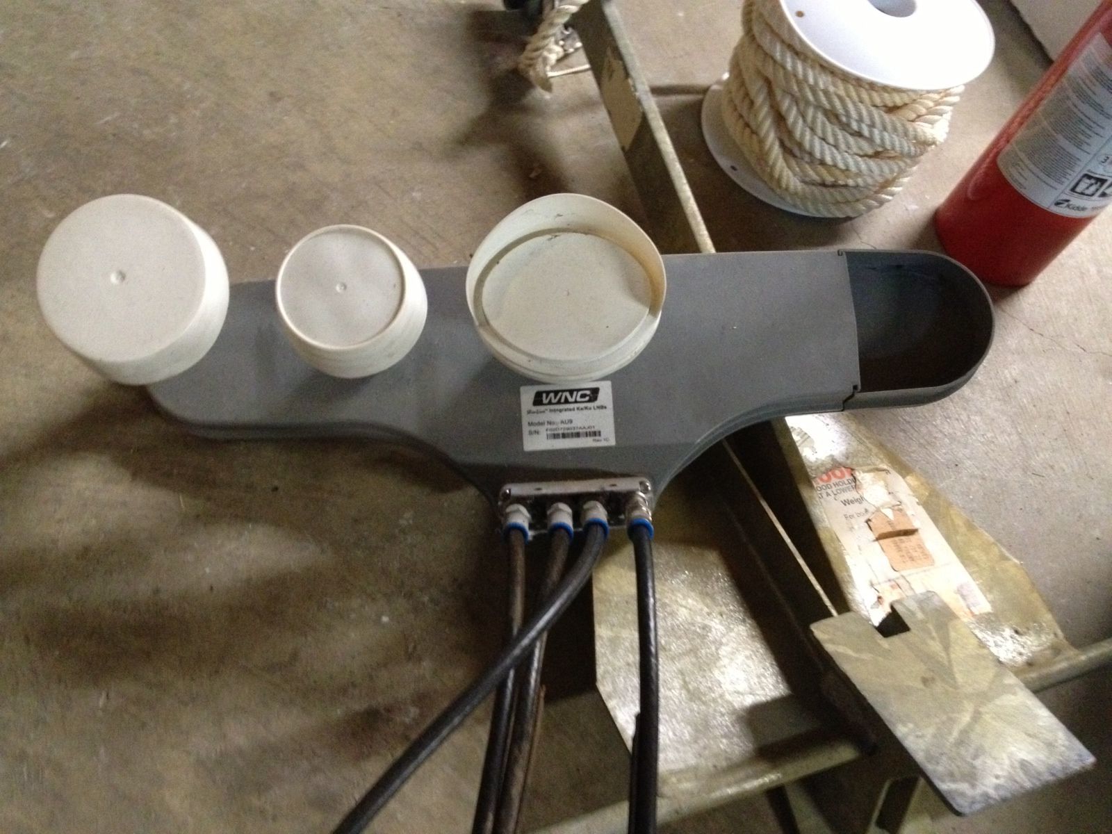

I have a vacation home where I want to bring back and forth my HR24 receiver. I think the extra dish I have is a SWM with the 3 style LNB? See pictures below.
Do I need to buy a single LNB now that I only need one cable in or can I use the existing dish as is? The installer at my primary home said I could use the existing dish but just one cable. If that's the case which do I choose? Or, do I need to buy:
DIRECTV SL3-SWM SlimLine Single Wire Ka/Ku Triple LNB With Built-In Multiswitch
I am also wondering which power inserter I need and if this dish will even work. I need a run in excess of 100 feet so do I need the unit with 29 volts vs. 21?
After reading some of you valuable threads I think I might also need two BBC converters no??

Ok, now, is the dish in the picture the one your gonna use ?
IF you use that one WITH the LNB you also have pictured, you only need to hook up to 1 of the ports, also DO NOT use a Power Insertor, the recvr should power the LNB.
This dish is a Slimline, but NOT a SWM (Single Wire Multiswitch), so you would run multiple coax if you need more than one recvr.
For a single recvr this is a great way to go.
Hook your coax from one of the LNB post, to a ground block to the recvr and point the dish and your good to go.
Make sure the post/mast is level when setting up the dish.

OK. There are a couple of things you need to consider.
First, the pictures you have are for a conventional slimline HD dish install. The standard LNB is powered by the receiver and does not want a separate power inserter. But, you also mention that you want to put the dish about 100 feet from the receiver. You really need to seriously consider a solid copper center RG6 coax for your installation. Copper-clad steel core wire might have too much resistance to power the LNB for that distance.
Second, to get the full functionality of your HR24 you need to run two wires from the LNB to the receiver (one for each tuner) to be able to record a program while you are watching another form the dish. So, that means two coax runs from the dish to your receiver.
Also, if the dish you have at home is a SWM setup (most common with HR24 installations) you will probably encounter issues changing the dish type settings in your HR24 receiver. Many have reported that they were unable to switch back and forth from SWM to non-SWM setups. I know that the installer for my son-in-law's move was unable to get his HR22 to switch from standard to SWM and consequently replaced his HR22 with a new HR24. So, even the pros have difficulty with this transition.
While not showstoppers, you need to consider these issues in your vacation home installation.

My bad, I forgot you were using a HR, so Yes you would need 2 lines brought to the back of your HRxx in order to fully use the functions of the recvr, also, you'll want 2 BBC's, they are used with that dish you showed, but Not with the SWM set up.
Yours is a Slimline set up.

If you are going to leave the DVR (don't call the HR24 a receiver, that just confuses things) at the vacation home, you have two choices.
Choice 1: At the vacation home, you currently have a non-SWM dish (I assume it is a slimline). Run two cables from the dish to the HR24, get two BBCs from DirecTV (just call) and connect these to the back of the HR24 between the HR24 and the cables.
Choice 2: Get an SWM LNB for the vacation home. Your home dish is an SWM5 SWM so you should probably get that LNB (Note: you might not need the 5LNB but without knowing your zip code and what channels you subscribe to we can't tell you). So an SL5 SWM LNB, with it's associated power inserter. Replace the LNB in the vacation home dish with the SL5 SWM LNB. If you are careful you will not need to do a realignment. Run one cable from the dish to the HR24 (the dish will only have one output) No BBcs needed.
At 100ft+ you should use Solid Copper Core RG6 not CCS. Shop around on the web to find suppliers. You do not need quad shield.

OK, at home you have a slimline 5 (three "eyes") because your SD locals Providence DMA)come from the 119 satellite and a slimline 3 does not see 119.
Your locals (both HD and SD) are carried on "spotbeams", think of them as flashlight beams pointed down from the satellite aimed at Providence. Once you travel outside the spotbeam, you will not get any locals. That means at your vacation home, you almost certainly will not get HD locals (HD spotbeams are much narrower than SD) but you MIGHT be just inside the spotbeam for SD locals. So you will need a slimline 5 either SWM or non-SWM. If it were me. for simplicity I would get a slimline 5 SWM LNB and power inserter for the vacation home dish even though it's a more expensive option, then you can take any of your receivers/DVRs to the vacation home without having to switch between SWM and non-SWM.
Note if you can't get your SD locals because you are out of the spotbeam you won't be able to get ANY locals, or the national channels of ABC/NBC/CBS/Fox, at your vacation home. If you were there for six months, you could get DirecTv to switch your service address to the camp and then you would get whatever locals are available there, but you can't do this switch if you go to and from the vacation home several times a year. You might be able to get them using an antenna connected directly to the TV but I am not sure if reception at the vacation home will be acceptable.

The SWM and non-SWM LNBs align the same way; they are in fact identical except for the SWM electronics.
I think I would go the SWM route. It has the advantage that if you ever need to bring a different receiver/DVR from the house, the house and vacation home would be using the same system so need to change the setup.
Don't forget for the SWM LNB you need the power inserter. But no need for BBCs.
