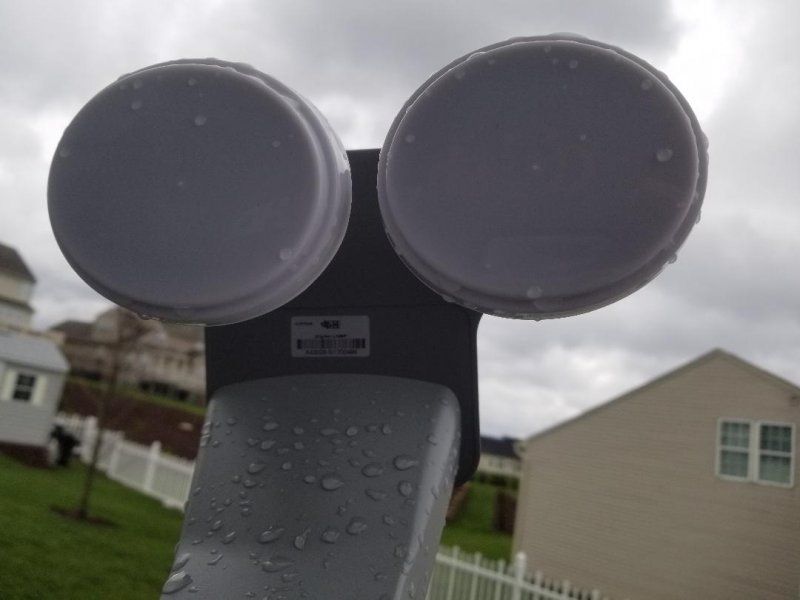

I think this is the DPP if I compare it to something on ebay. Not the hybrid. Only one cable out to house. How would I know for sure? I think that I understand it now... It just becomes a matter of ecomics. I have another year and a half with the dvr for $10 a month before it becomes $15. So as long as it's not a big pain to start/stop service on the Wally, I think that the only time it would make sense to use it would be to temporarily add another receiver at home (kid home for summer) which would save me from adding then returning a Joey. Right? So the more I talk about it... the less it seems worth it to put too much effort into it.

That's a Hybrid dish. You can tell by the "DPH" on the sticker in the picture. "H" is for Hybrid. If you had a DPP dish with a switch, there would be two cables from the dish to the switch.
It sounds like your best option would be to buy a Joey and activate and deactivate it as needed. You won't need to install a second dish this way.
