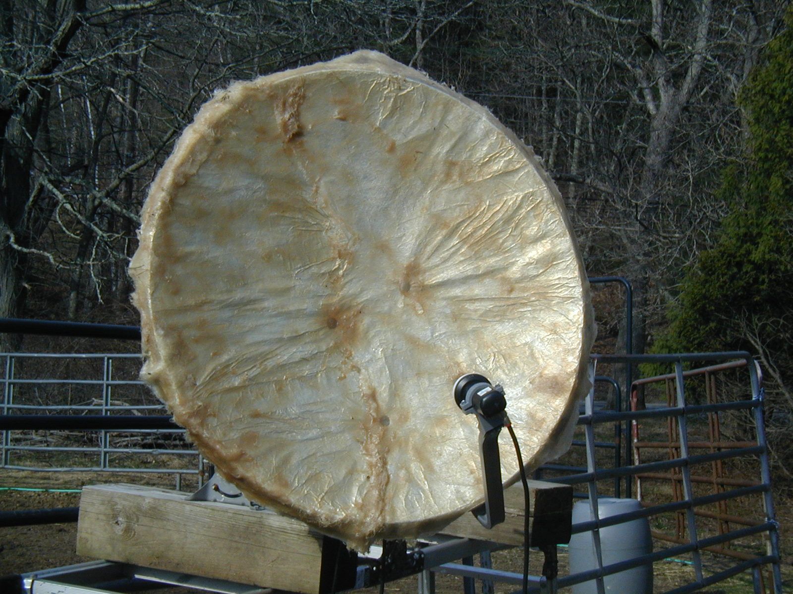

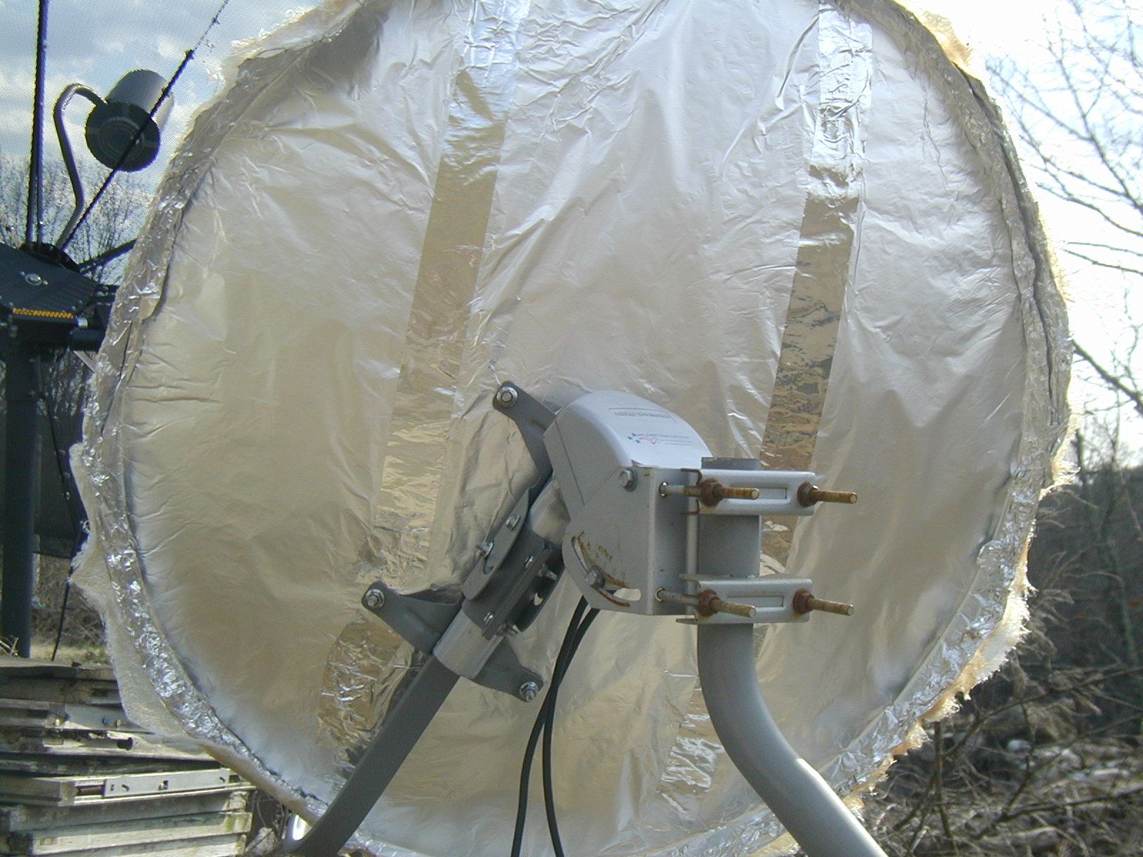

Here's a few pictures of the Ku dish I made from fiberglass and tin foil. I actually found a good use for it, the SG2100 motor I have is too weak to move the steel dish but it moves this one with no problems, the thing weighs maybe five pounds, if that. It's not finished yet, I have to take the platter off and cover the backside with fiberglass and then sand it down [a lot] and paint it, so it's not quite so ugly!

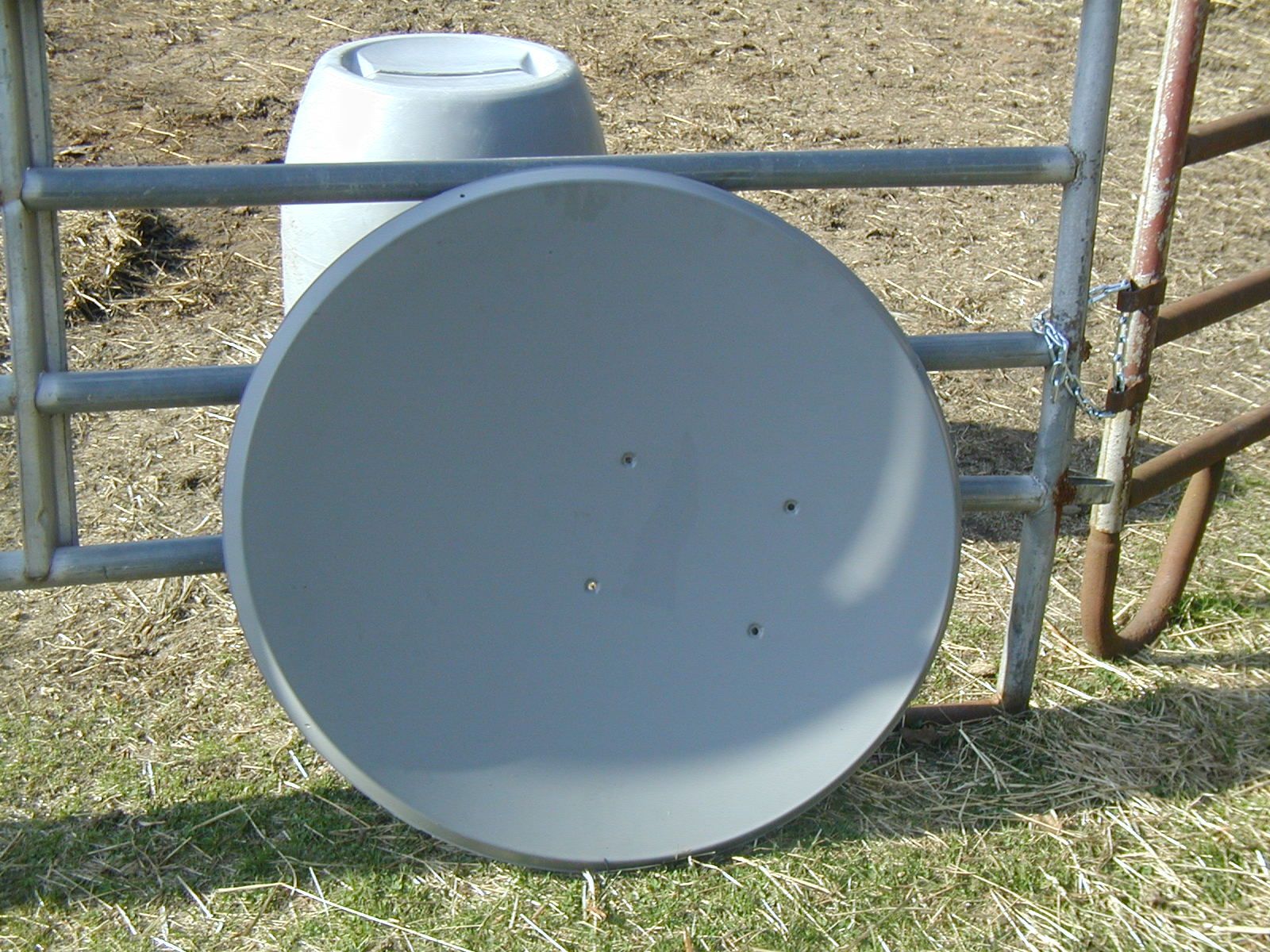

Here's a picture of the platter I used as a mold, from my 76 cm Winegard dish.
Surprisingly, the ugly dish works a little better than the steel one did.

The fact that the reflective surface is in no way as smooth as the original dish gives some credence to the fact that dish surface conformity, at least for the Ku band is somewhat overrated. Thanks for the info A Raine, now I can save $ on sanding discs.
I think you've come up with a great idea. Taking the road less traveled leads to new concepts. Excellent work.

Happy face sounds good! Although if I don't sand it, it'll be a very distorted happy face!
If I do this again, I'm gonna try fiberglass mat rather than cloth, probably I'll try the mat on the back side to see how it works. All of the clumps are from the cloth fibers getting stuck up in the brush, pulling on the rest and then clumping up, think the mat mightn't do that although it also might not conform to shape as easy as the cloth did either. Maybe use aluminum duct tape or something thicker than aluminum foil too, that won't pull and wrinkle as easy. If I'd known that it would work, I would've put a bit more effort into it, my thinking was for minimal cost and time cause I didn't expect as good of results as I got!
I was surprised myself with the foil being wrinkled in spots as it is, that it worked. Looking at it initially, I'd thought those wrinkles were going to be a deal breaker, but apparently not!

This is all good information you've provided. Probably if you have good Ku band reception to begin with, a wrinkled surface dish might perform similarly to a smooth surface dish.

Don't be stingy with the resin. Pour plenty of it on and use the brush just to guide or distribute the puddle. With practice you will get better at it. From the pictures it looks like you were trying to brush the resin on and disturbing the fibers.

That's exactly what I was doing, I didn't think about just pouring it on first. I dipped the brush in the can and then brushed it on like paint, but it's thick enough to pour into a manageable puddle, that's the way I'll try it next time. Thanks!
