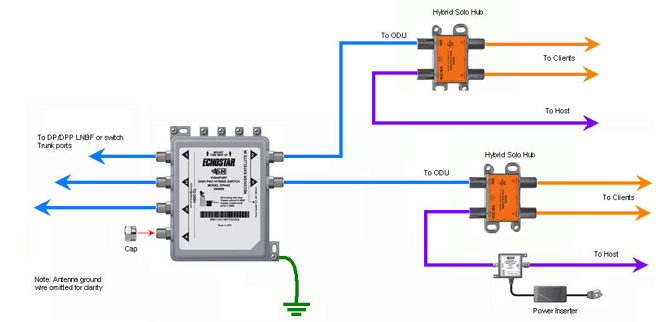

hi guys I have my brother that has a hopper 2 and he was wanting to bring it to my house while he is here for a month.
Is it possible ?
I have hopper 3 and 2 joeys using a eastern arc antenna using a dhp42.
would I still
Need a node to hook up after switch?
No, you'd need to make sure you have this setup with 2 lines coming off of the LNBF to the switch
