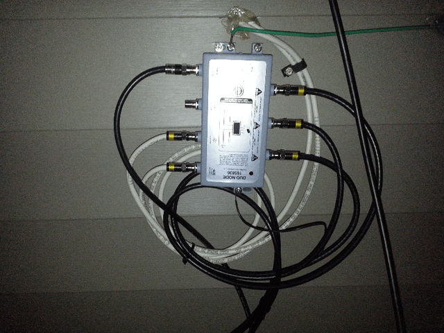

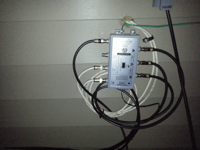

Yeah. Do you have access to your node by any chance? Are there three feeds going into the top of the node (the side with 3 ports?)
Yes 3 feeds going in...
I tried to attach a pic but it says application crashed haha...ok well there are 2 pics oops haha
Leaning toward bad node or bad cable/connection between Hopper and node. In rare cases bad receiver. Also, that unused CLIENT port needs a 75-ohm terminator.
I hope its not the receiver...0 problems w it until the new install
What is the 75 ohm terminator used for???
Will this be an easy fix by the tech???
75 ohm terminator makes sure the MoCA signal doesn't leak from the unterminated port as well as keeping outside interference out of the system.
I don't think the tech will have too many problems fixing your issues, if they're competent.
