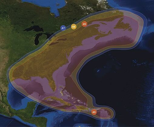

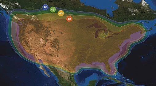

Horizons 2 has a CONUS and East Coast only beam :( (I am on the West Coast, so I hope they turn the satellite upside down ;))
Source: Jsati Horizons-2
damnit, That east coast beam is even missing me in southern Michgian. Curse you Horizons 2! :)
How quickly does the Ku signal drop off? Could a 36" or 39" dish pick it up just outside the published footprint?
I live a little bit North-West of Los Angeles, By smart searching the Echostar 8.6 satellite at 110 degrees West (Because it has Ku-band spot beams for local channels (They are encrypted) and the Circular satellites signals are very strong) with my 36" dish I get a good signal strength from the San Diego Beam (~150 Miles SE of my location) and I get a bad signal from the Palm Springs Beam (~90 Miles W of my location).
With my Channel Master 4228 UHF OTA antenna aimed towards the Palm Springs or San Diego transmitters, I can receive some channels OTA from both locations.
Also since Circular signals are much stronger than FTA Linear signals the results (Example above) shows the "best case".
EDIT - I get similar results with my 1.2 Meter dish.
Why would people on the West Coast lose ONN? Doesn't CONUS mean that it'll cover the entire U.S.?
The new satellite has a Conus beam and a East Coast Only Beam.
Since ONN is mainly broadcasted for stations in Ohio and Ohio is completely covered by the East Coast Only Beam.
We are guessing that they will use the East Coast Only Beam.
Why in the world would you make an east cost beam. To me is seems very stupid, unless you were planning to do spot beaming and reusing the frequency. But it looks like that is not happening. Its a waste of space.

"Horizons 2 will provide occasional use video and IP-based content distribution for the continental United States, the Caribbean and parts of Canada. Through a specialized capability, the satellite will support a number of comms-on-the-move applications for government customers. Its unique boomerang beam will support littoral water operations off the U.S. eastern seaboard for homeland security, ship-to-shore communications and cargo tracking."
So according to this (I hope :)) the Eastern Beam will only be used for Government customers, water operations, ship-to-shore and cargo tracking.
Not exactly. Services to Canada and the Caribbean would also have to use the East Coast beam.
