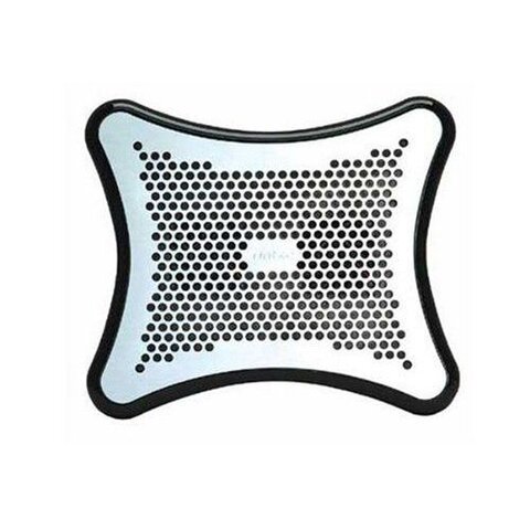

Laptop Cooler experience:
I've been using laptop coolers for years...
... on . . . actual laptops!
And I run 'em 24/7 ! - :eek:
After playing with some plastic housing wonders, I was disappointed to find their fans crapping out after about a year.
Second unit made it about one more year.
Then, I found [ame="http://www.amazon.com/Antec-Notebook-Cooler-USB-Powered/dp/B0000BVYTV"]Amazon.com: Antec USB-Powered Notebook Cooler: Electronics@@AMEPARAM@@http://ecx.images-amazon.com/images/I/51AEH-yj-JL.@@AMEPARAM@@51AEH-yj-JL[/ame] on sale at CompUSA or somewhere.
Was about $7.98 after rebate. (I'm cheap, not stupid) - :rolleyes:
The one I'm using has been on line for several years, now.
I have ignored the Antec several times when it's been on sale.
Recently (a year or two ago) they were on sale again.
I realized I'd better have a spare for my old model.... which just won't die.
So, I still have a spare (new) unit on the shelf. - :)
I'm not saying the Antec is the only nor the best. It just happens to be a pretty good one.
And when you can pick it up on sale for $10 or less, it's a winner. - :up
As to powering them, I would recommend a powered hub.
They come with a 2 amp, 5 volt, power supply (better ones have light weight switchers).
So, you just plug your four coolers or external fans into the hub, and don't worry whether any particular piece of equipment is powered or not.
