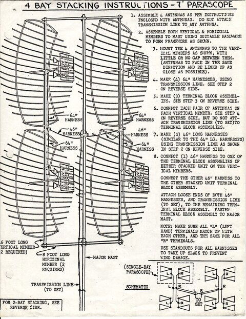

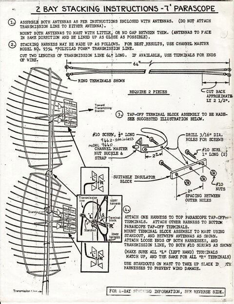

Connecting a few antennas together with 300 ohm wire dose not change the impedance if the wire is a continuous line thats why the 300 to 75 ohm transformer should be connected at either ends of the antenna wire line and not in the middle. You can even put a half twist in the line between antennas.
What is everyones opinion on the attached info. The signal of the dipoles are not 300 ohms
