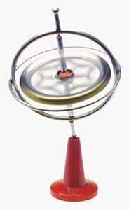

The simplest way to keep a dish aimed is with a gyroscope. A gyroscope is a tool that was invented thousands of years ago. You might have had one as a toy when you were a kid. Does this look familiar?
What's neat about a gyroscope is that the heavy spinning wheel in the middle lets it keep its position in 3D space even if other things move. You might remember getting the gyroscope spinning and then moving the base all around. The gyroscope stayed steadfastly pointed in exactly the same direction.
The gyroscope is more than a toy. If you take a gyroscope and seal it in a case, you can use gears and measuring devices to figure out where YOU are in 3D space. After all if the gyroscope isn't moving and the measuring devices show movement, then YOU must be moving. A gyroscope is the basis for a plane's altimeter and it also works with GPS satellites to make your car's nav system work.
You can also use a gyroscope to figure out where the boat is going in 3D space and then move the dish to compensate. This is the most basic form of aiming and it can be used very reliably most of the time. However all gyroscopes are "a little" imperfect. Over time if you only relied on this method you would lose signal as those little errors add up.
